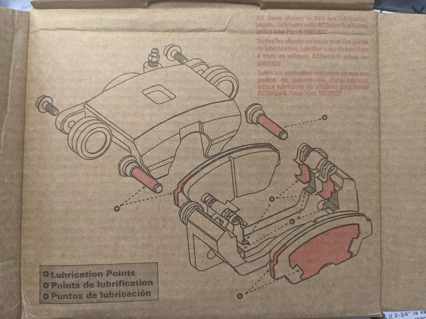

Don't forget to use pad lube in the right places
Here's a map of where to use the pad lube so you don't have squeaks.
