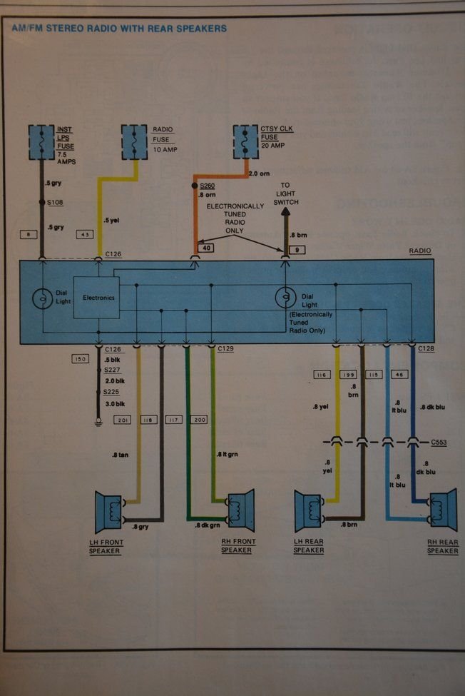

Here is a diagram for the ETR type radio you should have. Hope this helps.

Pic is for non power antenna car. Is that how yours is?
Power antenna harness would have another yellow lead below the yellow in the top connector. That bottom yellow would go to the yellow going to the console and antenna.

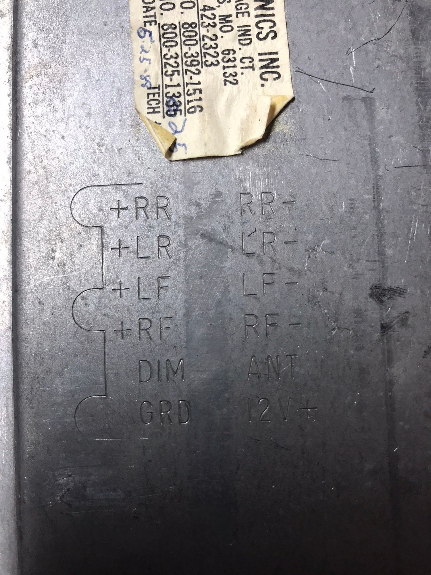

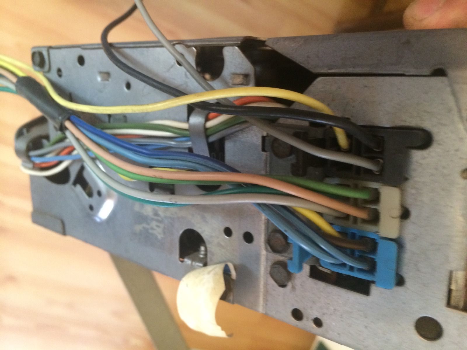

Do you have the radio out so you can see the top of the case? If so, there is a wiring diagram stamped into the top of the radio case if it is the ETR radio showing the wires as the plug into the back of the radio Here is a pic with the wires location according to the plugs in the back of the radio.

These photos are exactly what I needed. Thank guys. Ill get the connector rewired this weekend. THANK YOU all for the help!
