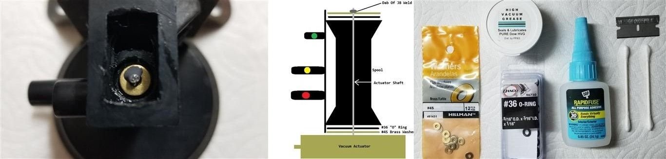

this is your vacuum relay. the round hole is the vacuum valve, this is in the headlights up position. the vacuum is connected from the center hose to the lower hose to pull the headlight up. BUT, vacuum doesn't suck. it is a low pressure area. so that the atmospheric pressure can blow on the other side. that smile shaped hole is the fresh air supply to raise the headlight. it had an air filter of sorts in that square spot 50 years ago. not really an air filter. really a bug filter. that hole is a very tempting spot for a mud wasp to make a nest. and then, even though the vacuum system is working, the air flow system is blocked. your headlight is rising slowly because there is a bug nest that it has to blow-suck atmospheric pressure through to push the diaphragm that pushes on your light. a 3/16ths drill bit spun by hand will open that passage up. also, all the big diameter lines can get bug nests in them. unhook both ends and blow them out. don't suck. blow. inhaling hunks of bug nest and dead bug is ...unpleasant. don't ask how i know. that is what the 5th amendment is for.

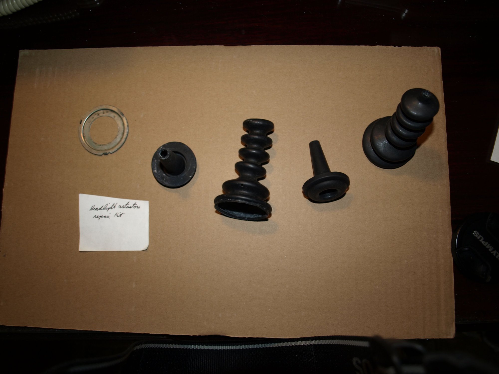

The most likely cause of slow opening is because of bad seals in the actuator.

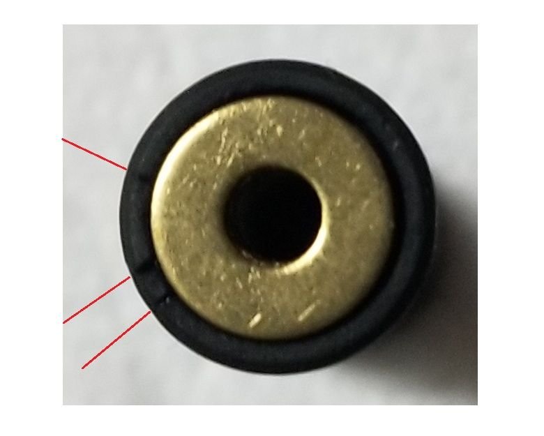

If you pull a vacuum on the signal port (top port on the relay actuator) and it holds a vacuum Sometimes you will have success rebuilding them.
I say sometimes as the Spool (dog bone) has to have NO defects.
One of my relays spool had a few cracks and was no good, the other is a good used spare.
Here is a photo of the cracks and the parts I used for a successful repair of one.
To slow headlight
