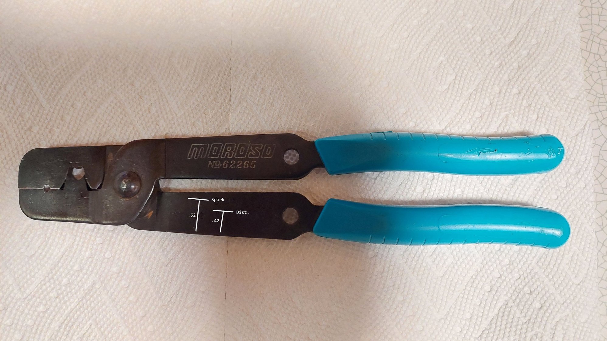

If you purchase the tool in the link only use the single crimp method.
The tool in link provides some boots and terminals but I would use a good quality boot from either Taylor or MSD.
You will see (I did the white) in the photo the length of wire you strip will be different at each end.
Spark plug end .62" or so.
Dist. end .42" or so.
Wish Moroso still made this simple 8mm wire crimper...
Probably had this tool over 30 years now, crazy how time fly's...
