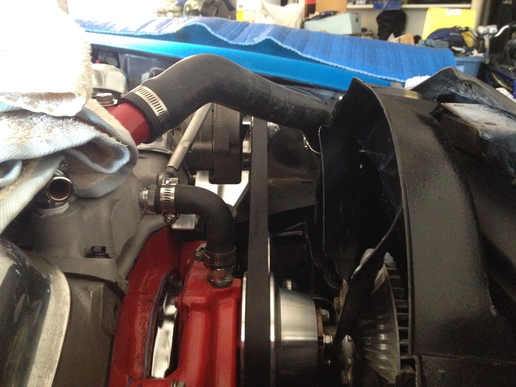

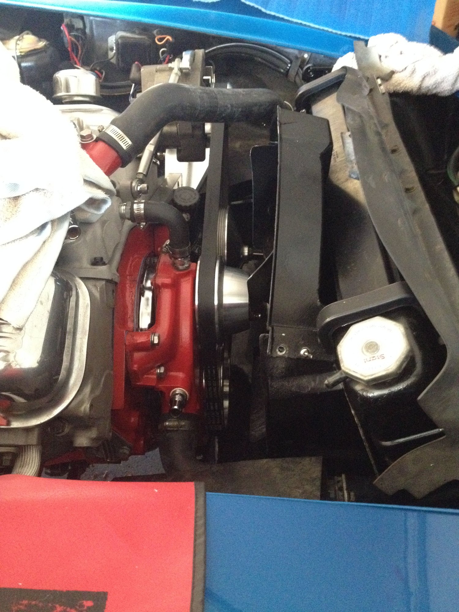

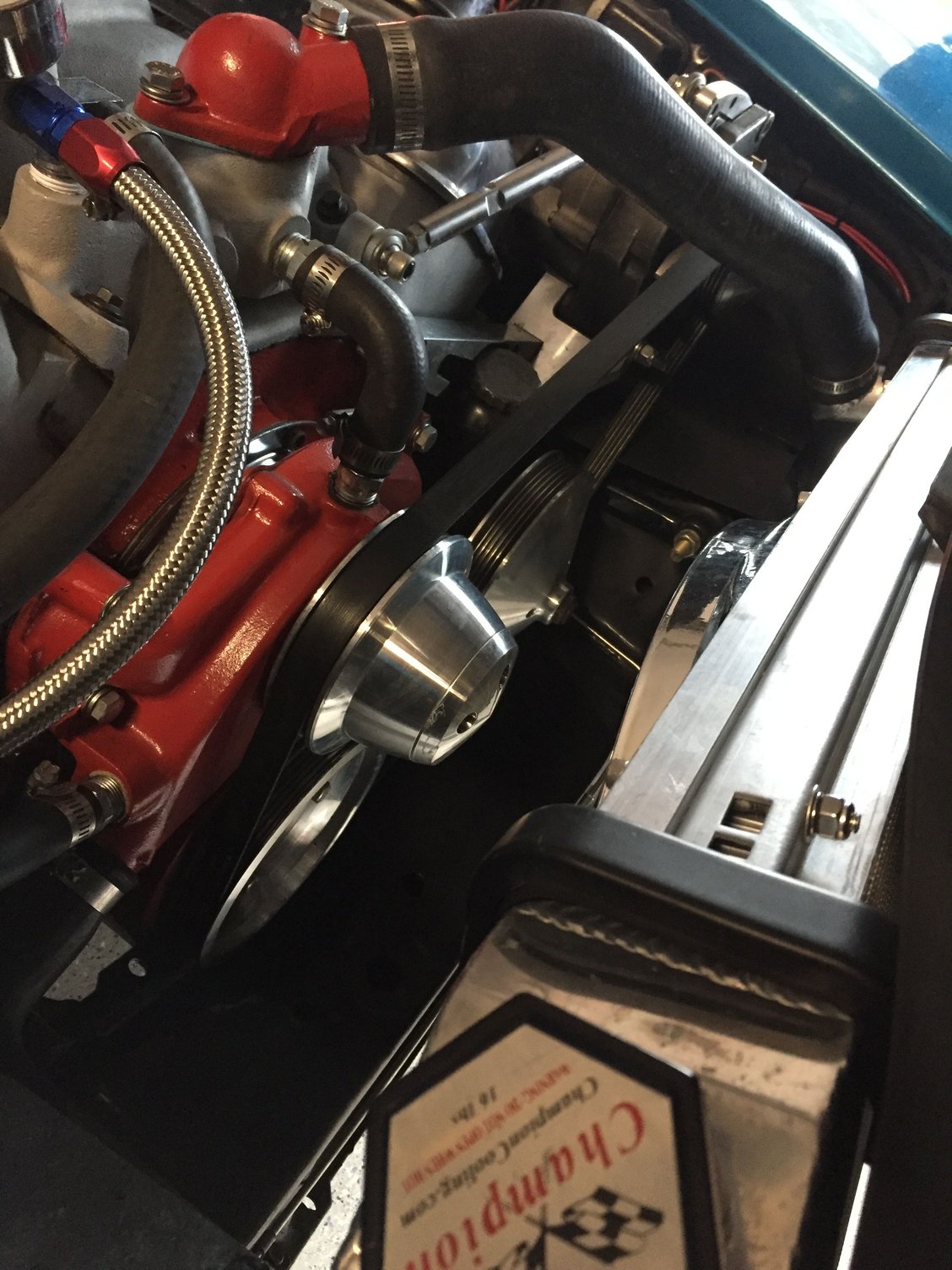

I am having a problem warping my power steering serpentine belt pulley for some reason. Background on it. When I first got my 68, I knew I was going to restomod it. One of the first things I did was to install a March Performance pulley system on my car. I was sold the kit by a local speed shop who told me it would work and fit my car. My 68 big block has the short water pump and all parts ordered bolted on and fit with no issue. I got the crank pulley, the water pump pulley, the alternator pulley and mount bracket to adjust tension and the power steering pulley, All parts were for the short water pump system. I drive the car a couple of hundred miles and notice the power steering pulley wobbles at idle. I check it and can see it moves back and forth and on the pump shaft. Thinking I must of put it on wrong, I order a new pulley online to replace the one I had. I take my time and install it and loosen the belt up a bit thinking I had it too tight.
I drive the car a couple hundred miles and check it again. Same issue with the power steering pump pulley (Part#612). I order another one and install a new power steering pump from Tuff Stuff as I switch over to hydro boost for the brakes and power steering. I take my time and carefully line up everything with my laser level system. Everything fits great and I adjust the belt to be a bit looser on my belt gauge thinking I had it too tight the previous two time. I run the car another couple hundred miles and now have warped the third pulley.
I contacted March, but have not heard from them. I am in no way flaming March as I really like the look of this kit. Looking at there website, it now shows a bracket for the power steering pump.
https://marchperformance.com/chevy/c...nt-deluxe.html
So, where did I go wrong? Any suggestions on how to correct this?
Pictures of the pulley set up.

Do you have a power steering fluid cooler? Have you checked the PS pump/reservoir temp with like a IR heat gun?

You might take the belt off, put a dial indicator on the pulley aligned somehow to the crank and check runout. Or maybe a laser pointer? I'm not sure exactly how to approach this but I would want to know that the pump axis and the other pulleys are pointing in exactly the same direction, all parallel to each other. I know your picture looks perfect at the position you've photographed it and you've replaced the pump so what's left maybe is the pump orientation.
I've used those same pulleys and had the pump pulley develop a wobble but the replacement worked out fine.
