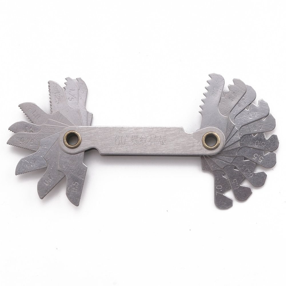

What size are the holes in a C3 caliper? What soze TAP is needed? There are two different sizes one for bleed screws and one for hard Brake line

If it were me, I'd get a thread pitch gauge and measure the bleeder screw and brake line fitting.

For reference opening brake line 3/8X 10/24 on caliper.That is the tap size Also hard line is the same on brake 3/8x10/24. .
