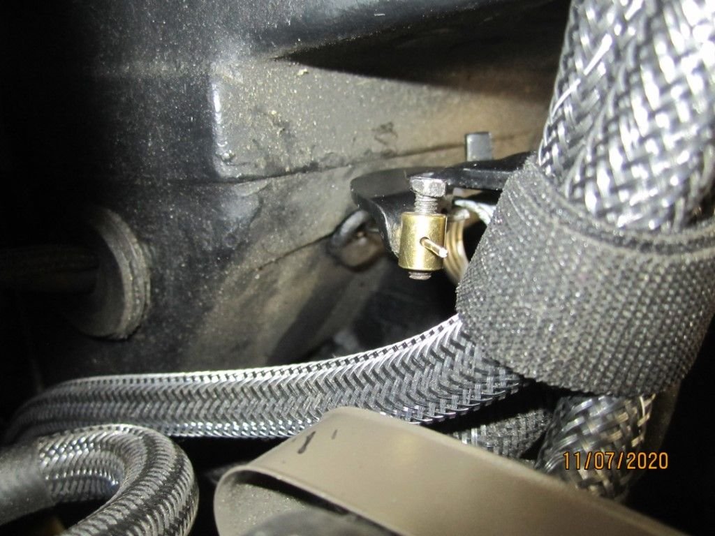

my 72 is like this
little metal dowel with a cross hole for the cable, tapped for a screw to come in and pinch the cable. I added a set screw to the opposite side to have something better for the screw to press against
(They also say to bend the wire after it's assembled but I don't want to do that...)

Ahhh, I’m a dummy. I never thought of that. I was assuming I was missing an end piece to my pull. I’ll order up some of those. Thanks!

He's. My 69 has the barrel nut. You can buy them anywhere from the reproduction corvette places.

It's know as a "wire stop" or "cable stop".
Available in most hardware stores an auto parts stores for less than a few bucks.
The holes come in different diameters so make sure you know what size wire/cable you're working with.
