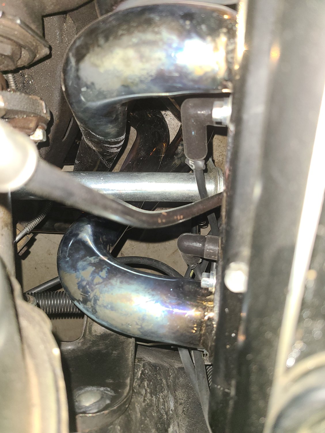

I did away with all that shielding and run wire looms that bolt to the valve cover bolt holes and sit above the sidepipe header..(I have hei now so most of the stock covers that did come in a box with the car wouldnt work). I bought a set of wires designed for such use so the look tidy enough but custom cut to legth wires would have been neater looking. I also use the fiberglass heat boots.heres a bad pic I have to show what I mean.

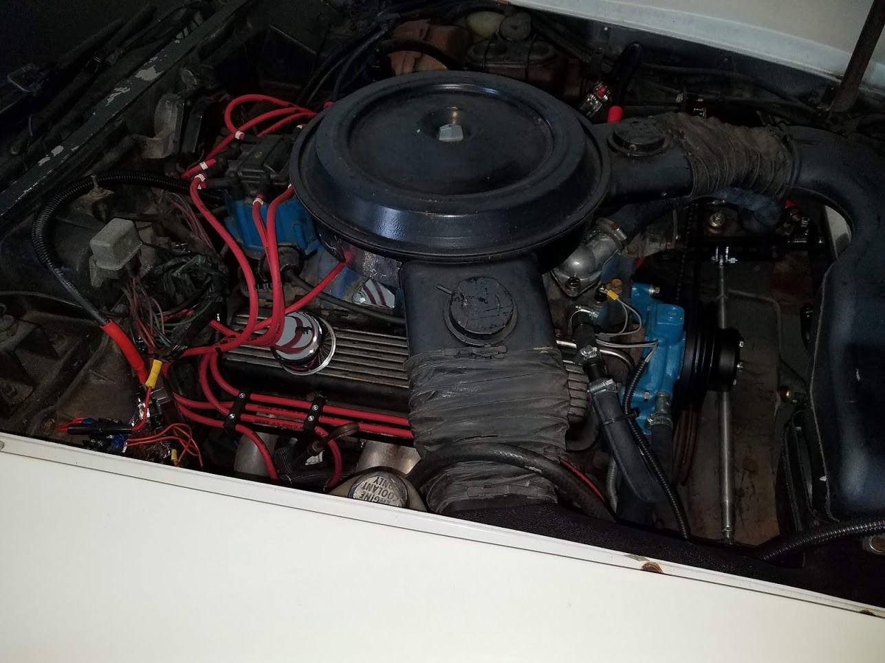

This set-up on the passenger side has been working well for years.

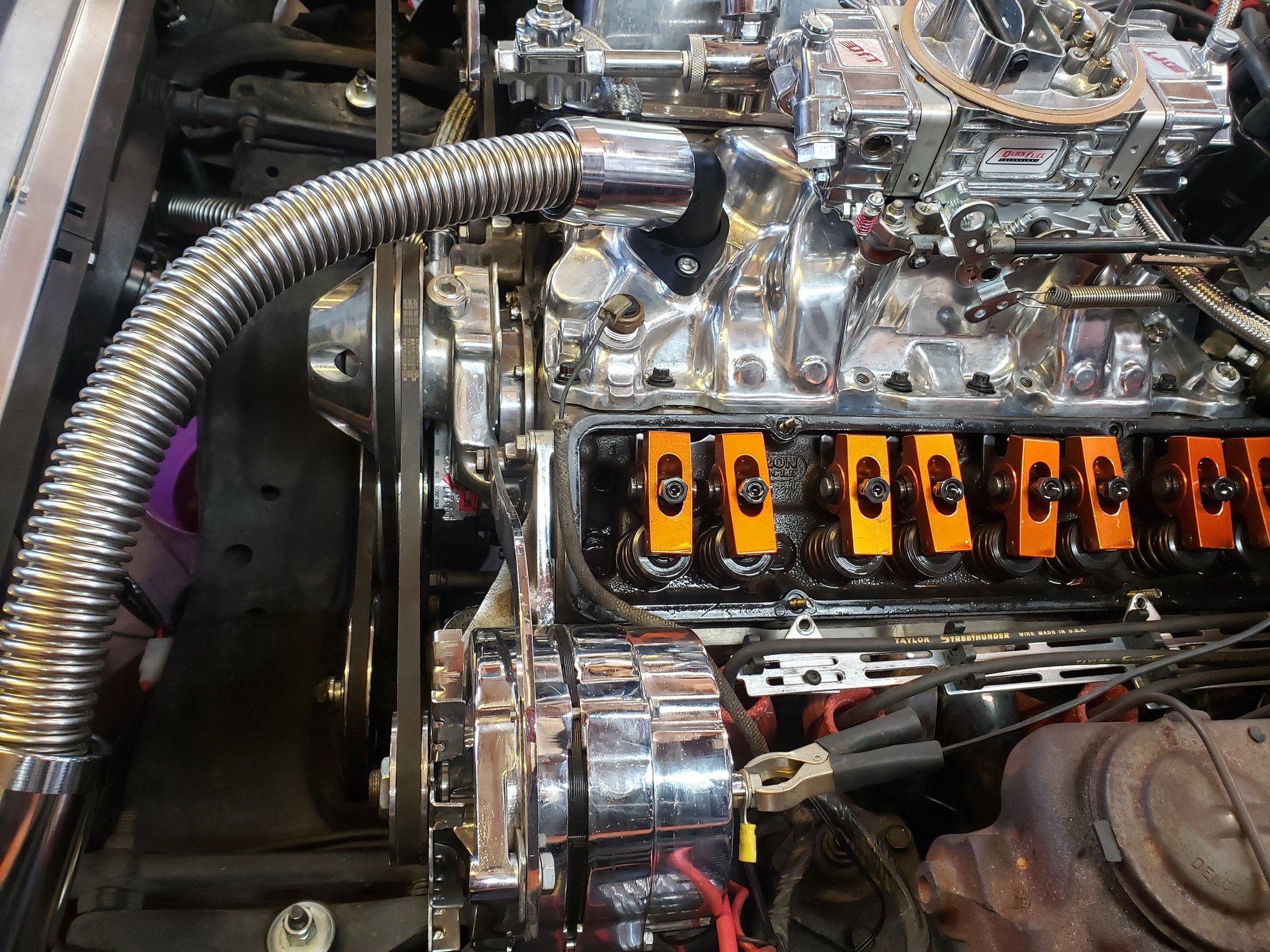

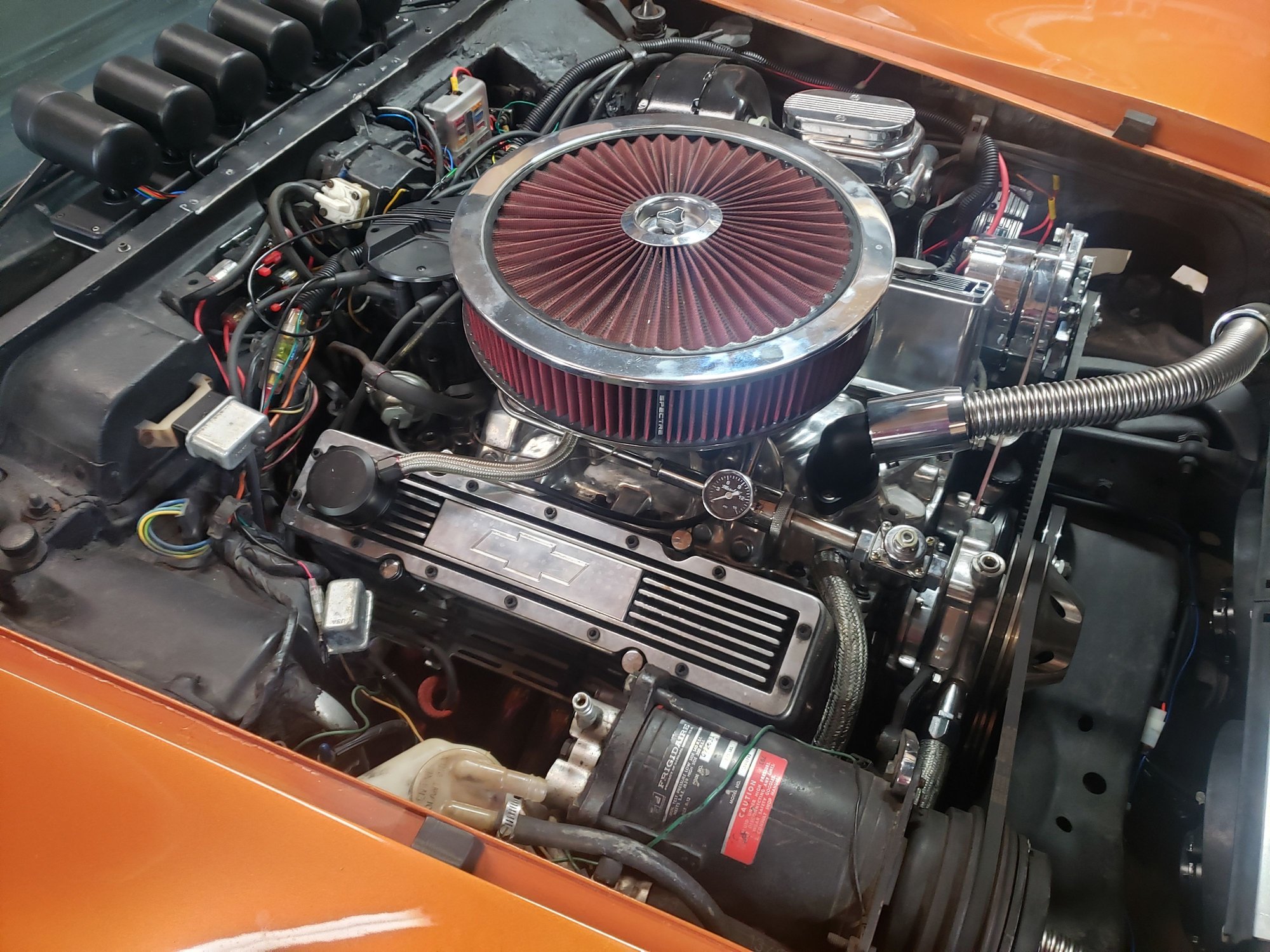

I use these wire looms from Amazon, similar to what @augiedoggy has, with some spark plug boot insulators. The looms also help shape the last bend of wire as it approaches the spark plug, helping to keep the wires away from the headers.

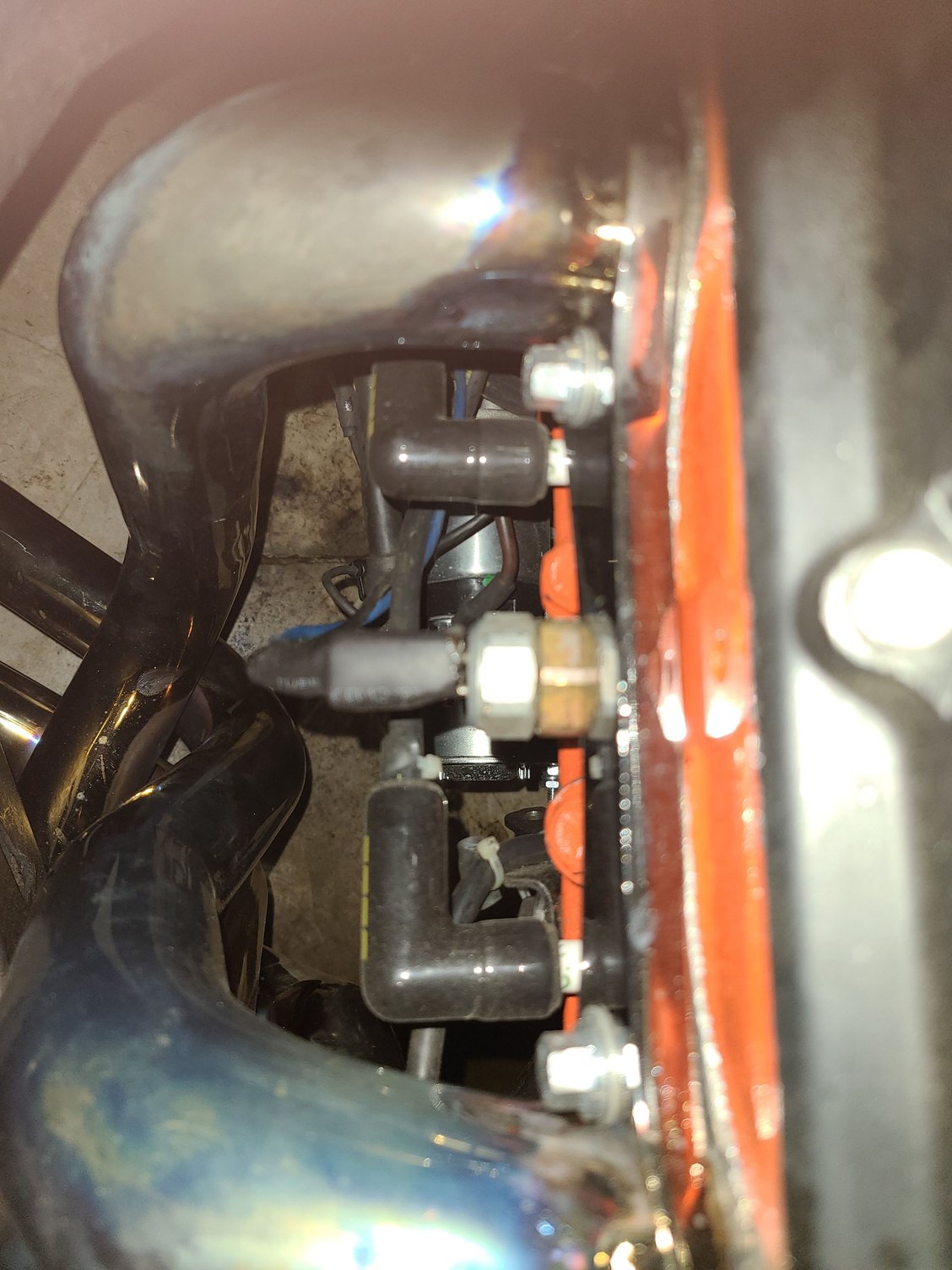

I do like the factory wire routing but it did not work with the headers. Underneath is fine. The boomerangs are radio interference shields for AM radio so they are not a requirement for me. Get under there and see what you can do. No way was the 2 and 4 wires inside the motor mount going to work here so it was a no brainer to leave them out.

You didn’t have any problem around the dip stick,or did you pull the dip stick back some to clear.my dipstick is up against my valve covers.
I don't recall bending the tube.

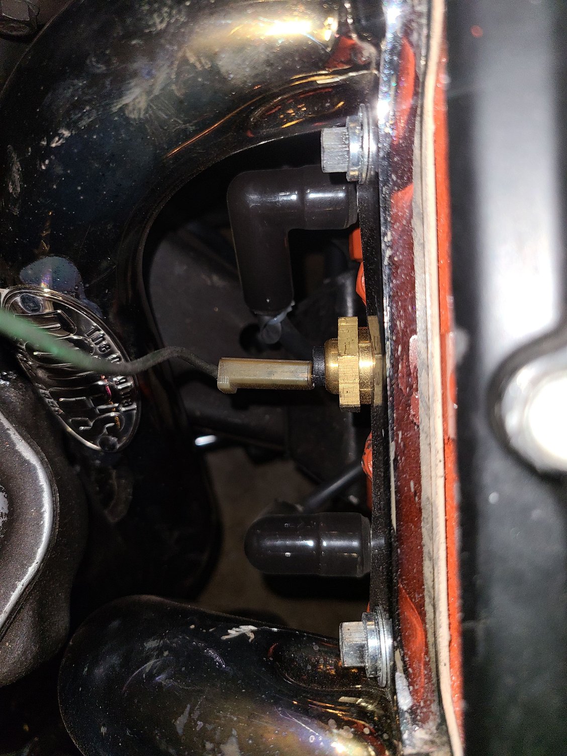

Here's a before picture on the day after I bought her. Does your tube hug the block?
