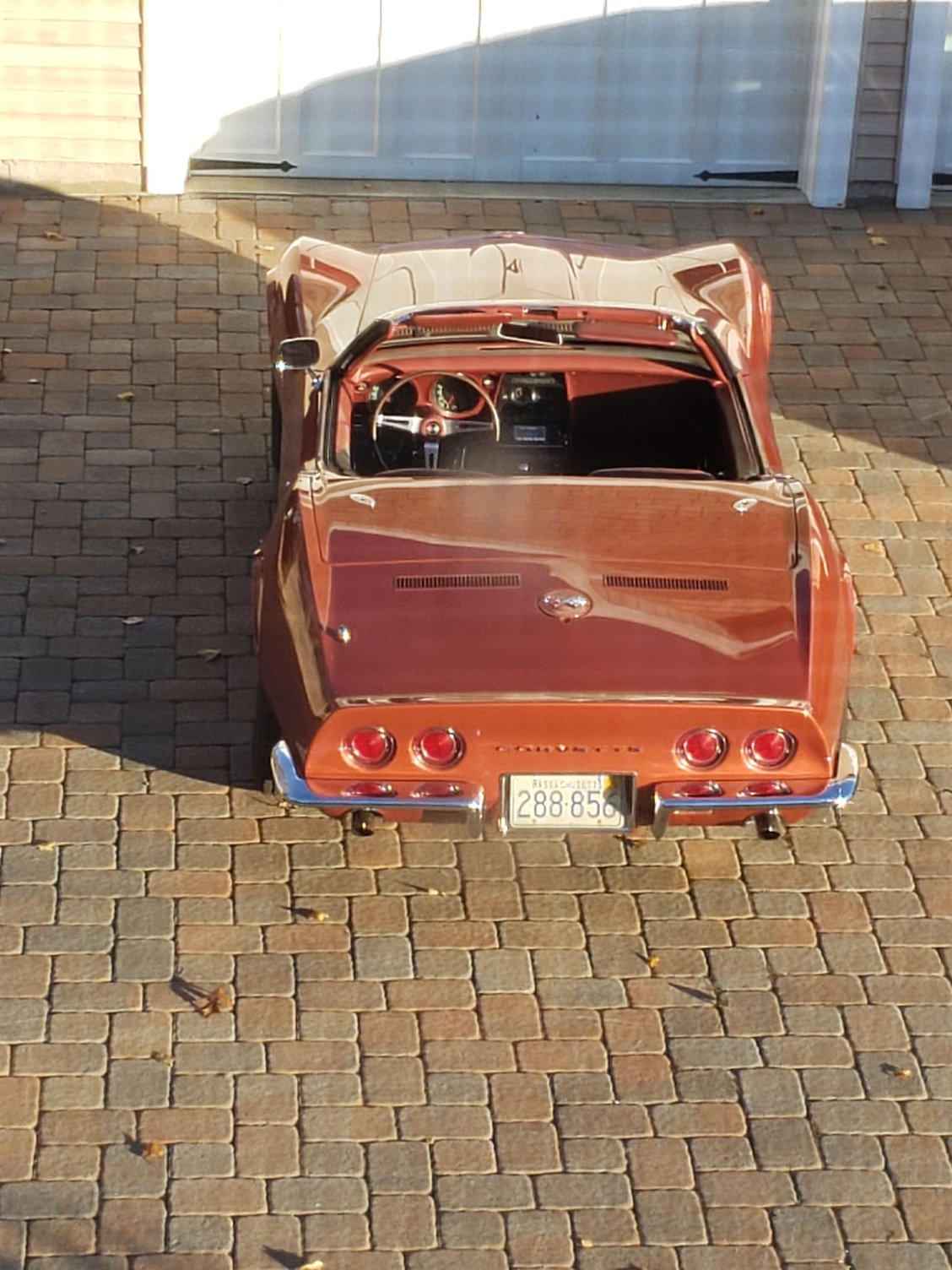

Those are from a early production car. They are not available after market. The are worth their weight in gold to someone looking for them. I have the same on my October 1967 production car. It's a 68. I had mine re-plated at a local shop. I suggest you do the same. It is pieces like these that make our cars unique. Good luck with your build. Mine took me over 8 years.

is that color early Mustang emberglow?
No, it's the original color, Corvette Bronze with Dark Orange interior. One year only so i kept it original.
