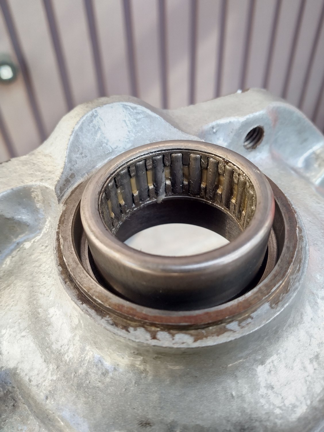

Hi everyone
What is the correct side for these bearings? (differential L & R side bearings)
Side A: "flat side with stamped part #"
Side B: 'round' side
See pics below...
Side A
Side B

I see nothing in manual, not sure it matters?
i would go flat side out as that is the side you drive flush?
i didn’t replace mine nor took a pic..
Agreed. Install it so the bearing # is visible without pulling the bearing out of the housing.

I did it that way. The result came out nice!
