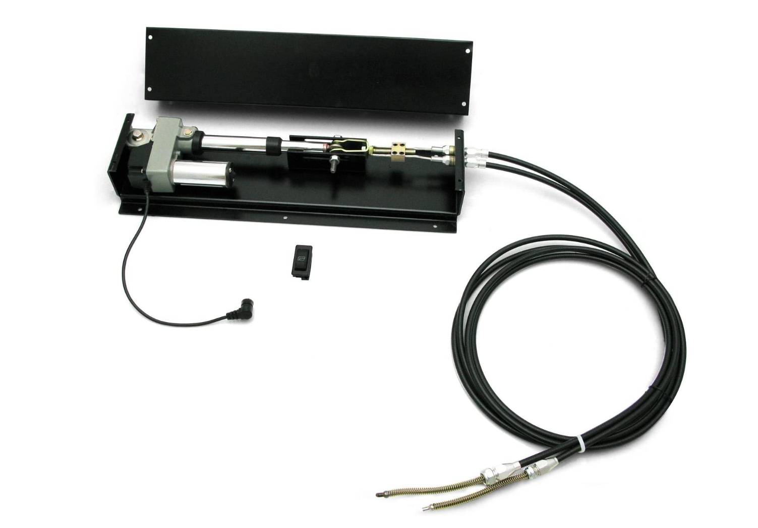

In case the link does not work this is a pic of the unit, it is only $285 on amazon. I think I might just buy it.
I drive my c3 less than I should and the parking brake is a part of that. My normal cruise is to a cafe on a steep hill. I park wheel to the curb but it is a bit concerning because the car will roll if the wheel is not touching the curb. I end up driving my 63' ranchero 2-3 times a week , 71 corvette 2-3 times every few months.
edit: I guess I will test this thing out, ordered one. Im hoping to use the stock cables that goe to the wheels and mount this right at the equalizer.
link to the item link to the item

I think I will try to mount the box somewhere out of the way while maintaining the straightest pull on cables possible.
I always thought the problem with the stock set up is with the cable routing not the actual shoe drum system. I guess by that logic something like this locar ebrake handle could fix it. That said, I have followed Richard454's example before and got good results so I just went for the electric set up. Ill look for his post on use of the E-stoppe kit which looks similar but better than what I ordered and about twice the price.

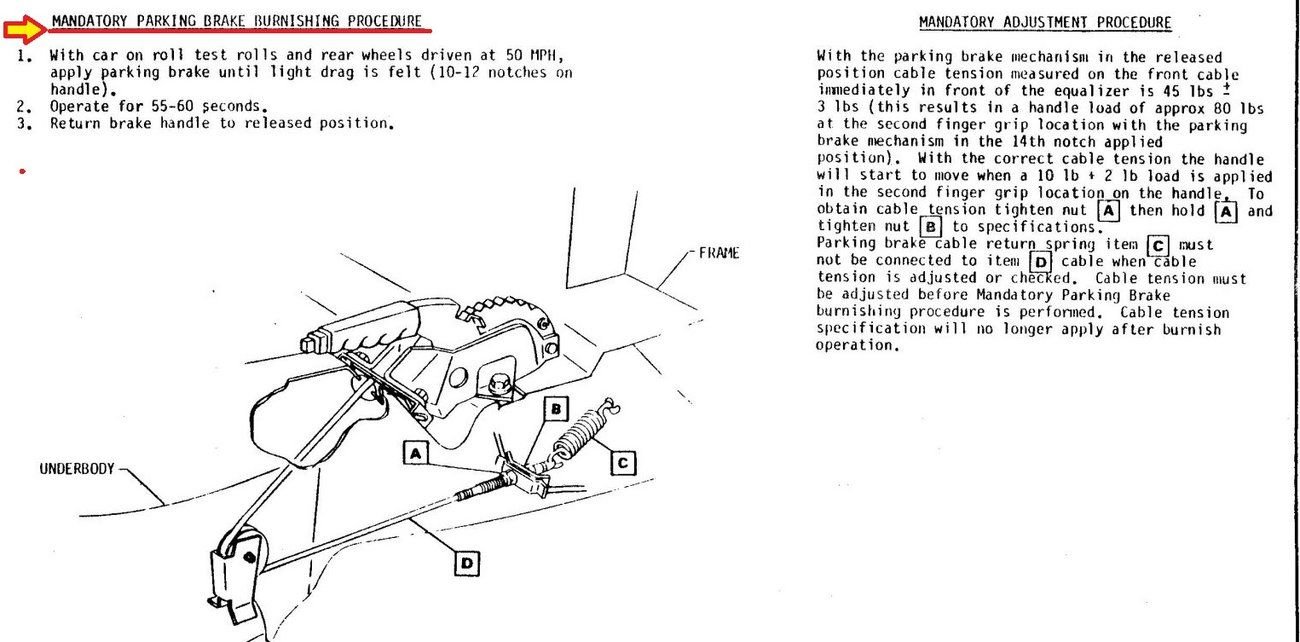

Default How to burnish the parking brake
To Parking brake upgrade
