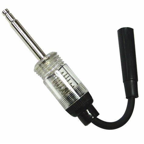

Go to any FLAPS and buy one of these and see if you are getting spark at the plug.
Lisle Spark Tester

Old Jun 5, 2022 | 09:20 AM
HeadsU.P.'s Avatar
HeadsU.P.
Joined: Aug 2017
Posts: 8,336
Likes: 2,809
From: Cool Northern Michigan
Lisle Spark Tester
That tool should be carried in every C3, every classic car, every hot rod of old.
Put one of these in the rear compartment. Not in your shop, not laying in the garage, not in the house, but in the car.
Instantly know if you have "juice" or not.
Can also be found on Ebay $5- $7.

Really like that tester but.
Keep in mind it will tell you if the cap, rotor, modge, coil and plug wire are working.
But it will NOT tell you if the plug is actually firing.
Another great tool that does tell you if a cylinder is firing would be a Thermo-Temp-Gun.
