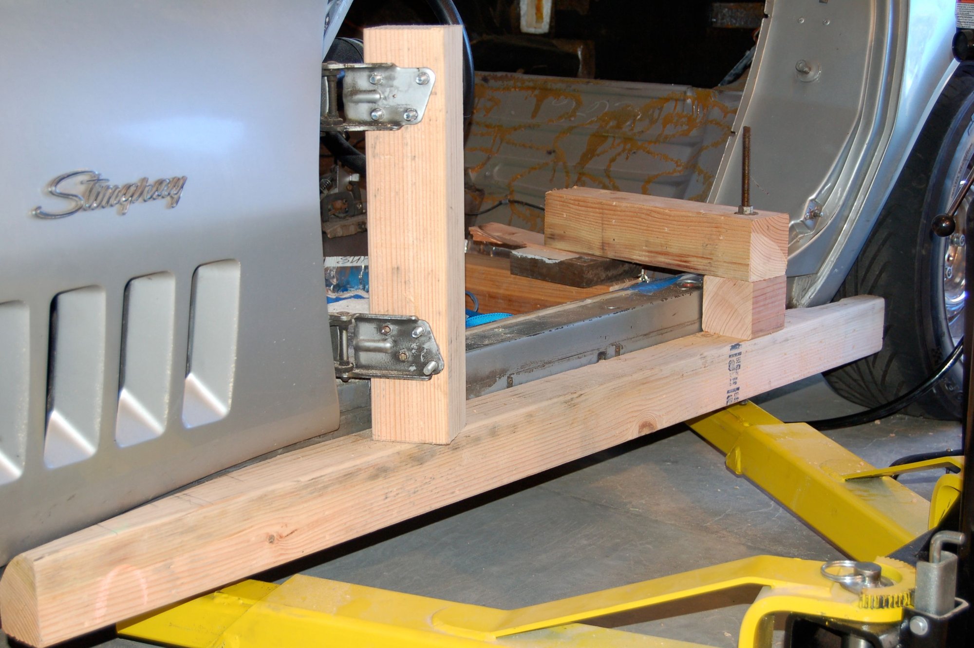

Agreed as well but how do you plan to rig your hoist? A coupe will have far less issues than a roadster. I used my lift and a couple of 4x4's attached to the rockers. Minimal stress as best I could contrive.
That said, I wouldn't install the windshield until after the body was reattached.
I purchased one of the body lift kits that lift it with straps that attach to the rocker channels.
I do like your idea of using 4x4’s under the rockers.
That would keep the straps off the door panels
The windshield would go in after the body is reattached and after paint.
Thanks!

Likes: 1,588
I probably still have this rig somewhere if you want to borrow.

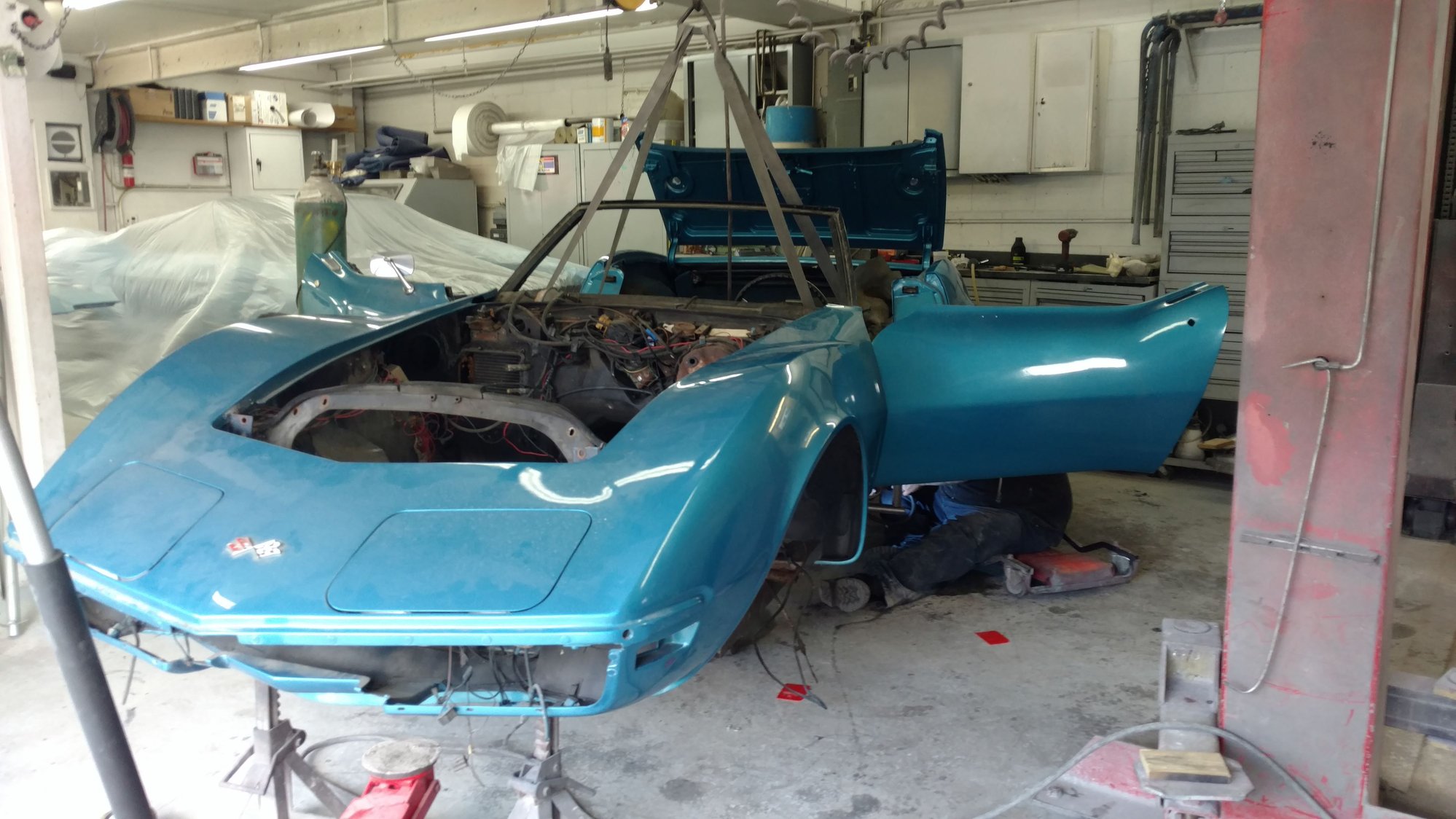

Originally Posted by 67:72
Agreed. Minimal at best because the glass is surrounded by rubber gasket and caulking. It's too flexible to add much structure.
No rubber gasket on C-3. C-2 is rubber set. C-3 windshield is urethaned to the pinchweld. Not preaching, just saying. Just set a ‘69 roadster this week. Not much for the windshield frame to be structure for, it’s just hanging in the breeze.
That does look like a nice setup, but I should be good with the kit I bought.
