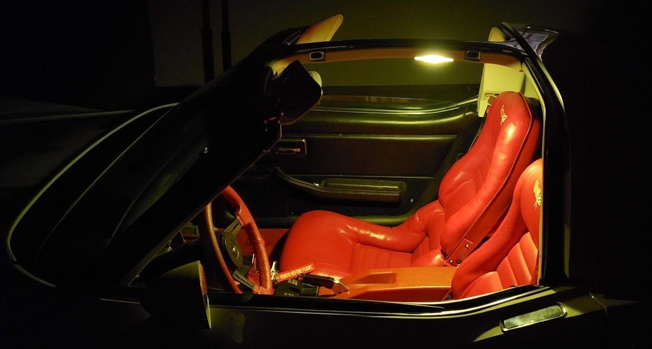

What year?
Swapping the overhead and kickpanel lights to warm LEDs was one of the single biggest positive changes I've done to my car, for the money.
SuperBrightLEDs.com has the cross-reference list.
