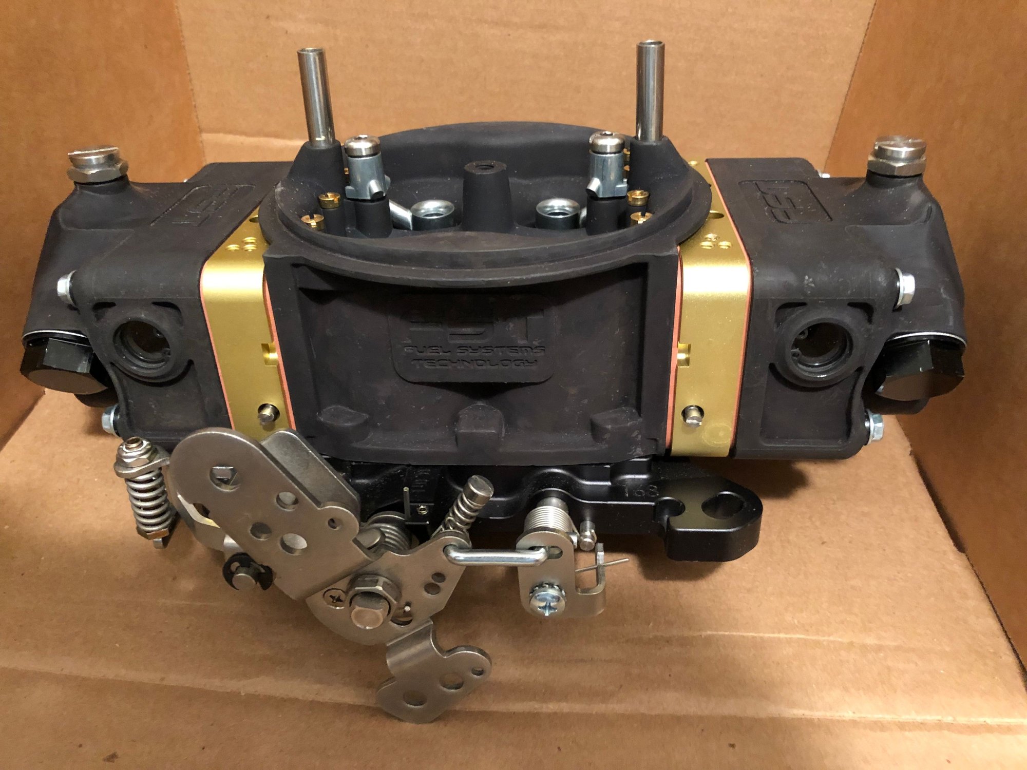

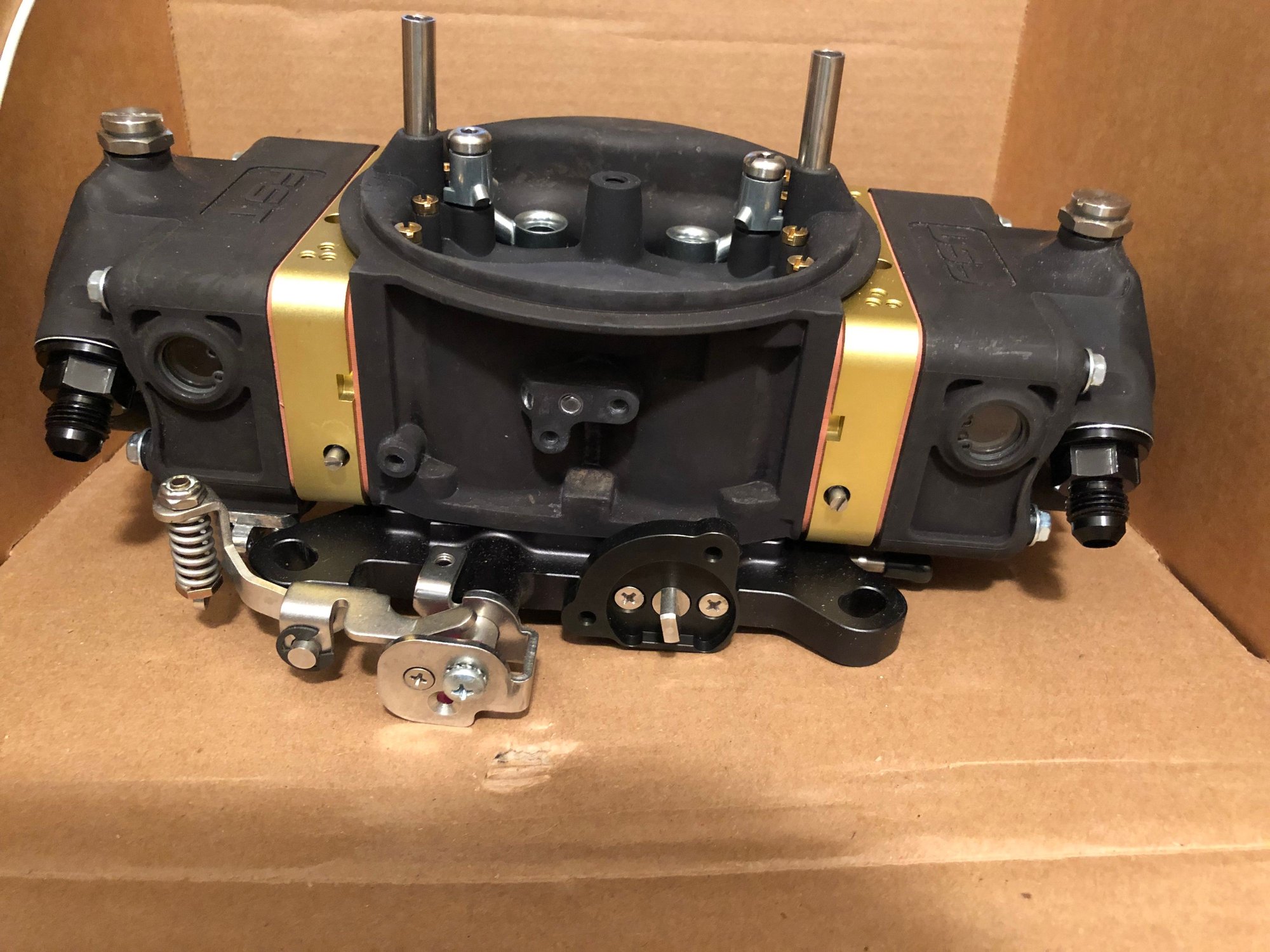

We’ll, after waiting a little over three months I finally received my FST carburetor. Obviously, it’s not on the engine so the only complaint thus far (besides the wait time) is that the finish looks faded.
However, the carb does have some really nice features. Such as:
Throttle position sensor,
Quick change jets, no need to remove the bowls,
Two circuit billet aluminum metering blocks; and,
Down leg boosters.

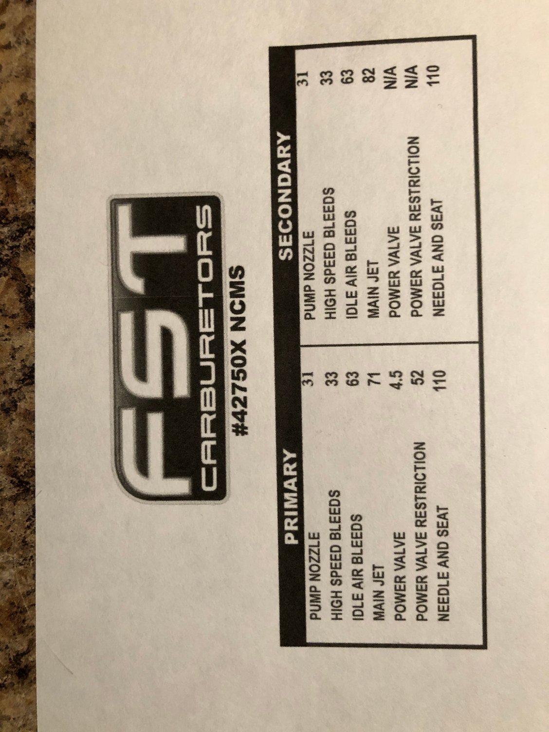

If anyone is curious, this is the RT-X 750 cfm version. Technically, it should have come with red billet metering blocks, but they were not in stock and gave me the gold ones instead.

The finish does look dull. Do you plan on pulling it apart to make sure its all good before using it?

I wasn’t planning on pulling it a part. FST tested it before they shipped it. And I have no doubt it was tested as it reeked of gas when I took it out of the box. These carbs are generally rated pretty good, but yes you can always get a bad one.
My engine won’t be ready until October, so more waiting until I can give a better review.

That looks a lot like the AED carburetors. I had an AED "Holley" 850 Double Pumper on my 427 that was "custom built for my engine" and flowed over 1100 CFM. They spent some time and wanted to know all the details about the engine and then built the carburetor to work with my engine. The owner of AED told me that if I wasn't happy with the way it was set up that he bring my Corvette down to their dyno and they would set it up on that. It was so good out of the box that I didn't have to change a jet or anything. They had it set up "perfectly" from the get go. I understood that they got rid of their dyno a while back now during the Covid mess. The owner was a really nice guy and loved Corvettes. They used some liquid to set it up that had the same qualities as gasoline so they could set it up on some machine that had air and liquid both flowing through it.
The only thing it doesn't have is a choke and I didn't like starting my new expensive engine by revving it when cold. You might be able to put the choke parts on the side of it that allow it to idle faster when cold and kick down when warmed up. That made cold starting much easier on the engine. It didn't use the choke tower or parts that are not on the carburetor. It did use the coil that warmed up using 12 Vdc and let the car idle at a higher speed when cold and then as it warmed up it reduced the idle. It is not hard to put those parts on and set it up for cooler weather starting.

I have not had a carb with a choke in 30 years. I can reach through the window and turn the key and my motor fires up. I did notice the 71 pri and 82 sec. and that seems way out of bounds when the difference is generally sub 8 sizes. As you see in this picture I have 70 - 74 jets with lots of air bleed and bench flow testing
Are the throttle blades drilled on the primary?
All you have to do is spray it down with tire shine to bring the rich black back.
You need to get a duel fuel log feed with an inline small micron filter and run a 4 hole thermal 4 hole wood 1/2 inch spacer.

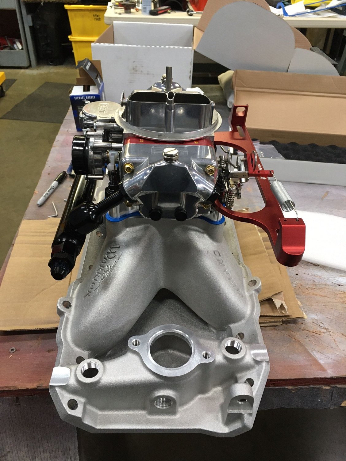

Nice Demon carb! I still have one on the shelf from my old ZZ4.

I’m planning to put an Air Fuel Ratio meter in the exhaust to tune it when it’s all done.
