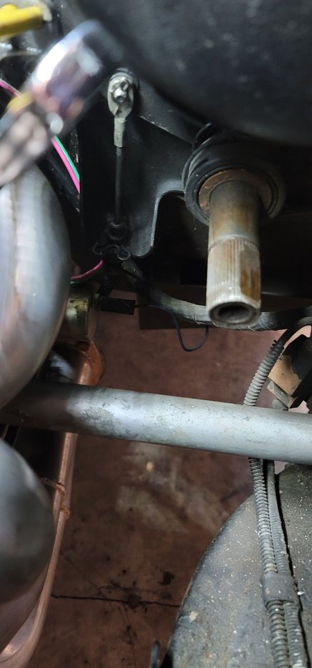

Here is the pict. of the steering column from the front of the engine back to the firewall.

Did you remove a Borgeson box to install the Steeroids? I couldn't get mine to collapse until I took the column out of the car. I was able to booger up the splines trying, though. Below is a photo at about the correct Borgeson length, while I was fixing the splines. I overshot, and pulled it back out a bit, probably with Vise-Grips and a small hammer, but possibly by putting the old rag joint back on as they suggest.
It's a 20 minute job to pull the column, after you've done it once or twice. No reason not to do it. I wish I had from the start. Replace the lower column bushing while you are in there, it's almost certainly toast, if you didn't just replace it.

That is way too short. Here is a picture of mine.
