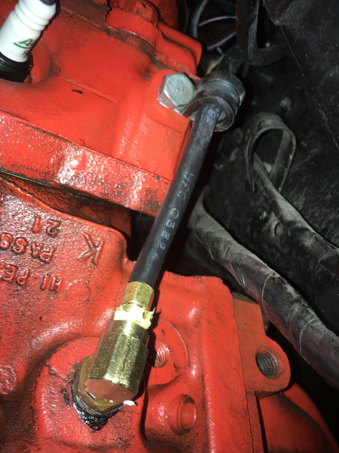

The prior owner had disconnected and capped off the sender at the block because the connection at the gauge had leaked oil all over the radio and carpet. The carpet was replaced and he denied any knowledge about the gauge and the radio not working.
Not sure exactly why but on my list of to dos I’ve been putting this one off.
He had a copper line hooked to the gauge and hanging in the engine bay but the factory line is plastic. Ron at Corvette Paramedics says that’s what they install and never had a problem, he should know right ?

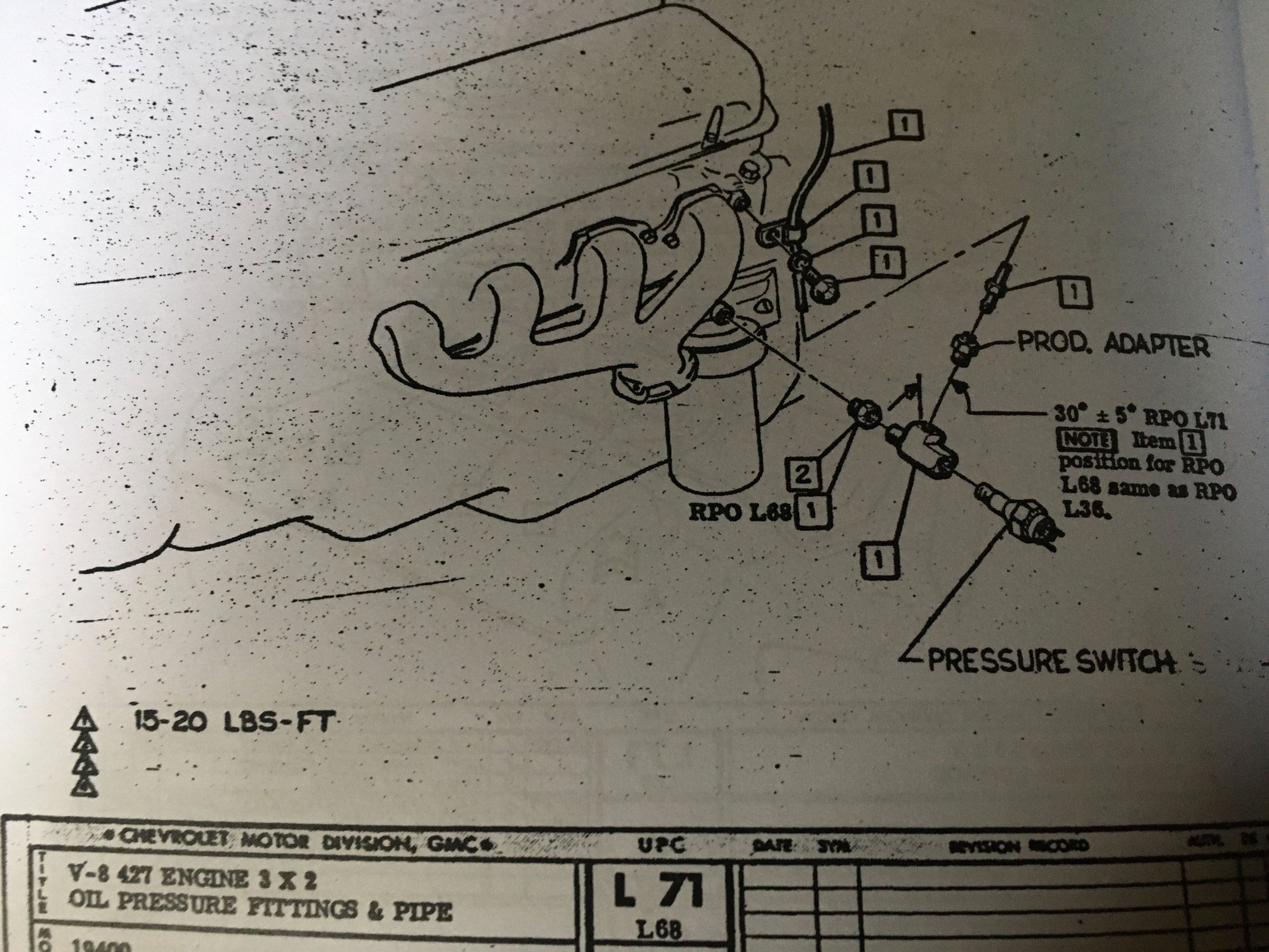

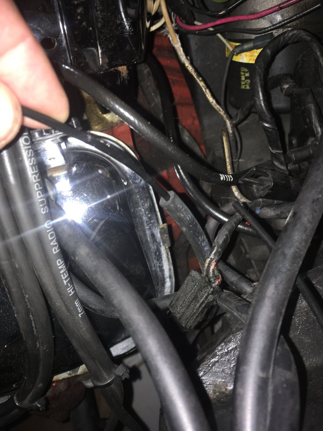

So that’s what I put in. I installed an elbow at the block to aim the line straight up and bolted a ring to the block to support/guide it as shown in my AIM manual. I used Teflon tape on the pipe threads and assembled the compression fitting wet with marvel mystery oil to prevent galling. A length of washer hose was slipped over the line to protect it from chaffing or heat.
The AIM manual shows the line taped to the tach cable and entering thru the firewall together. I’ve got a new grommet to install first. Hope this all works as planned

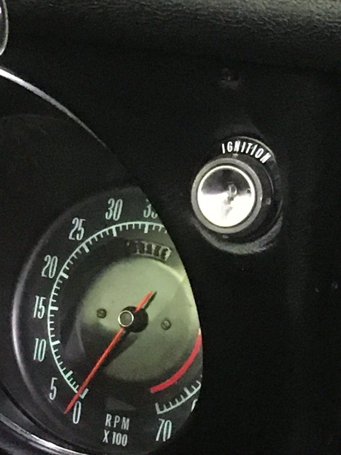

Ive got the proper ignition switch in place, all new vent and climate cables are in and working perfectly. New speakers have been installed front and back and the radio though not fully installed was tested and sounds great.
Hopefully all new center gauges will be installed tomorrow. Keeping my fingers crossed it goes well. Still have some parts to replace like the lower shifter boot which was another thing ignored when it had its “total restoration” done. I make it all right though.

That looks like you did a real nice job there Lt. Mike! I replaced mine many years ago but chose to use the SS Braided line in place of the nylon tube. The nylon gets brittle with age and since I wanted to do the job once I went with the -3AN SS Braided line and even put a loop in it to allow movement of the engine without stressing any of the parts.
I have a copper line kit that I bought before finding the -3AN SS Braided line kit. I do believe that the Nylon is better than the copper line as I have seen to many copper lines break on Boats. You did a fine job protecting the parts and I doubt you will have to mess with it for a long time! I like the way you secured it with the line clamps, it looks very professional!

the plastic line was for small blocks, the copper line was for big blocks. THe plastic lines fail really easily and the copper is definitely more reliable as its a hardline. The best is the braided steel lines but for originality the copper is what ou want

'68 Was a full plastic line block to gauge and in '69 they went to a 10" length of copper to the top the head then joining plastic tubing to the gauge.
Every parts resource and manual I've found reflects this. I'm concerned with abrasion which is why I used the washer hose to protect the line at the block and will cover the rest of the line with a braided covering. While it will do nothing for burst strength it will prevent abrasion from vibration.
The line that failed previously in my car was copper and had failed where it connected to the gauge. Copper isn't fool proof. Don't put too much faith in braided line either. It's got strength against bursting but inside its just another rubber hose that will eventually harden and crack. Like anything else these things don't last forever and require periodic inspection.

Not really as simple as that: up to '68 (I believe) the line was steel from the block to the gauge. Then in '68 it changed to all nylon for all engines... however in '69 the small-blocks retained the all-nylon but for big blocks a short piece of copper at the block was used that then connected to nylon to the gauge. If I had a '68 big block, I'd follow the '69 modification; those GM engineers and warranty guys wouldn't make changes they didn't have to.

My 1968 C3 with it's 427 was made in October of 1967 and had NYLON tubing from the engine to the oil pressure gauge. When I disconnected it from the gauge the first time it was really "on there" and had a lot of wear and tear. Early on I went ahead and put a small vacuum hose over the nylon tubing to protect it in the tight turns and anyplace it could rub under the dashboard. I don't think that my 427 ever had a copper line from the factory. Copper lines can break more easily than the Nylon tubing and I personally would trust it even less. Copper doesn't do well with the constant vibration and or shaking. Even steel lines can break if they are allowed to shake while being used. The better secured a line is the less chance they will break from vibration.
The restoration shop I use also suggested that I replace the Nylon tubing with new Nylon tubing when they re-installed the 427 for me.
I understand that SS Braided lines are still rubber under the SS sheath and I will replace it after 20-25 years but I will still replace it with another SS Braided line as they are durable, abrasion resistant and virtually burst proof.
