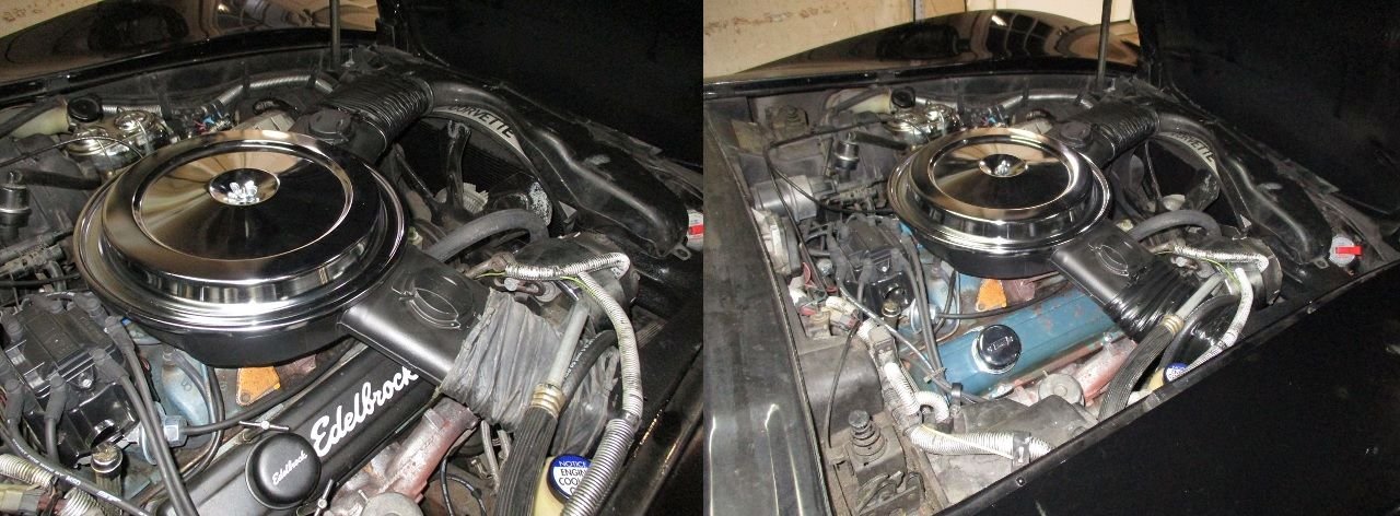

If you don't need taller valve covers to, ahem, cover valves/rockers, you can solve this problem by going back to the stock valve covers.
My 79 had this problem, and these stupid valve covers, which I got rid of in favor of a set of GM Corporate Blue valve covers, with patina. Now to get rid of the rest of the chrome.

Have you looked under the valvs covers? Generally speaking people have to put on taller valve covers because after market roller rocker arms are physically bigger.
Alternators have a red line rpm. Let's just say 17000 rpm.🙂 just for example that you have a 8 inch crankshaft pulley and 2.6 inch alternator pulley
8 ÷ 2.6 = 3.0769. Rounds to 3.08 × 5300 engine rpm = 16,324
I installed a smaller diameter multi groove March aluminum pulley and bigger alternator pulley
