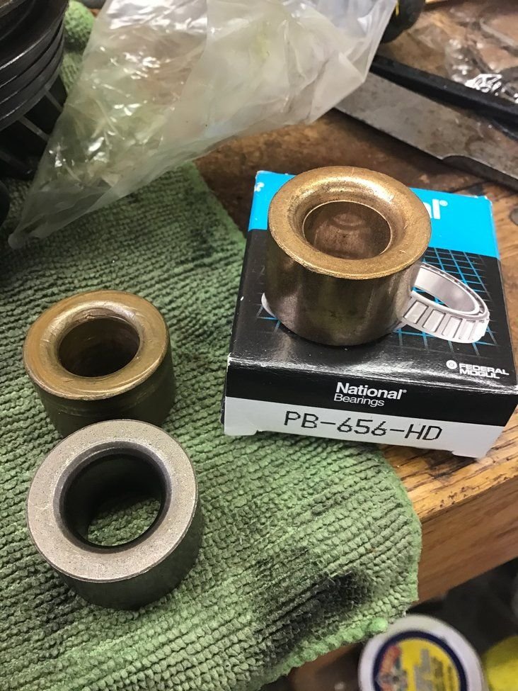

Mcleod here..note buy a real bushing though non magnetic..
i read the same lars article.
solvent clean until rag is clean on flywheel and pressure plate..
5000 problem free miles since.
https://www.corvetteforum.com/forums...se-79-l82.html

Thanks interpon. I've seen a few comments about non-magnetic pilot bushings, including yours. Why is it best to use a non-mag pilot instead of magnetic? Seems odd that most clutch manufacturers include a magnetic bushing....
It's a cheaper bushing so more profit.

bingo..
still get usa made cheap local auto places…national brand.
original, silver came with clutch magnetic…new

The bushings used to all be sintered bronze "oilite" material, non-magnetic. Those type bushings are much more difficult to find now. Some people claim the current bronze ones you can get now are the same as what we used to get but I remember differently. Whatever.
The more common today (magnetic) ones can be hard on the input shaft.
