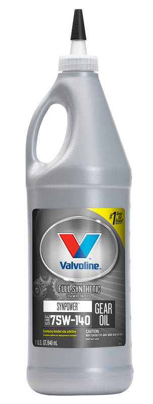

for higher numeric ratios which get hotter and lapping cars. Plus posi lube. I usually put in one and run it for awhile and if you still get popping and a second one.
