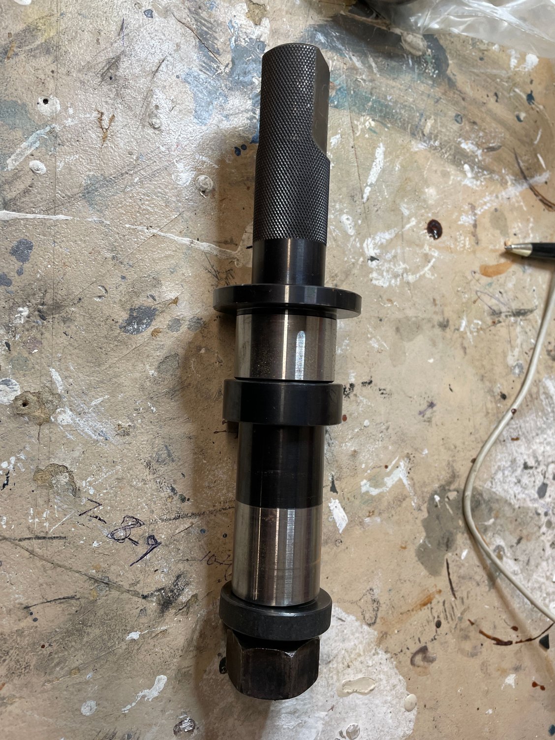

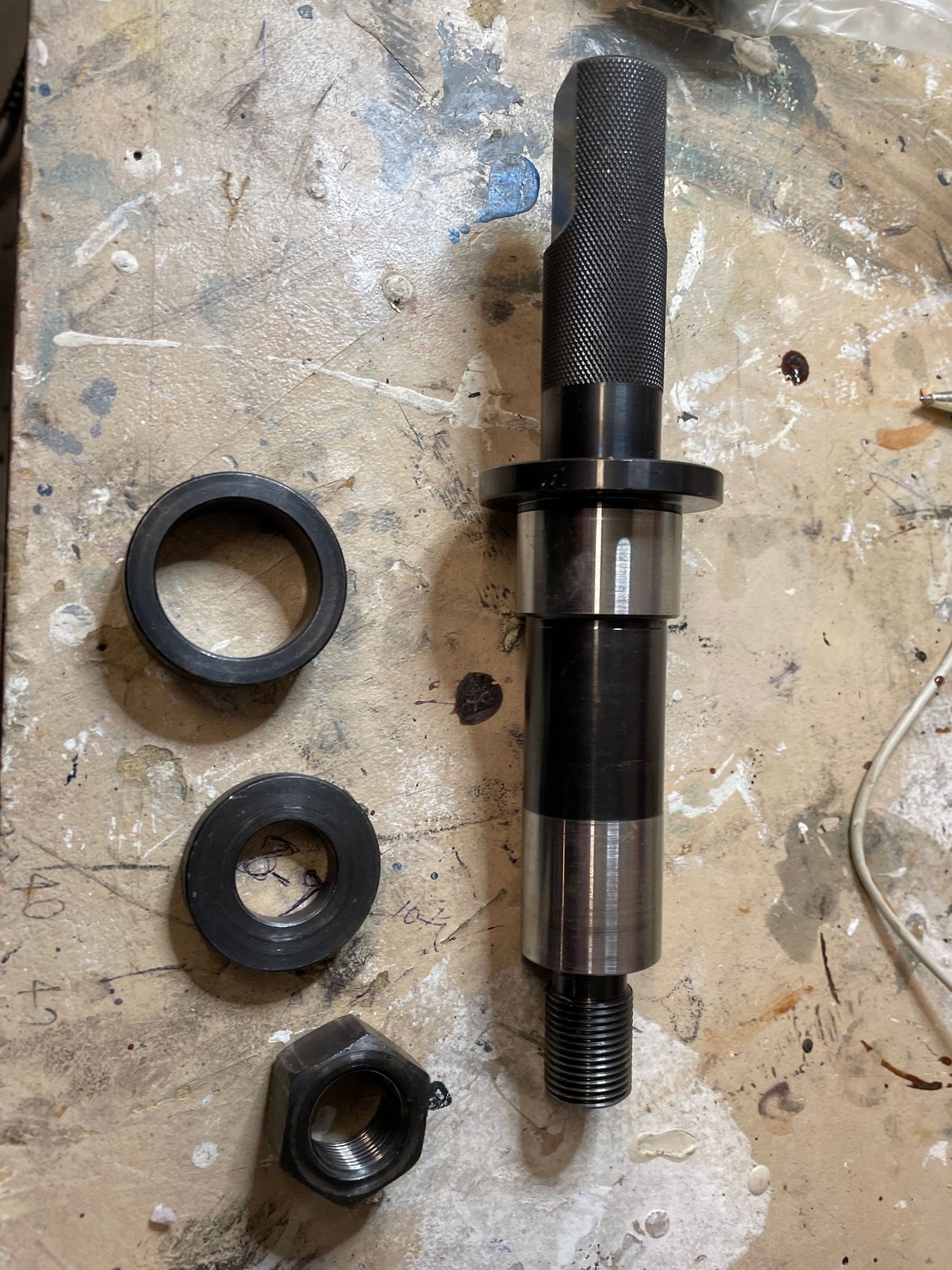

Alan I have the bearing setup tool if you want to borrow it ?

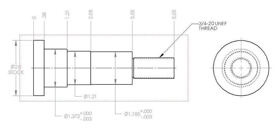

thanks for the kind offer,
i have a drawing (hope it's correctly drawn) of the setup tool and can get the apprentice at work to turn it up.
also need to make a front bush clamping staking tool and a Rear Spindle Installation Tool.
it's good being a machinist, give me a drawing or sketch with dimensions and i'll make it work

I made my own staking tool for the front bush a few years back. now everyone borrows it. Easy. Bearing set up tool. super easy. Not even a little bit concerned for you River.

put a knurled handle on it with a 7/8 hex
