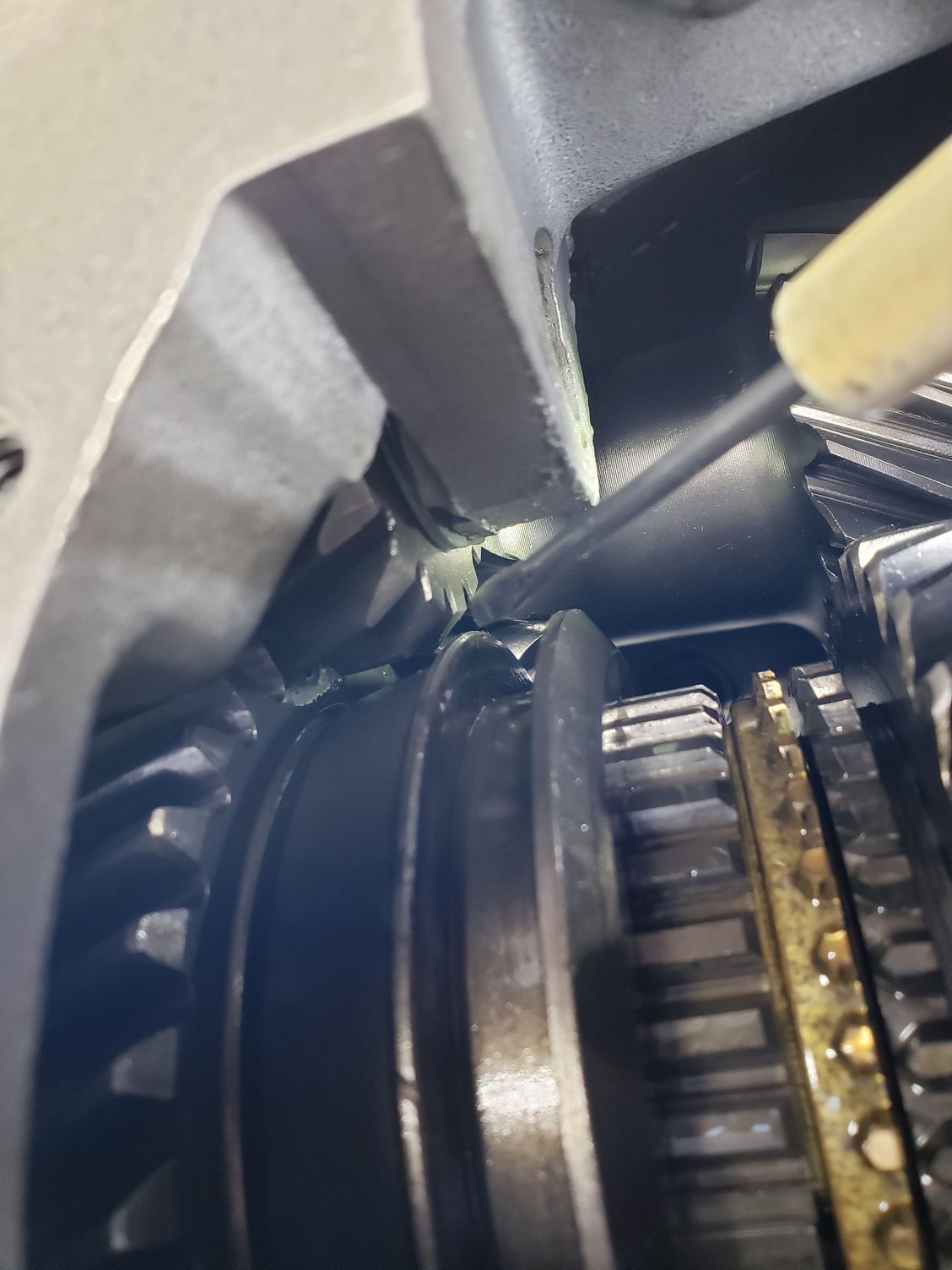

I did this repair recently. Removed the reverse idler, beveled the edge, reassembled, problem solved.
Quick way to check it is to start off in first gear and, while under acceleration, not decel, pull back on the shifter and see if the noise stops or at least minimizes. If it does, it's the idler. Not too difficult to repair once the transmission is out.
This is not an uncommon problem with these Muncies. New gears now come with the beveled egde.

The tolerance is very minimal between the idler and the shift collar so they tend to brush against each other in first gear on some transmissions. It doesn't really cause a problem, just an annoying noise. An over-looked design issue originally. I believe all the replacements are beveled now. The idler does not need to be machined to correct this problem, as it is not a high pressure/impact point, you can simply bevel the edge of the idler on a bench grinder. Then file the edges so there are no burrs and you're good to go. A five minute fix once the idler is in your hand.
