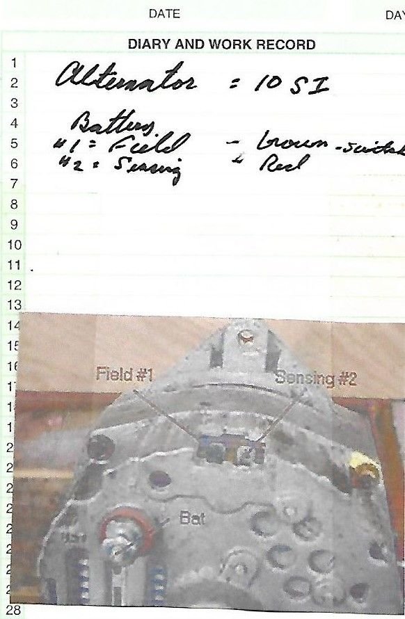

Default Does this help?
Originally Posted by Motorvation
How did you determine the leads were backwards?
Don’t mean to steal thread, but inquiring minds want to know. Thanks! Steve O.

Thanks augiedoggie and Peterbuilt. I can check what the PO (POS, cobblerdick, Bubba…choose description) spliced in the wiring on mine.
Steve O.
