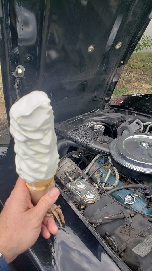

@xzero117 what is your timing set to?
I had something very similar happen to me this week. I got caught in I-95 traffic, and was crawling along for almost an hour in my wife's 79, L48 auto, no AC, stock clutch fan, Lars-tune, 180 degree thermostat. Partly sunny, black car, mid-day, 90 deg F. New-ish calipers and OEM-style brake hoses, old MC and booster. Did I leave anything out?
Anyway, the engine temp was rock solid at 185 or so (I was watching the whole time). My brake pedal got mushy. By the time I made it over to exit, I barely had brakes, and the "BRAKE" light would come on when I used them (indicating the combination proportioning valve was doing its thing, dunno if the front or the rear).
So, similar conditions, but the opposite result? I popped the hood, and the engine compartment was HOT. The coolest thing in there was the upper radiator hose.
I had an ice cream, found an alternate route, and finished the trip with no issues.

I'm at about 27 degrees advance at idle, with the vac advance. I wonder what would have happened if I didn't have CAI.
Perhaps the difference is your braided brake lines (I have them in my other C3, but not this one) vs. my stock rubber ones. I'm really at a loss to explain how we repeated the same experiment, but with very different results.
Can you post a photo? I'm assuming your fans are mounted on the back of the rad, and therefore blow a lot of air under the car. Were they running at 100%, and at full blast?
It was too hot to eat my ice cream outside.
