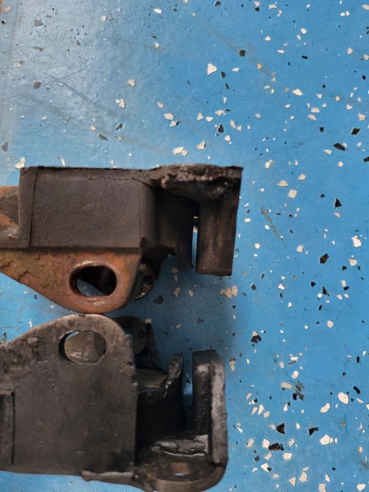

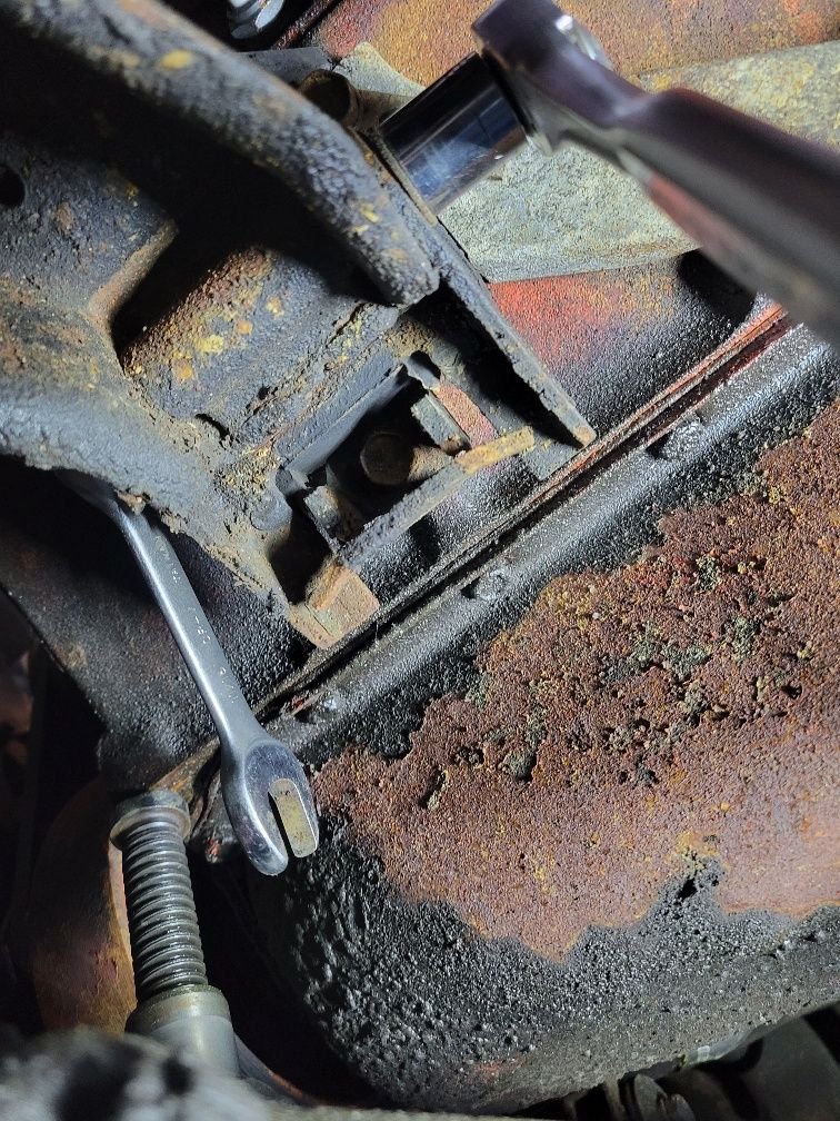

71 SBC with no P/S or A/C. I know I have a head start with no P/S but it went better than many experience and I had expected.
I started with the drivers side. Noodling on the ways I had heard about jacking the engine up via the oil pan etc. but after eyeballing it, I decided to go a different route.
With the car up on front ramps, I used a bottle jack to the the front of the engine by the front left corner that is not covered by the oil pan.
Lifting the engine a 1/2 of an inch or so allowed the through bolt to come out and all of the block bolts to be undone. Oddly my upper rear bolt was hand tight.
The rear and lower bolt are straight forward and accessible from under the pan and frame "engine cradle". The upper forward bolt can be reached
with hands above the cradle but while still on you back on the floor, yeah!
Jacking the engine up about another 1 inch allowed the mount to be slid down and out with a little fiddling of the plug wire heat/RF shield.
Install was as "easy" as aligning the mount and getting the top bolts in finger tight, then the bottom, then torqueing them down. Lower the
engine until through bolt holes align and you're good to go.
For the passenger side there is a mirror block jack point just inboard from the fuel pump flange. Getting at the motor mount bolts and through bolt is tighter on this side.
The lower block bolt and through bolt can be had from the bottom, the upper block bolts I got from to top. Pretty easy once you get the proper orientation and realize the sockets have to
be angled pretty far down to seat. The front just socket, the rear with a few inch extension. Extra fiddly aligning the upper bolts on reinstall because they're blind but very straight forward.

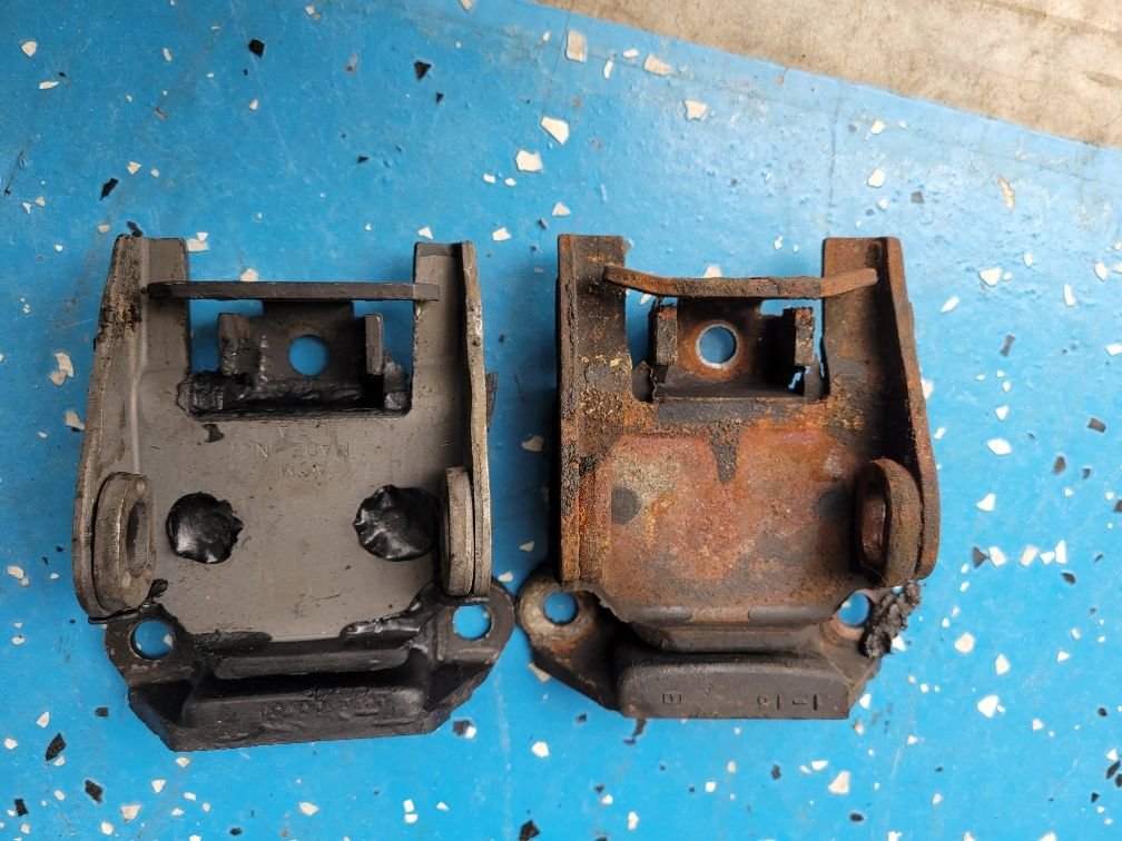

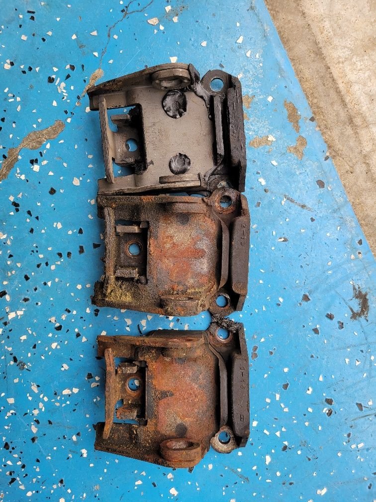

At the end of the day I might have replaced OK original? mounts but they had pretty lengthy stress fractures in the rubber so now good for sure.
I went with made in USA originals as they were inexpensive and seemingly solidly built.

I don’t remember which post it was on here, but somebody showed a picture of those original type mounts reinforced with two thru-bolts. The two spots with the rubber showing he drilled thru and put in a couple of bolts with tapered flat-mount heads. Retains the vibration dampening but protects from shear force when the engine torque-twists.

they have a metal hook on them by the bottom bolt holes so they would stop the engine from popping through the hood. in fact those new ones are essentially solid mounts that sit on a rubber pad. i am not nuts about using the pan. lift point is too far back. i use a block of wood under the balancer and unbolt both mounts at the same time.
