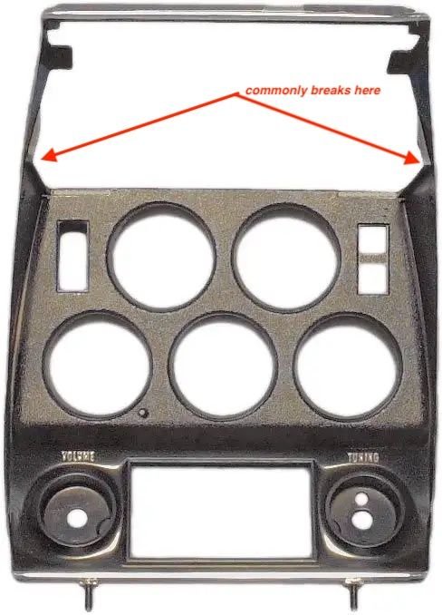

Old Jun 22, 2022 | 02:02 PM
barkingrats's Avatar
barkingrats
1967 Pedal Car Champion
Joined: Mar 2020
Posts: 9,034
Likes: 4,177
From: US-PNW
Originally Posted by jeffstuarts
Check to see if the main ground from the wiper motor at the starter motor is good. Because of its location, very often this is broken off- no ground. Been there, done that.
Jeff
The wiper switch itself also needs to be grounded. The C3's with the switch in the metal gauge cluster housing were grounded through the housing itself but if the housing breaks in the very narrow spot between the gauges and the switch, the ground may be lost.

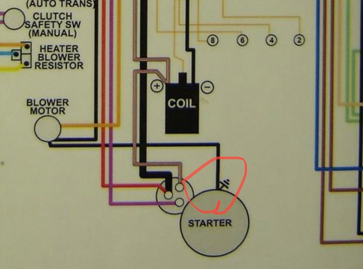

Old Jun 23, 2022 | 05:20 PM
Yuichi Ishitomi's Avatar
Yuichi Ishitomi
Joined: Apr 2021
Posts: 35
From: JAPAN
Originally Posted by ralphspears
Show us exactly where the ground was not connected
It is the ground of the line in the red circle. When I pulled it by hand, the terminal pulled out. The wiper motor started to work when I replaced it with a new terminal.
Old Jun 23, 2022 | 05:30 PM
ralphspears's Avatar
ralphspears
Banned Scam/Spammer
Joined: Nov 2011
Posts: 2,966
Likes: 991
From: MA
The black ground wire at the starter motor.?
Old Jun 23, 2022 | 05:32 PM
Yuichi Ishitomi
Joined: Apr 2021
Posts: 35
From: JAPAN
the black ground wire at the starter motor.?
yes
