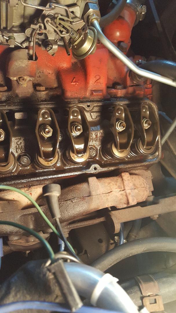

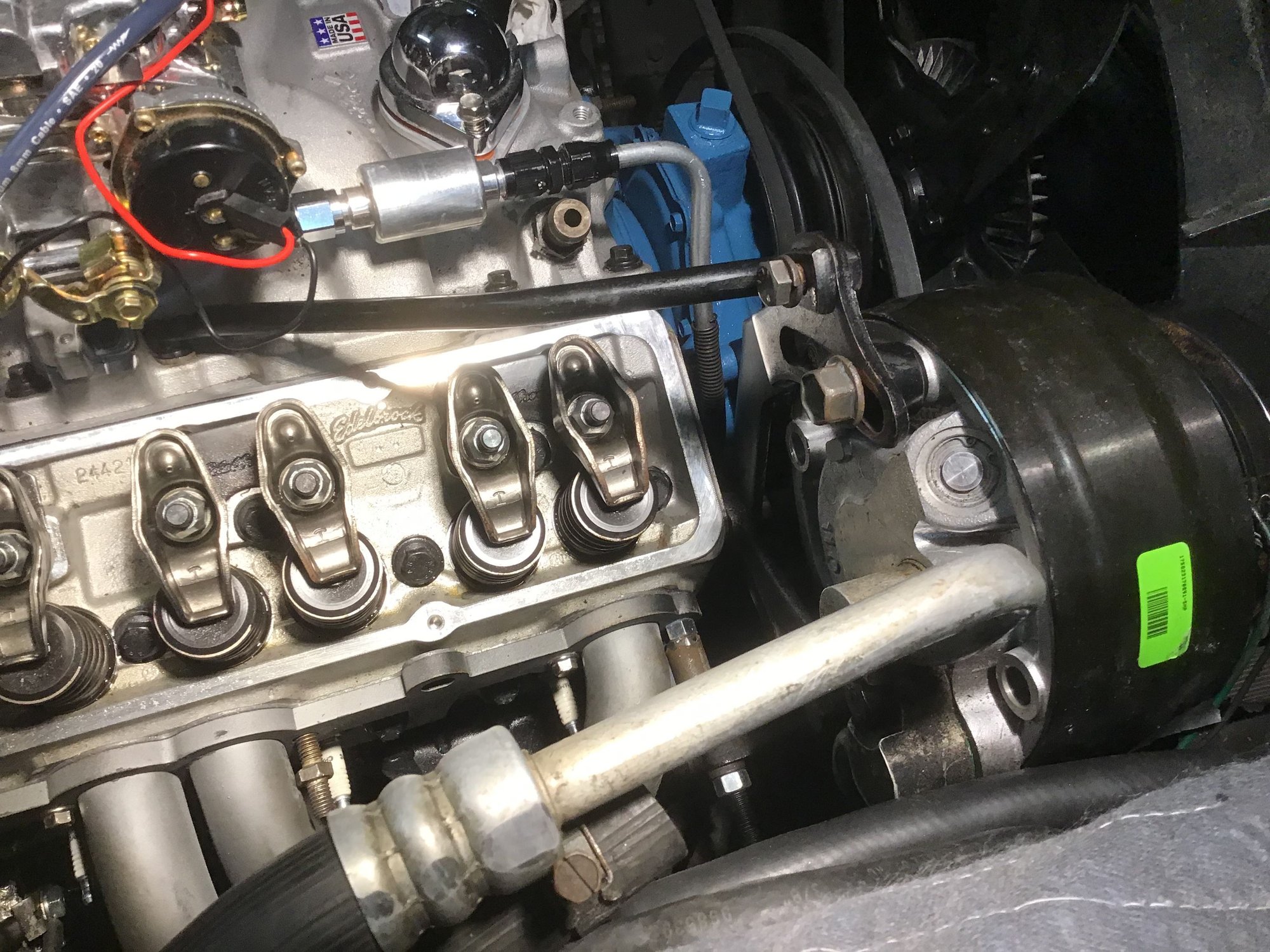

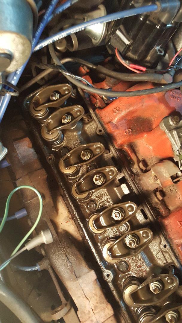

I have been working on my vette for a few months now,and been busy,not to mention too Hott here in SC,but,I keep my car covered,and hadn’t paid much attention to the engine in 2 weeks,but saw yesterday where my new rocker arms has surface rust starting to form,and did pour oil on them a month or so ago.but in this metal building and 100 degree weather not helping,does coating with Vaseline help,to keep from rusting till I get ready to fire it up.

The valve covers are off,and no biggie a soft pad and they wiped right off,but I always keep the top of the engine covered and if I’m not working on it,the car is covered,and hadn’t put any oil on them in a month,and here with the humidity +100.

There are different levels of rust what you have won't hurt anything.
Get some aluminum roller rockers they won rust.

It actually looked worst than it was,never done this so,probably a little paranoid and worried if this thing doesn’t fire up.lol

In answer to the original question. Yes petroleum jelly will work fine.
I've used it many times when assembling Harley engines that I am fairly certain won't be fired for a bit of time.
I use it on main roller bearings and other areas. Never an issue.
