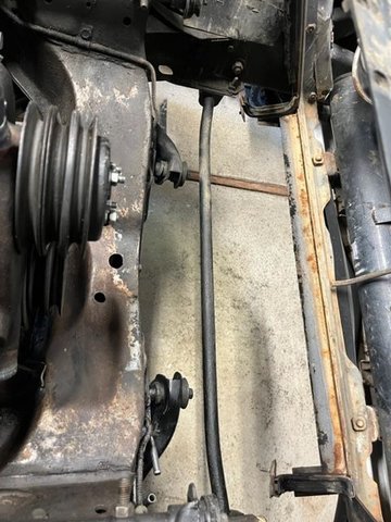

I’m in the process of tearing apart my 73 big block Coupe as part of my restomod project.
Today I removed the radiator shroud and radiator.
As part of my project, I’m replacing the radiator and shroud for a DeWitts aluminum radiator, shroud and dual Spal fans.
After I removed the stock shroud and radiator I noticed that the area between the bottom of the radiator and front crossmember was now open where with the stock shroud in place this area was sealed by the shroud.
Will this cause any known problems with air flow through the radiator?

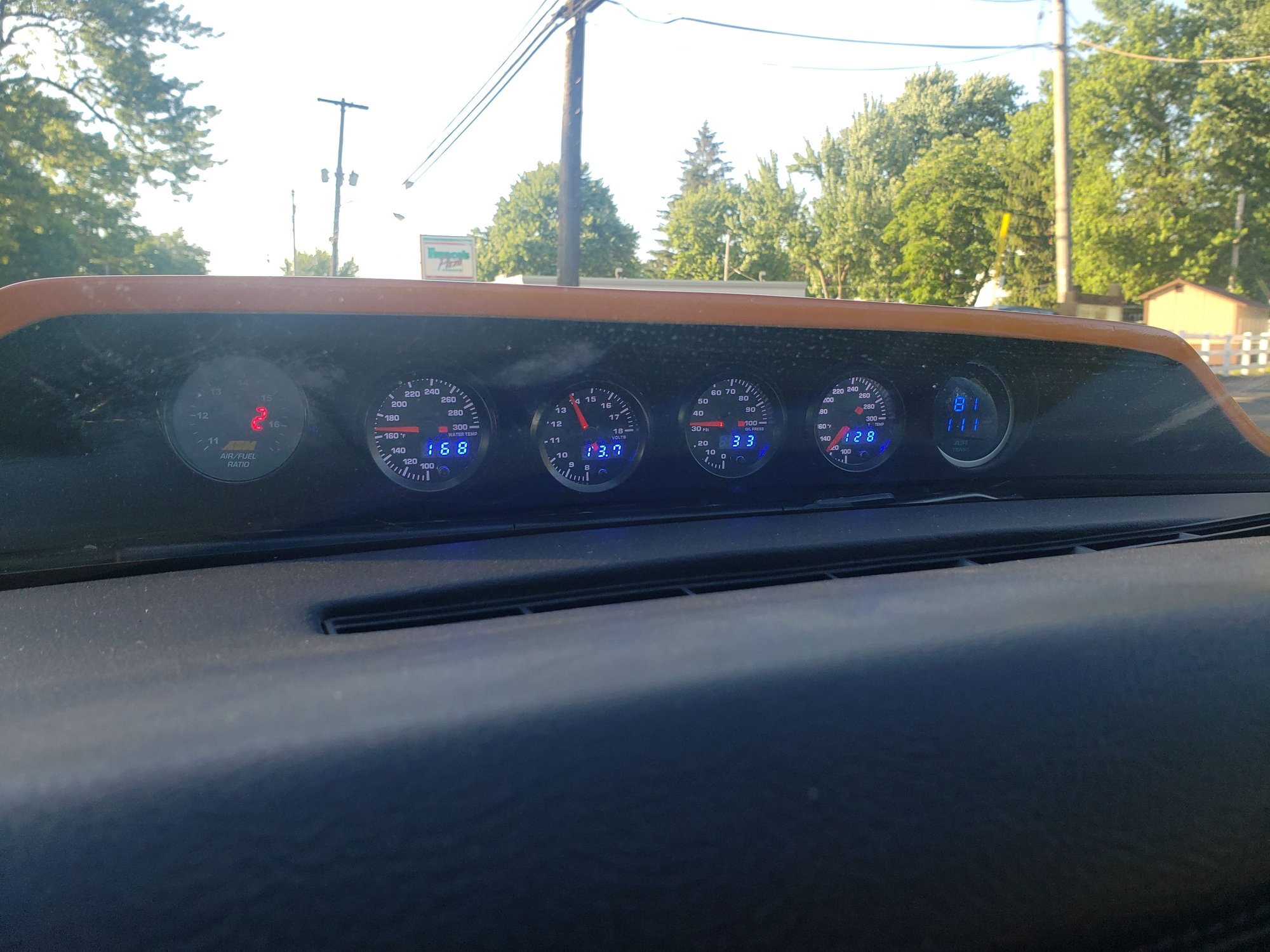

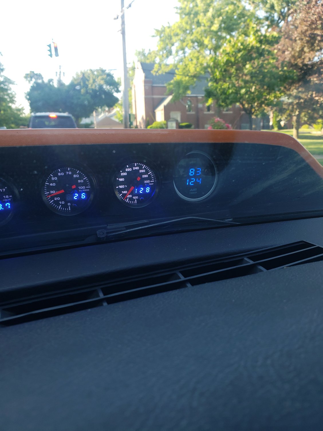

It did not for me but I run the "be cool" spal cloned that had the be cool logos ground off and are sold cheap on ebay (seconds I guess?) I also have a 3 row champion rad. My car is adjusted now to stay around 180 degrees but when I had a different state and the fans setup for 165 the car never went over 174 I have the spal aluminum mounting plates and no weatherstripping between the fan shroud and rad. if anything my engine compartment stays cooler with the new setup. this was after the car was running for 45 mins and I was cruising through town about 30mph stop light to stoplight... bottom temp is a sensor mounted 5 inches from the passenger sidepipe header/head mount.
124 degrees under the hood.. top temp of 83 is a sensor inside my air cleaner housing. (new diy CAI) it was about 80 degrees outside yesterday.
engine temps were 168 here since i was playing around with when the fans kicked on and they were both adusted to come on too early. ignore the afr the camera caught it mid refresh rate, thats not what it was displaying.

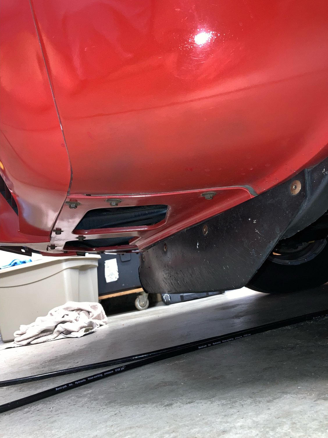

GM learned something after 1977 about c-3's. It was called the chin spoiler directly below the radiator. The idea is to stop air flow under the car which created high pressure under the hood. Not only front end lift as speed increases, but also pressure behind the radiator which slows flow through the radiator.
You want low pressure behind the radiator which the chin spoiler creates.

The chin spoiler on stock 79's was directly under the radiator. I don't know if this is the same part???? does someone have a stock vette too verify?

That looks correct. I don't have a good photo right now. There is also a 79 only extension spoiler, that screws onto it. It should work for other years, too.
