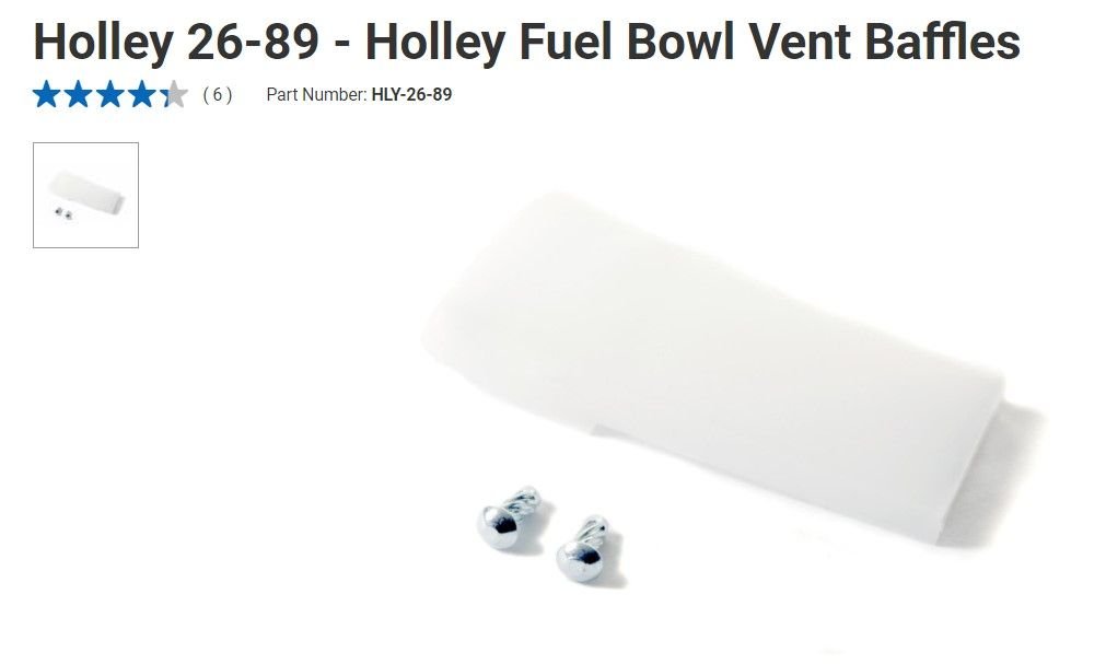

I road race my car. Yes, you could have fuel spilling out of the bowls. To fix this, you need to get a couple of "Vent Whistles". These rivet to the top of the metering block and prevent fuel from spilling out the little square hole at the top under hard braking and acceleration.

You absolutely need the white plastic vent whistles. Mine got fuel slosh in high-g turns or high-g braking until I used those. That stopped most of it.

This is the whistle. They are cheap and everywhere. If you haven't done it yet, you need it. You can brake way harder than you can accelerate I do not care how big your engine is, it's 4 wheels vs 2. Unless it's a well setup drag car. It's just physics.
