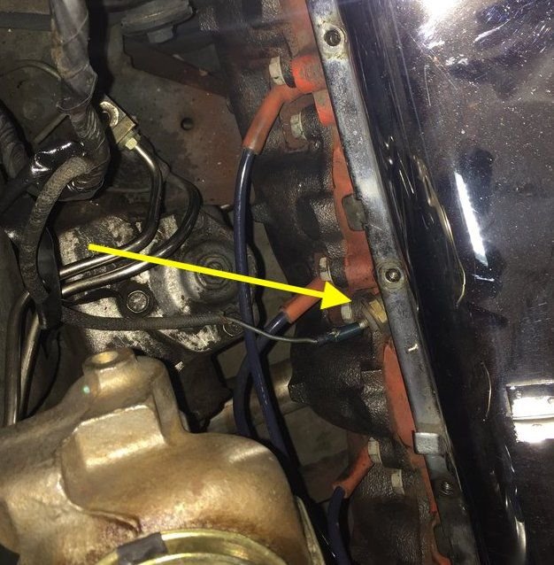

This should give you an idea of where it is. You can see the brass sender in my cyliner head int he middle of the 3, 5 exhaust port.

Sigforty,
Nice engine! I'm having a hard time believing I can't see it if it's so "close". Will double, double check.

Thanks! If you can post a picture, it could be that someone blocked it off or put on different heads that don't have the port drilled and tapped.
