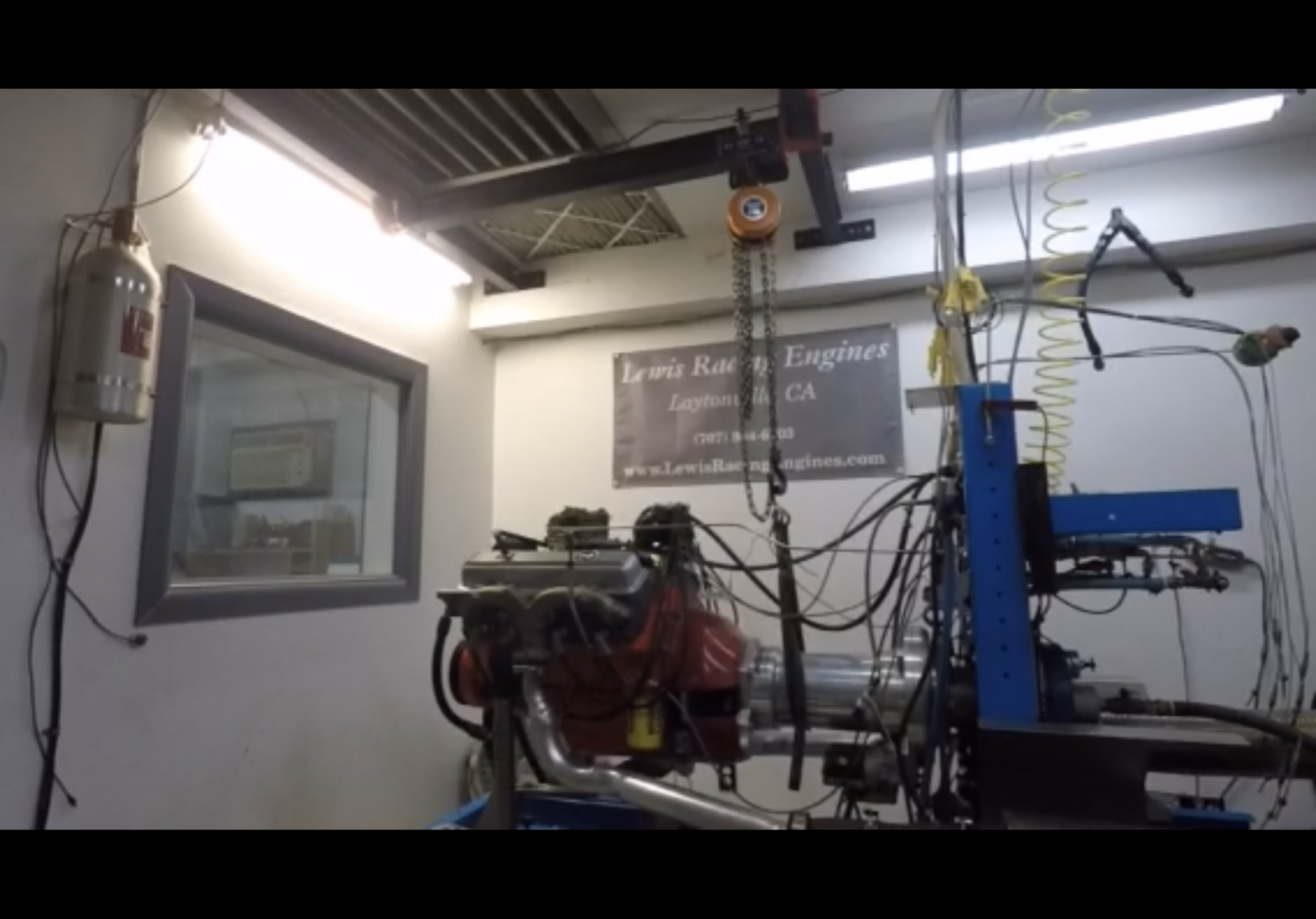

SBC 12 to 1 4.060 x 3.625 x 6.00" with ported TFS Double Hump heads, Factory GM Holley Intake and Holley Carb. Vintage Road Race....Factory NOS manifolds with port work, Dyno sheet the lighter set of lines is the 1 5/8" headers and the darker is the ported manifolds. 18HP between difference. Pretty impressive for 58 year old manifolds...

How much port work went into the manifolds? If you were billing someone for this work, how much money would they be out?
Can you post pictures of the header ports? How do the manifolds compare to a 1 3/4 or 1 7/8"?
What cam was run on this engine? Was it designed to take advantage of the exhaust manifolds?
Also, looks like 20 hp at peak, not 18. 18 looks like the torque figure. 2 hp is well within rounding error of course. Do you have figures for average HP/TQ? It looks like the headers are making more power everywhere, judging from the chart.
Its a vintage road race engine that will be using the manifolds. I can go into cam specs in detail. Cam is 600 lift and in the 250 range for .050" Duration and was designed for competition in road racing for a broad range of torque. BAsed on the piston speed a little larger header would have helped on the top end for this combo. 1 5/8" headers were used only as a comparison.
Dyno Sheet...Headers...

I agree. The ported manifolds did a commendable job. I would not use this as a basis for argument in a "should I do stock manifolds or headers", though - we are not comparing apples and apples here. And a key point is that the undersized headers still did better throughout the powerband.

I disagree. 20 peak horsepower more on a set of undersized headers vs a set of custom-ported manifolds, plus the average power differences across the entire curve. If the engine were equipped with 1 3/4" or 1 7/8" headers, we may have seen a power gap of 30 or 40 peak hp. At this point, with this motor, would you chase a little more cam to get a little bit more power and shift the RPM range up, or go with long-tube headers and make more power everywhere in the curve? Not to mention, if you had started with stock ram's horns, the work to replicate this may be equivalent to, if not more expensive than just buying a set of headers. I'd also be very curious how the stock ram's horn setup compares to the ported setup. (@StraubTech - that port work is beautiful, by the way.)
I think the takeaway here is if your build is constrained to manifolds, you can do work to them to minimize the amount of power you're losing not going to a full length header. Straub's point is excellent - there's plenty of race classes that require manifolds. If your car doesn't have header fitment, you don't like them for packaging reasons (spark plug access, ground clearance, heat management) or you can't do it for smog reasons, this shows that ported manifolds are a very viable alternative.
But I wouldn't herald this data point as "the guys who have been championing long-tube headers are wrong", which a lot of people in this thread seem to be doing.
Look at the dyno chart. 20HP at peak. 20+lb-ft EVERYWHERE in the displayed curve. It's not just a near peak-to-peak difference with long tube headers. That chart actually dispels your post entirely, along with a wide held belief that long-tube headers only increase power at peaks. Not true. They increase power across the entire curve, and that's what I've seen in my personal experience and numerous other dyno tests.
