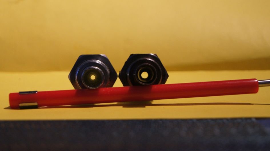

Light steering can be adjusted by replacing the flow restrictor in the pump. Did this when I installed a flaming river rack in my 78.
left 1.3 gpm vs the factory 78 flow control valve ~ 2.x gpm . Depending on the PS pump type
below is a link to the company that helped me get the right piece.
Turn One Steering - Steering Products
tech note on flow vs pressure. And why and what each do.
Turn One Steering - Posts
