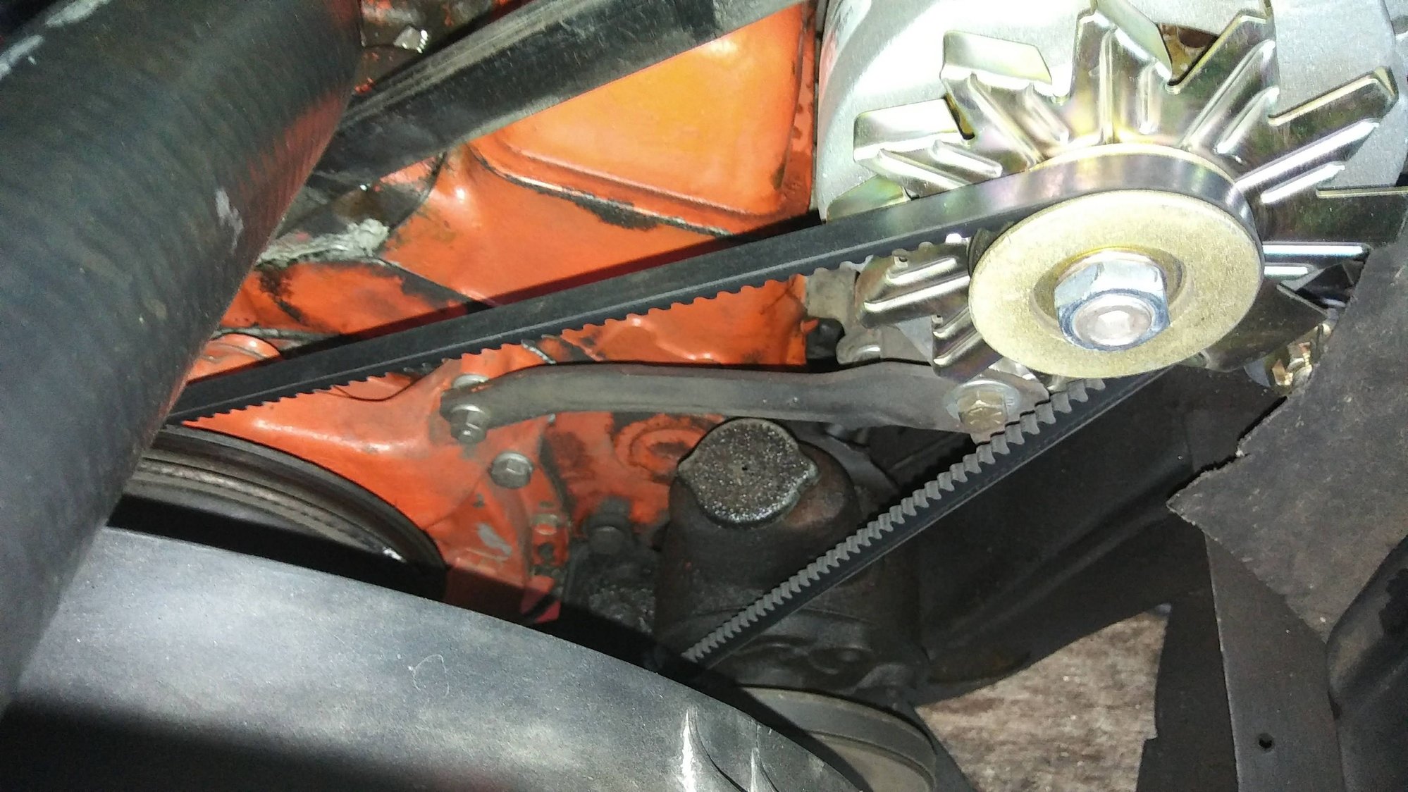

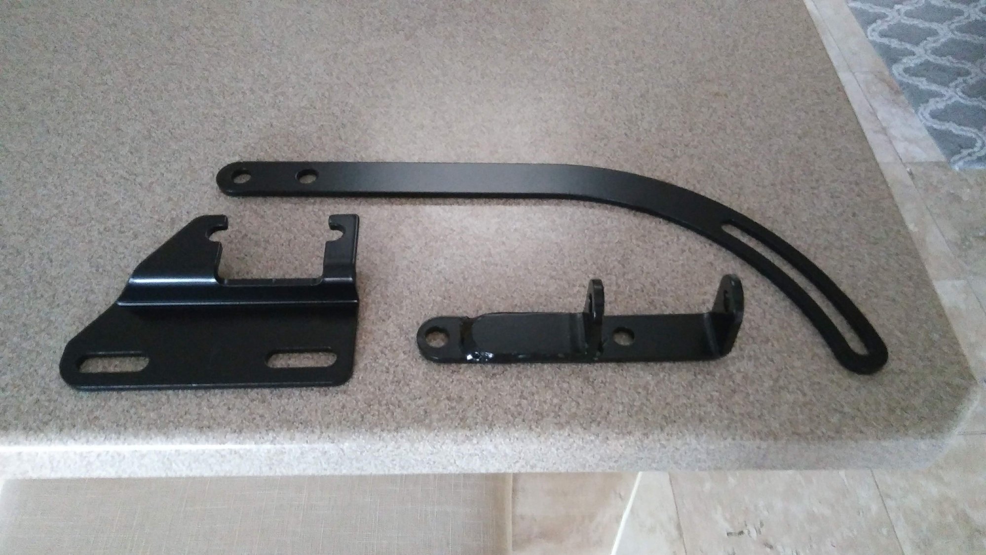

Has anyone added headers & used a relocation bracket (s) for mounting the alternator? The old Rams horns manifolds will be removed & that's a mounting point for the lower alternator. I have no idea how the brackets I bought are supposed to be arranged. Any ideas or pics of yours? My pics attached. Thx!

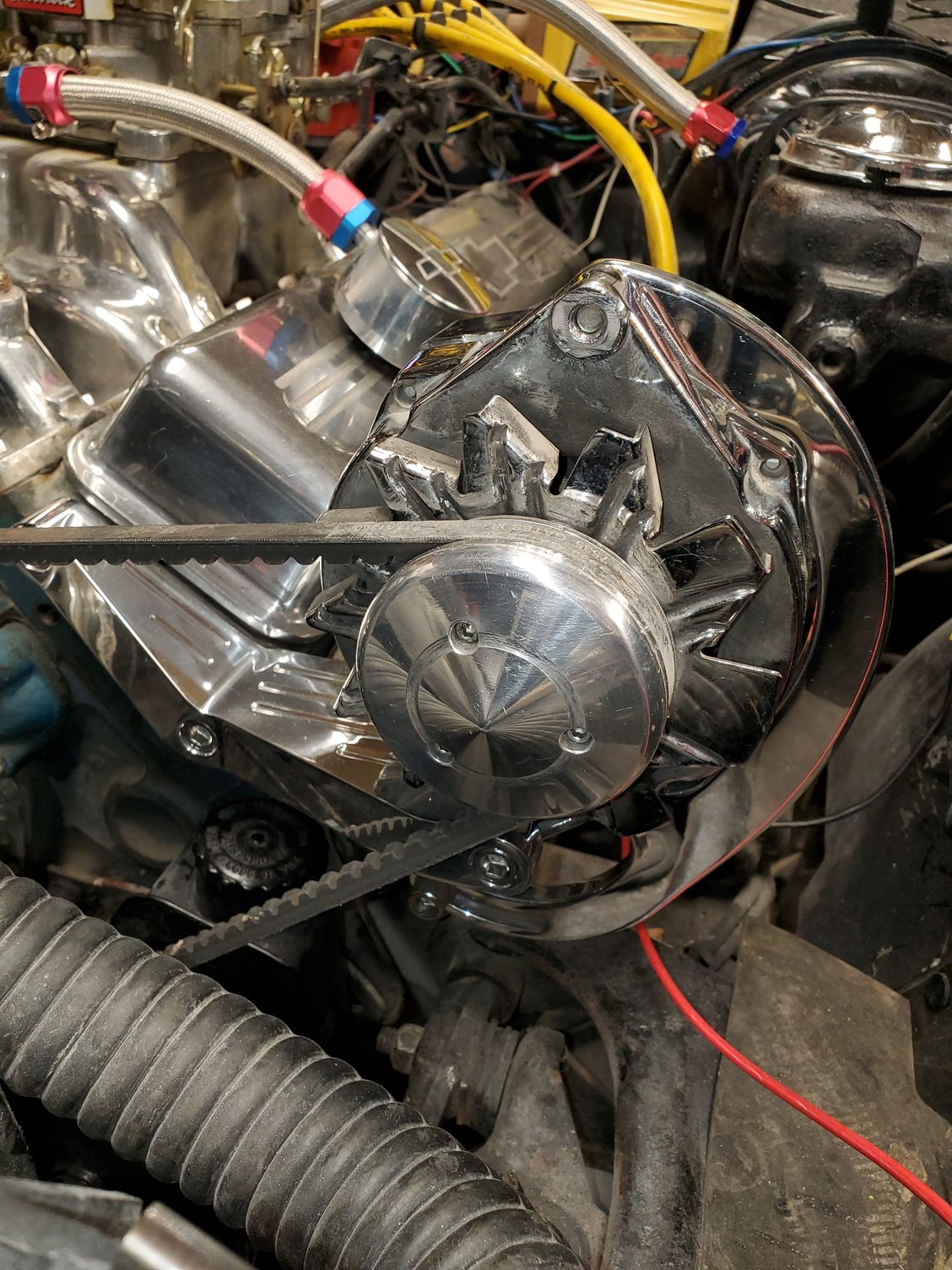

Billet specialties sells this kind of bracket for that application. Not cheap, but solid

The one with the notch goes against the header, side facing up in picture against engine with bracket above the header. The other one bolts to the slots and mounts the bottom of the alternator. Long bracket goes from intake bolt to top of alternator.

The left bracket goes over the header tube 1 and uses the bolts to attach it. The bracket to the right will attach to the slots in the header bracket, and also attach to the bottom of the alternator. The top curved bracket goes from the upper water pump bolt to the adjustment bolt on the alternator. I don't have any pictures, but I am sure google could find some if you look for Hooker header alternator bracket.
Wow.... That poor little air filter how is that not hindering performance?

That's the way it came from the OP. And yes. Total performance blocker.
