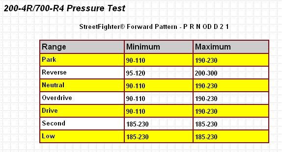

I did a 200-4r swap and all I know is you need a pressure gauge and the correct carb adaptor.Anything less will be hit or miss and a miss can be costly.I would get a pressure gauge a see where your at the way your doing it.Heres a chart. idle/1000 rpms

Hmmm.... the pressures on my 200-4R are in those lower ranges but my shifts are seemingly early. I'm thinking I have to tighten up my TV Cable.
Is there readily identifiable viable substitute spring I can just get at the local hardware store?
