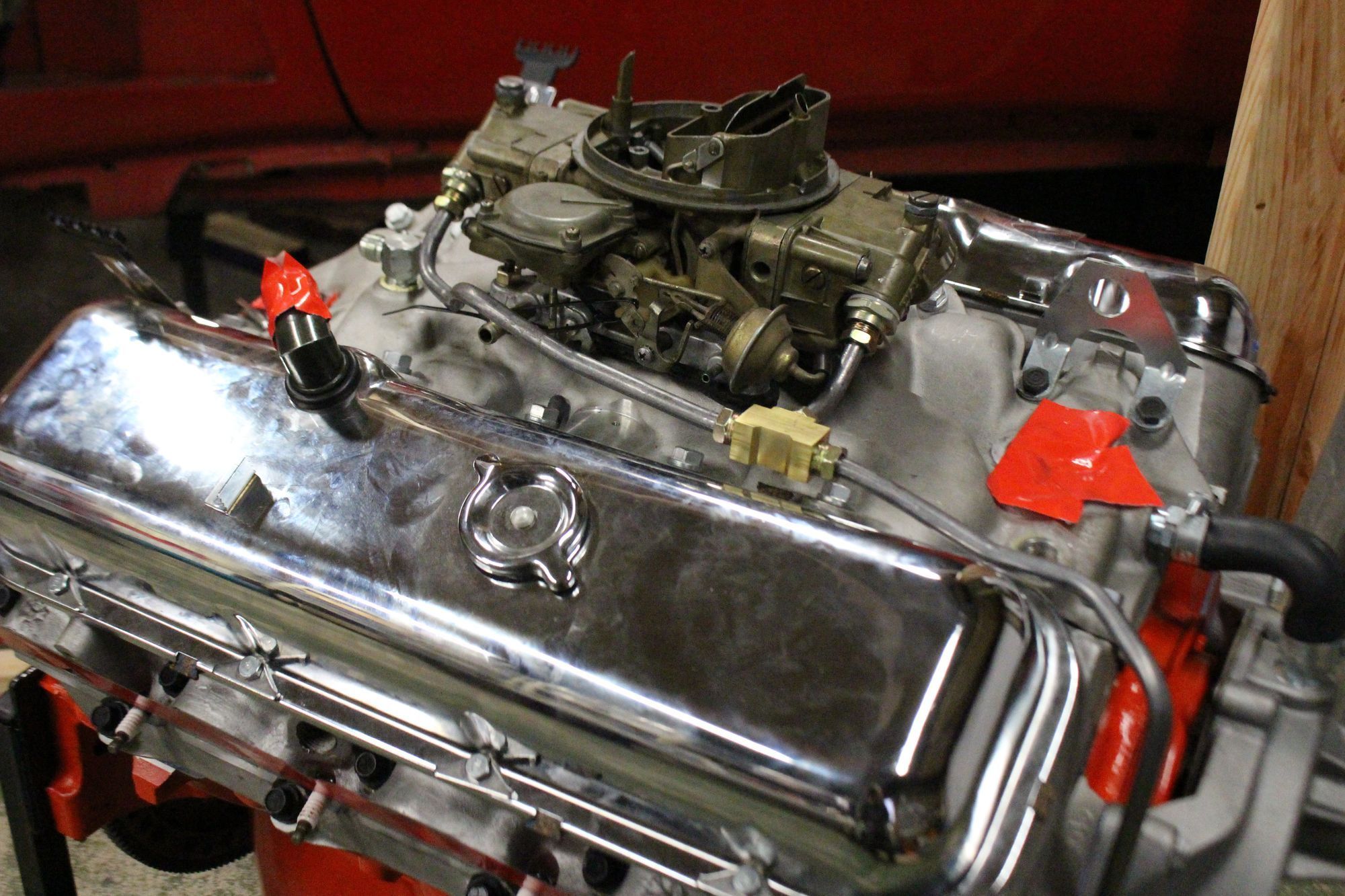

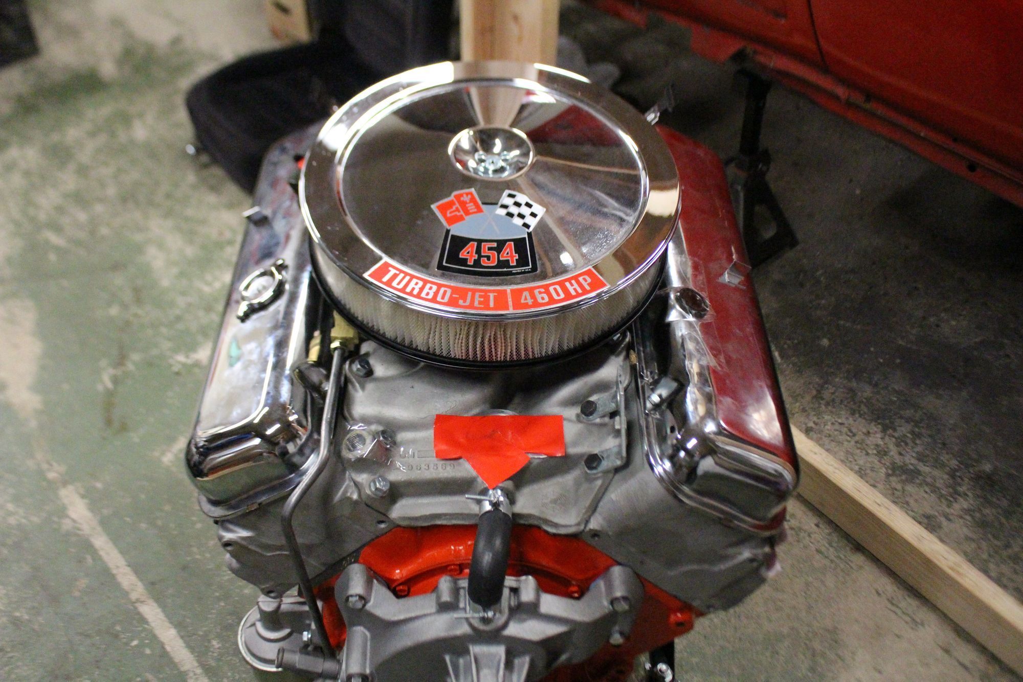

I built a 99% replica of an LS6, down to the OEM Aluminum heads. 230/240 roller, & the flat Vette 569 dual plane intake. 10.5 CR. Dyno'd at 485HP and 550 ft lbs. I was a little dissapointed also, expected low/mid 500s. What I learned since is there are two things holding my motor back. Heads and heads. R-ports are just too big for the street and don't really come on the "port" until 5000+ rpm. They'll flow to 7000+ on a race car though. The flow numbers are OK, they just have too much volume and low port velocity. Oval ports are stronger below 6000. Second the the whole head design is 50 years old. The L88 heads have horrible round exhaust ports, they "stall" . Cylinder head airflow R&D improvements have been enormous in that interval, especially in the 90s. Several well respected engine builders I have spoken with said if I switched to the current design AFR heads I would gain 80HP with zero other changes!! Bringing it to 560. A taller intake could be another 20 but only past 5000rpm.
You can do a little better than that with an LS427 or so, because the LS heads are so much better. Mainly it will be more efficient. But it really won't be as much of an improvement as most people think if you want to keep the cam civilized, and if you use current BB heads. 230/235 duration is about the limit for a civilized street cam, in either engine series. You can go with a bigger cam, and a lot of people do, but it will sound and run like a race car at low rpm & cruise. Some want that, some don't.
I would keep it a matching number BB, but change the heads, etc. EFI if you really want. The throttle will be crisper, and it is so much easier to fine tune the fuel maps. But ultimately it will only be a slight improvement over a carb. If you tune the carb hard enough.
What kind of gas mileage can you get with your current OD setup? I know of one guy who can tickle low 20s with his 6 spd OD EFI 496 cruising.
Oh and you need a OEM drop down style air cleaner base so you can fit a larger 3" tall filter under that BB hood. 2" is not enough. My air cleaner base is not even an inch higher than the valve cover.

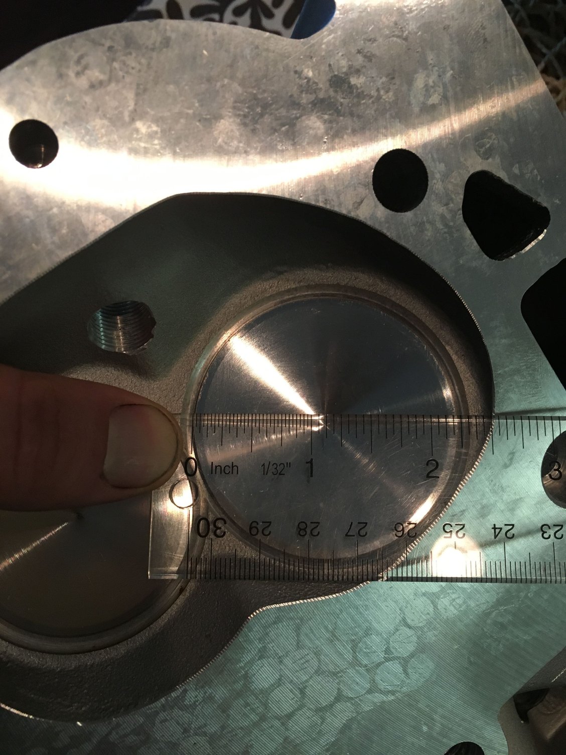

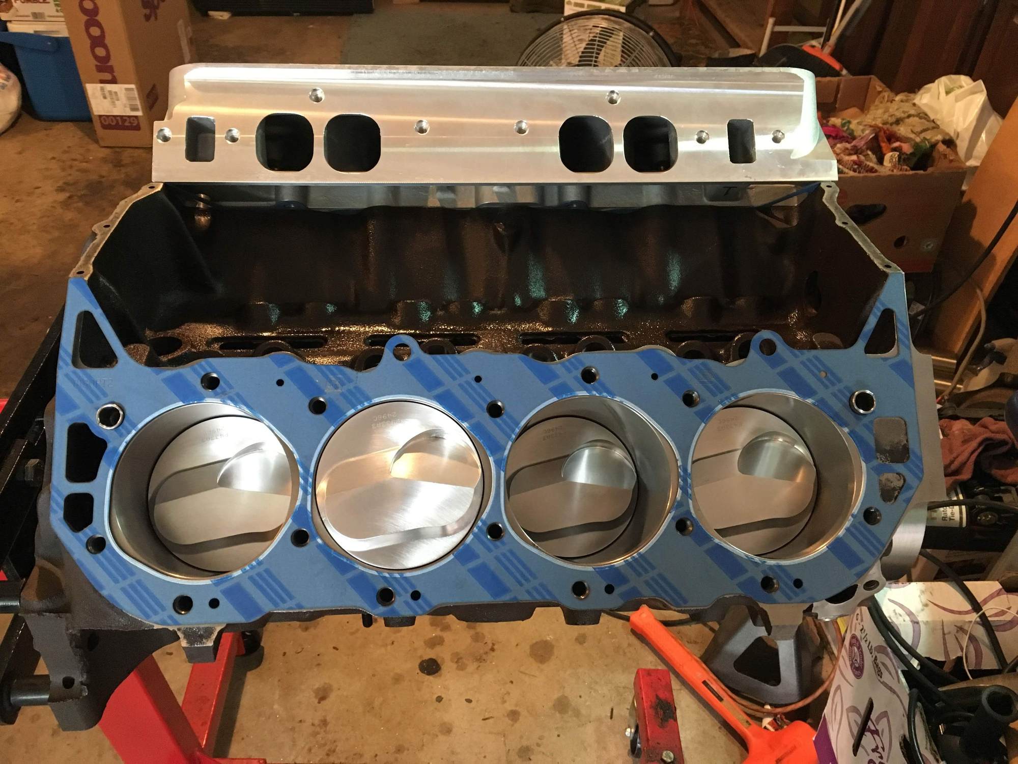

Please look at it...It has Holley Sniper EFI already and it does control the timing. Rest of it: Studed original 2 bolt mains block, original forge steel crank 0.001 under micro polished, Wiseco dome forge pistons 0.030 over and scat rods. All ARP Fasteners. Around 10.2:1 static compression. Can't find the exact specs on heads, Unknown Aluminum oval port with large size valves. 118cc chambers. They're not high dollar heads. Cam: 224.6/ 230.6 duration, 0.567/0.578 lift 112 LSA, Hydraulic roller retrofit setup and rockers from Comp Cam. Edelbrock Torker II (unfortunately) intake. and 2" tall open filter element. Full length hooker headers and 3 (or maybe 2.5" not sure) exhaust. MSD box, distributor, and coil. Vintage air Front runner serpentine setup. Be Cool Alum. Radiator and 2 12" I think fans. HV Oil pump ( a mistake also). TKO 600 with 0.64 Overdrive ratio, 3.70 original Final drive. What else I'm missing...
I mean...it runs fine, not like there's something wrong with it. I know for a fact my intake is not good, my air cleaner is too short and I see my IAT reading climbs, especially if I turn it off for a while and proceed again. It just doesn't receive enough cool air under that hood. I'd like better performance low to mid range. Thanks a lot. I didn't know any better back then when I put this together.
