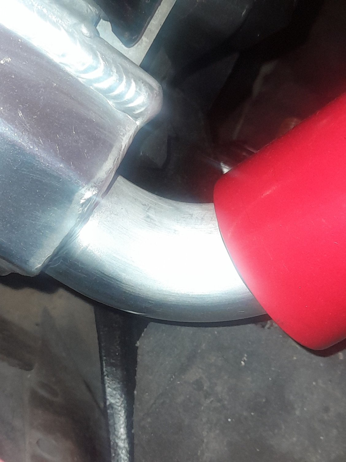

Originally Posted by CorvettePassion
What is the hallmark of a cheap radiator is those tube outlets manufactured by welding straight pipes into a bend instead of the proper type bends that are on OEM radiators.....and Dewitts. Nothing screams cheaper to me than that,.....I don't care how good the rest of it is built. Even Cold Case is done this way. Oh well....you get what you pay for....and I guess it works.
Seriously??? Just walked out to the garage and took this photo of the upper hose connection on my Champion radiator.
I'm failing to see how this mandrel bent fitting is somehow straight sections welded together.
Ok......that one has a mandrel bent fitting, which says to me, its a good one. I didn't call out Champion by name, but the Champion radiator in post #12 above appears to have welded elbows. I was hoping to buy a Cold Case, made in my home state, made in USA.....but they decided to put the "homeboy" welded elbows on. Champion has not really been on my list.....maybe I will check them out.
