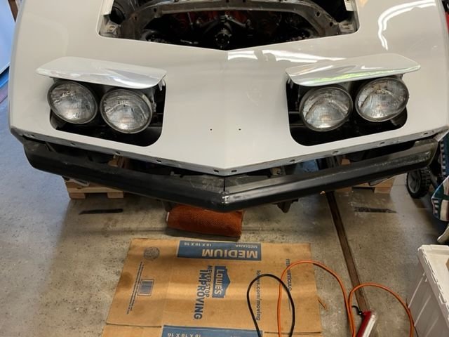

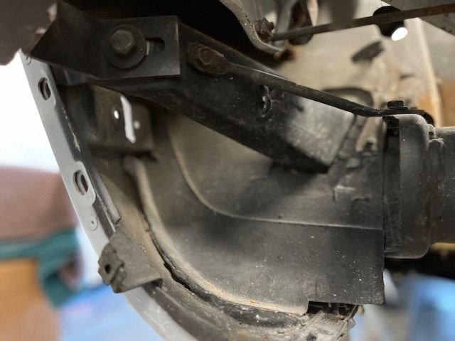

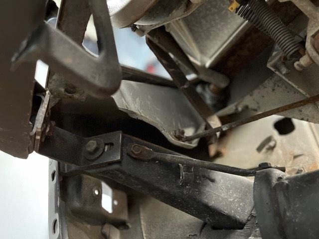

I’m preparing to remove the body from my 73.
I’ve removed the front rubber bumper and I’m preparing to remove the metal front crash bumper and all its supports before I lift the body.
Do I need to put some wood blocks in anywhere to support the front clip after I remove the bumper assembly?
The radiator support will be left in until after the body is supported on the dolly, and then it will only be out while it gets cleaned up and painted.
Thanks
Old Jul 11, 2022 | 01:13 PM
derekderek's Avatar
derekderek
Posts: 13,082
Likes: 3,399
From: SW Florida.
rad support left in the nose? that is where you need to support the nose. if rad sup stays in the car, it is a bit trickier but doable to support the nose there. or get creative and bolt 2 2x4's to the inner fender where the rad supp mounts and prop them up. i left my nose hang a few years with rad support out. bonding strips let go at the firewall. now it is easy to adjust door gaps...
