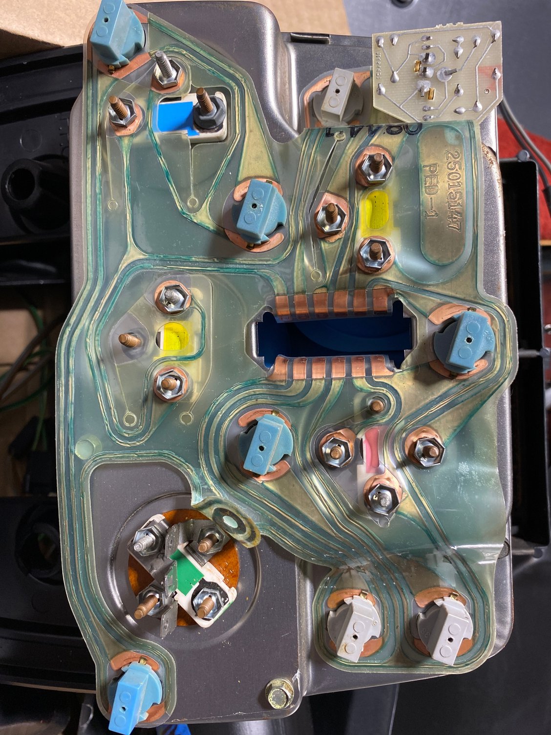

Is there a way to bench test the factory fuel gauge? All connections and contact to the board seem fine. Yellow resistor gauge. What process should I use to diagnose?

your profile says an '82, if so try this link
http://repairs.willcoxcorvette.com/1...-unit-testing/
http://repairs.willcoxcorvette.com/1...w-to-find-out/
until we get to know you, it's always helpful to state what year your vette is, makes helping a bit easier....

Thanks riverracer. I forgot about all the tech and testing that Willcox has available. I’m ready to get this sorted out. I usually list the year I’m working on, just omitted. Correct, 82 car completely factory.
