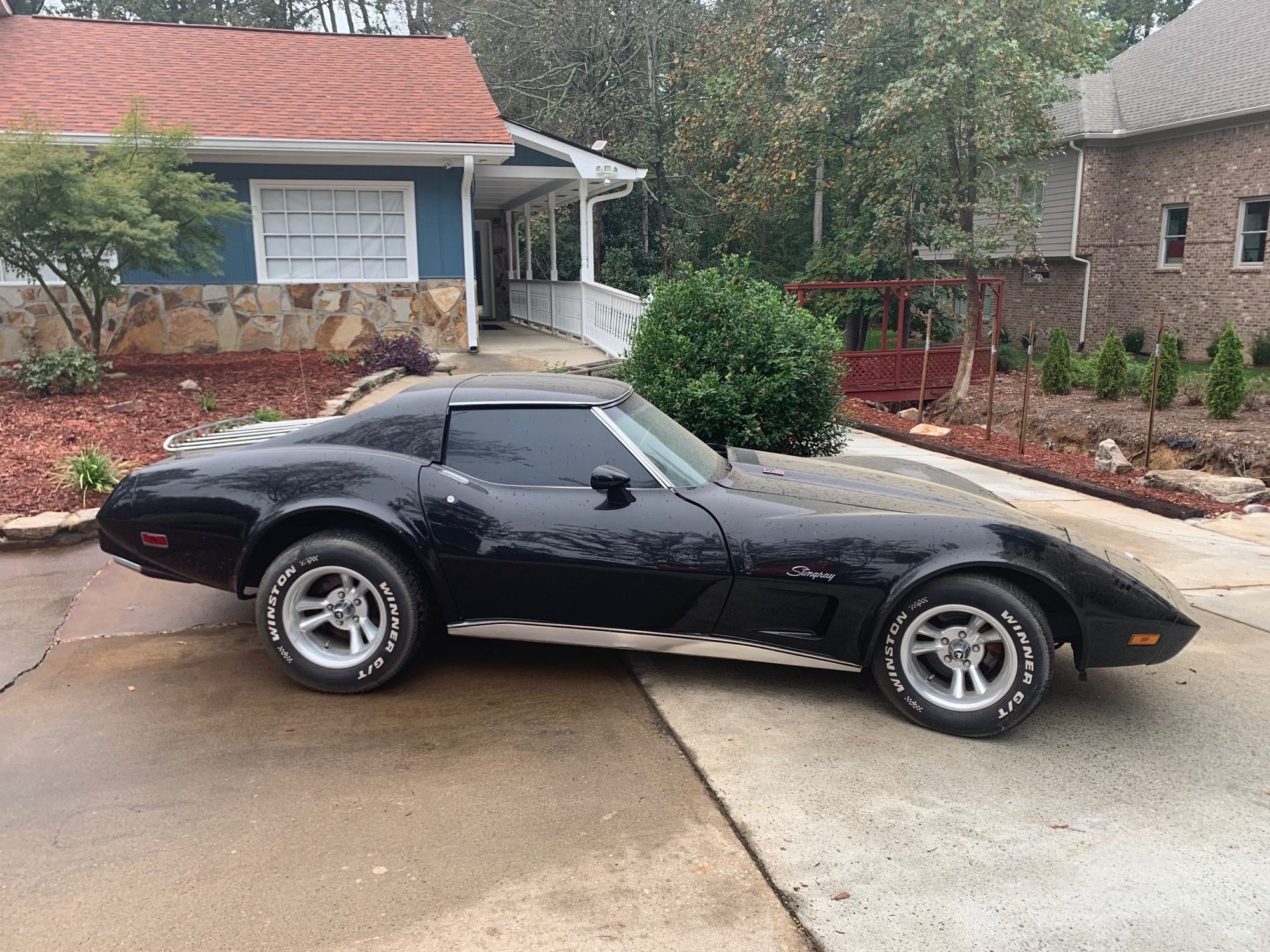

Hello all. I am new to the forum and glad that I found it. I am about to start a restoration project on a ‘75 Stingray. Long story short, it has been sitting for nearly 20 years as the previous owner (my brother) had neither the time nor expertise to do anything with it. My 17 yr old son and I will be restoring it together. My initial inspection revealed brake calipers locked open and some minor other issues. I will get deeper into it in a week or so. I have turned a few wrenches but am by no means a mechanic. My son will be going through a very good automotive program as part of his senior year of high school. I figured this was a good car for him to get to know and he is more than excited.
What are some of the major things I should look for when starting this project? I know a few of them are vacuum issues, radiator mounts/radiator condition, bushings, body mount points, and water damage/rusting around the birdcage. What other things are common with this model?
Will post pics as often as I can. Here is one as she sits now. Thanks!

Based on the picture of the car it looks like it will not take a lot of restoration to get it safely back on the road. Rule of thumb for rubber products 1) if liquid runs through it replace it, 2) if no liquid runs through it inspect and replace as required. Replace the tires regardless of condition. First goal should be to get the car starting, running and stopping.
Post a picture of the interior and engine compartment, we can tell you a lot just looking at pictures.

Looks like a really nice Vette, and apparently an L-82. Pics of under the hood and interior would help with responses. Good luck...

From the picture, looks like a good one to restore!
