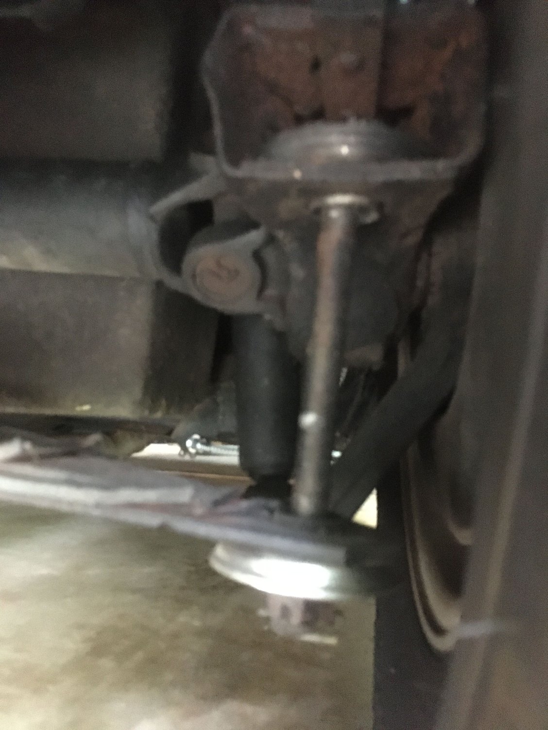

The rear in my ‘68 seems to me low with the tires toeing out. The bolts from the trailing arms look to have been replaced and don’t look look longer than they’d be stock. When I did the rear brakes I checked for bearing play and it was all good. The bolts don’t look to have any more threads to tighten the castle nuts up on. Not sure how to go about raising the rear to take out the squat and toeing out issue.
was thinking of adding some thick spacers above the castle nuts (?)
Is that a reasonable solution?

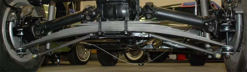

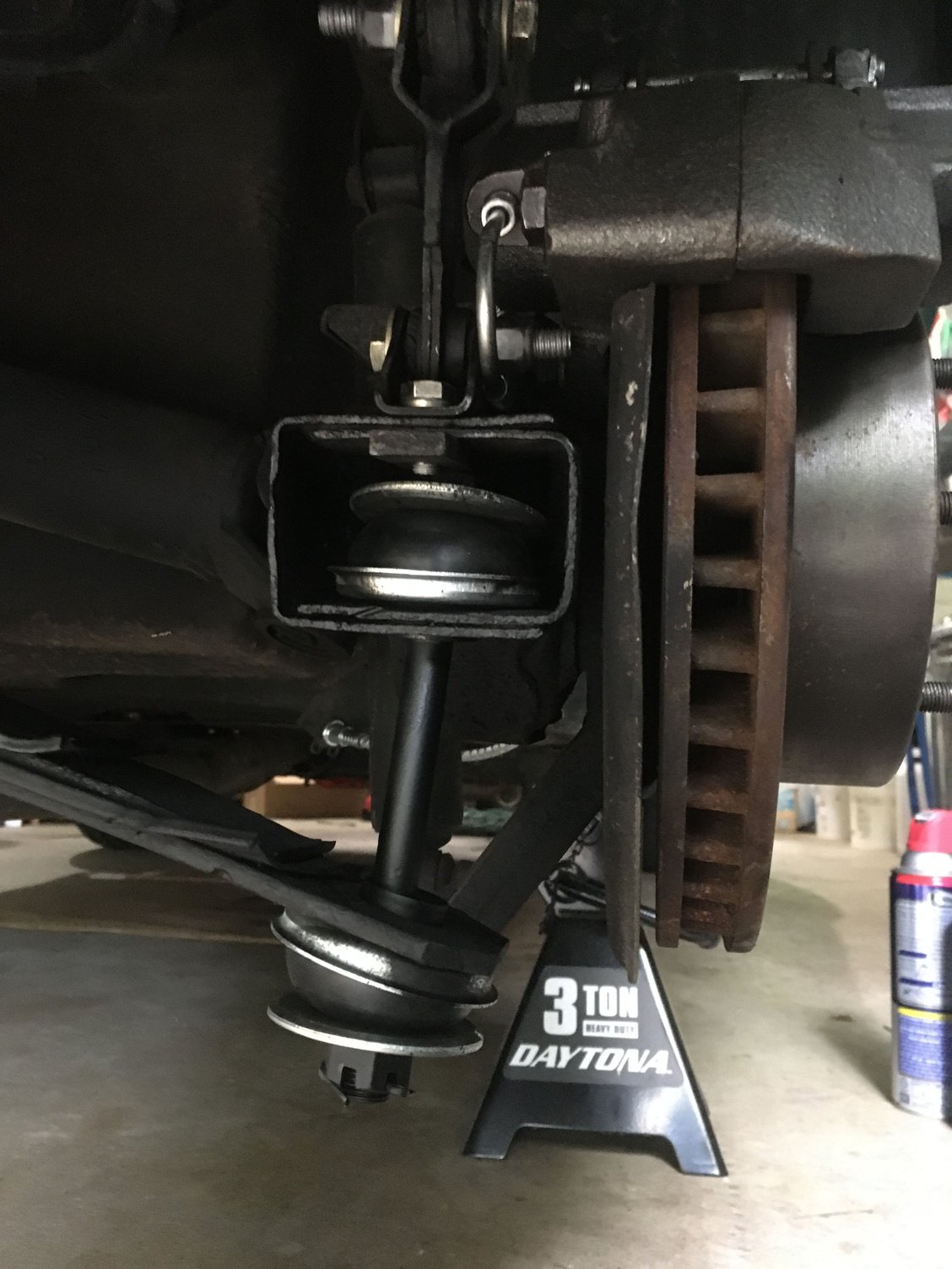

your spring bolts are assembled wrong
you are missing the rubber bushing and the other two retainers
should look like this

there is 2 inches lost on the bolts with both bushings missing which will be a bit over an inch of rear height. and if you want higher, you can buy a couple of 5/8th nuts from lowes depot and put them last thing before the nuts to get another half inch or so. and then maybe look into shorter bolts. oddball bolt. 9/16th thread. although if you tried grade 5 or 8 1/2 inch bolts to play around and find the correct height they would work. then try fastenal or a truck spring place to see if they have the size-length you want. may hafta drill the cotter pin hole in the bolts.

Your response and photo is very much appreciated. The photo make the issue mine has obvious.
I’ll be ordering a new spring mount kit from Zip later today. The have the original on back order but the polyurethane set is in stock. Kinda rather stay with the stock setup. Their both pretty cheap to buy though.
These were obviously replaced when the “restoration “ was done. I can add this to the list of things I’ve had to correct on this car. Some things were well done which was probably within their expertise but more than a few things on the car …

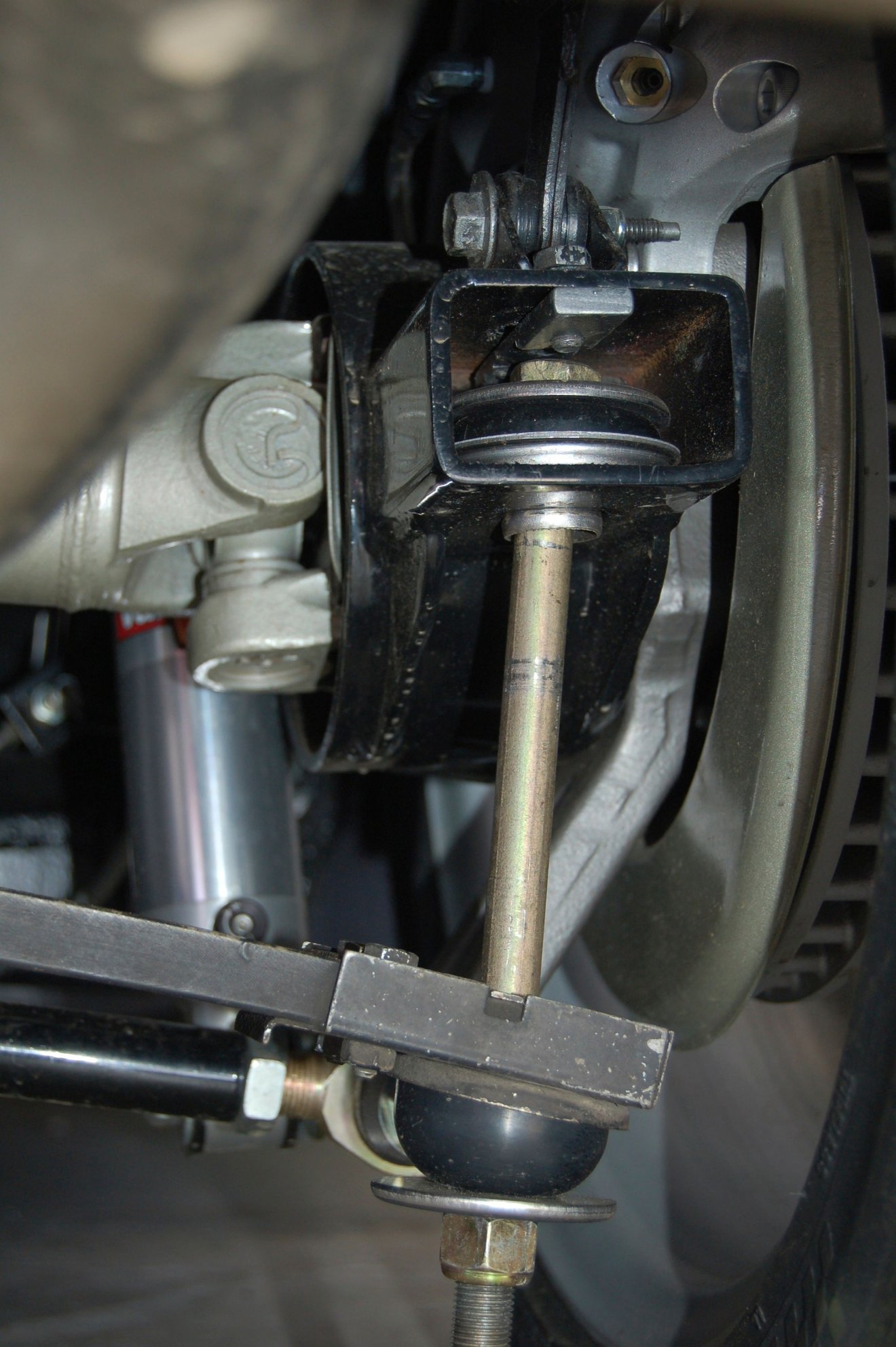

Hey Lt Mike, I thought I'd add a pic of our '68 (w/F41). Hope this helps. This was before I reinstalled the rear sway bar - the 2nd nut was just something I was playing with at the time before I put in a shorter bolt - but this might help. Also, when you install the washers over/under the rubber, make sure you put the flat side of the washer away from the rubber - rounded side toward the rubber. You'll get it! Best, Paul

It is. I was able to go back to the shorter one and still got the exact ride height I was looking for as the rubber compresses a bit after being loaded up. Good luck, and have fun doing this stuff!

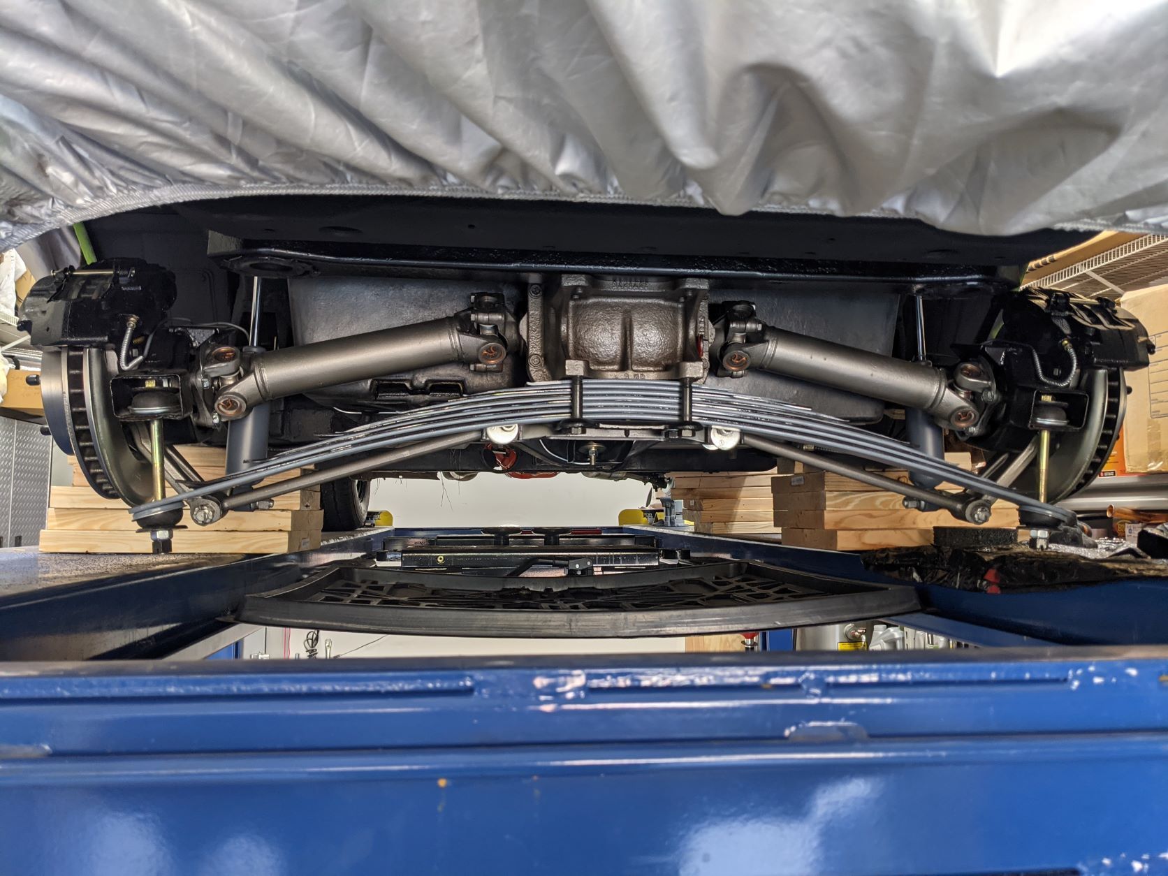

Hey Mike, there is always a way. You can also tuck the exhaust up close, like the pic below after I installed the exhaust. The exhaust is very solid when you get them in there. Still a low point. I used to scrape a bit over large bumps when going a bit fast, but since I refurb'd the suspension and put on the new exhaust, I haven't scraped since. Probably just cursed it.

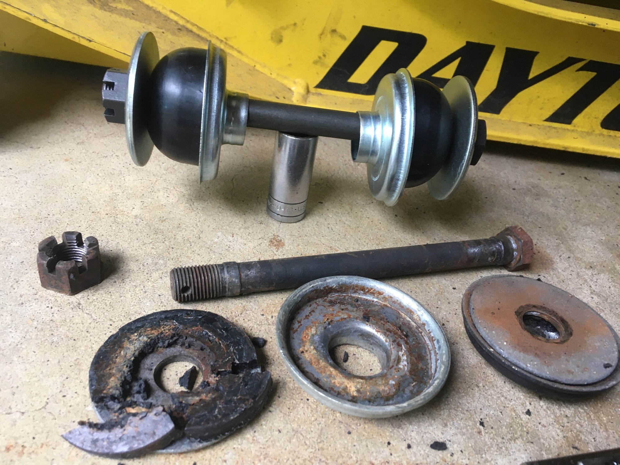

Ok, got back to it today and pulled it apart on the passenger side, reshaped the trailing arm, wire brushed the rust away and repainted. New parts are in on that side and I replaced the factory bolts for the sway bar linkage with new grade 8.

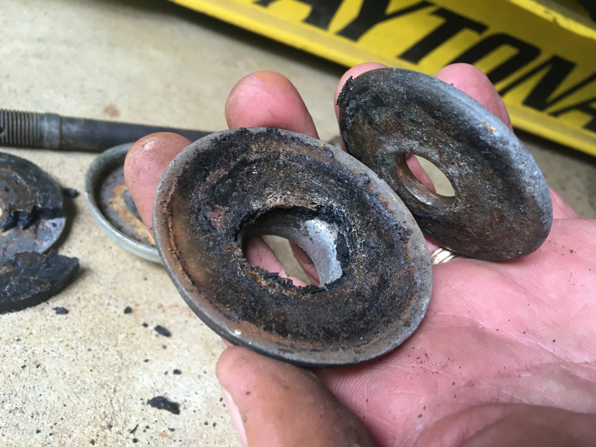

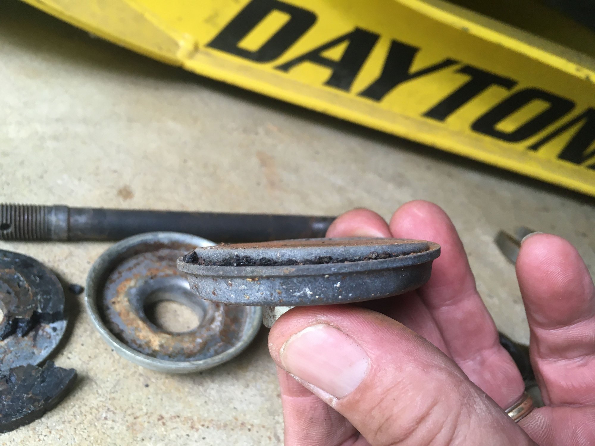

I had assumed the prior owner or the person(s) who “fully restored” the car had installed the spring link bolt with the rubber bushings… nope, they are there.
believe it, there are rubber bushing sandwiched between the washers like a metal Oreo cookie.
1-1/4” of rubber bushing crushed flat to about 1/8” thick ! They have to be factory original.
here it is compared to the replacement.
I am optimistic that this will eliminate the rear sagging issue and make a noticeable handling improvement.
The bolt that’s replacing the original is exactly the same length.
