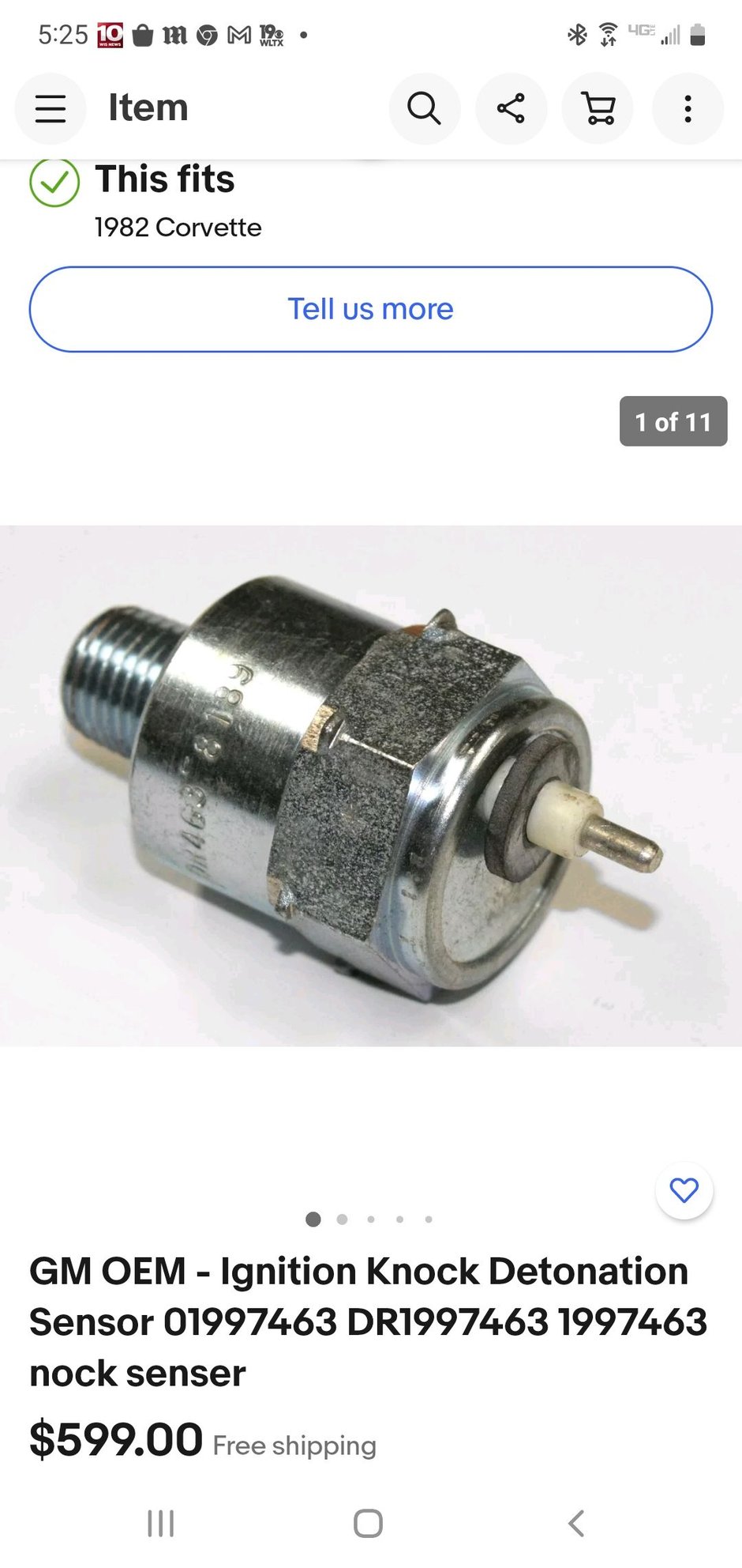

Just for the record, there is this on Ebaymotors . BTW, I'm NOT the seller ! 1 of 2 for sale.

only 600 bucks! what a bargain!

It's $600 because the seller knows that an 82 CFI car is a paper weight without it. This is speculation on my part and I haven't tested it out. I did a little research. It seems that all the OBD 1 GM cars require around an 8 volt signal to the ECM's spark retard circuit. The 8 volts comes from the ESC module. When a knock is detected the ESC module stops sending voltage to the ECM causing the timing to be pulled back. If the ECM doesn't see 8 volts upon startup it sets a code 43. I have the ability to tuned this out on my car but for those of you who still have the original ECM I don't see why a later 5.7 TBI knock sensor and ESC module wouldn't work. Another solution would be a voltage divider circuit consisting of two resistors to provide the 8 volt signal to the ECM and eliminate the knock sensor and ESC module. There are voltage divider calculators online to figure out what resistors you would need. And like I said I haven't tried any of this out, but if someone does try it and it works, please let the seller of that $600 sensor to shove that sensor where the sun don't shine.

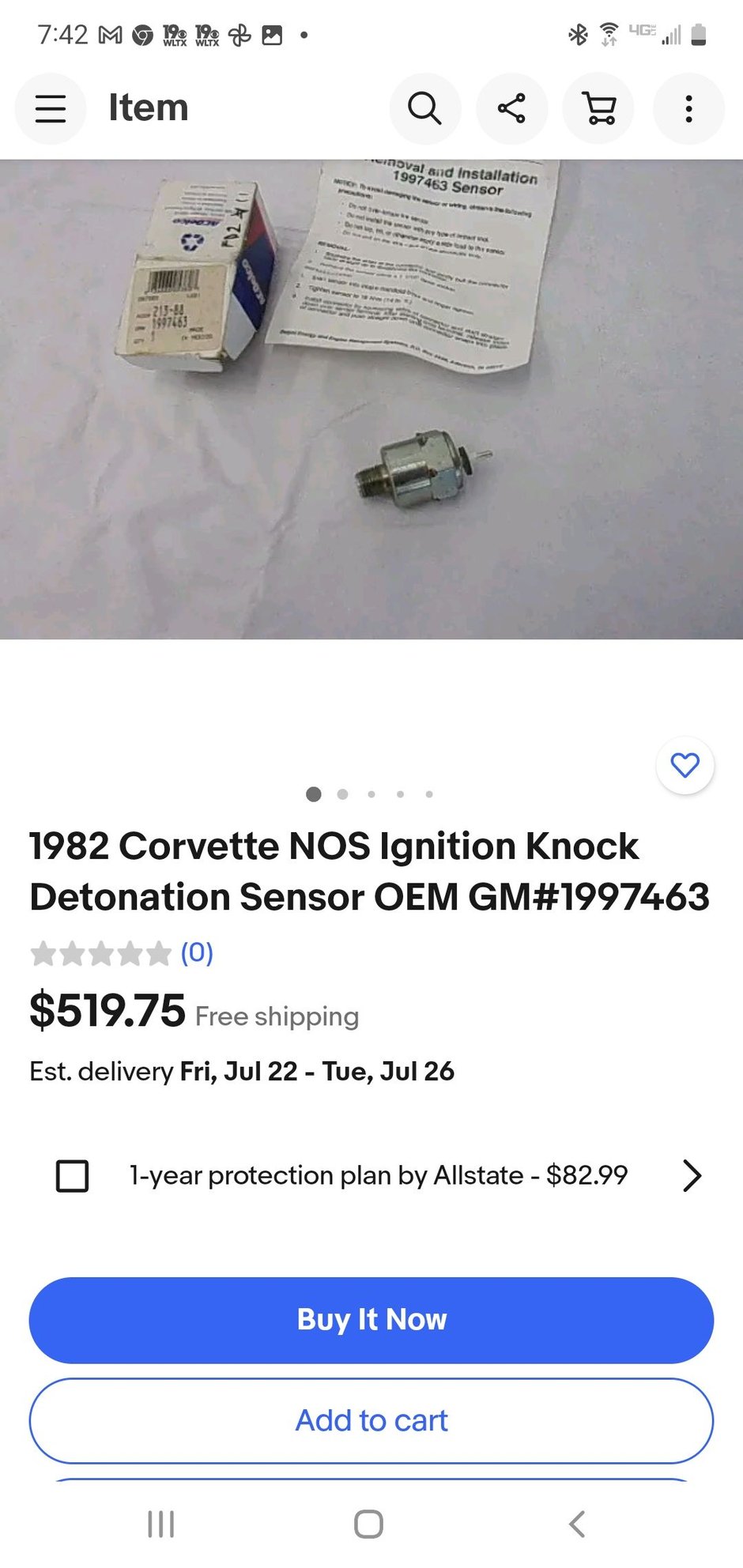

Well, there's always the " bargain " one if that's too much . ( Both of these have been on Ebay for a year or more !) For obvious reasons. But I have never run across an EGR purge valve solenoid. No I'm not payin $600 bucks for one ! ( At least the shipping is free! )
