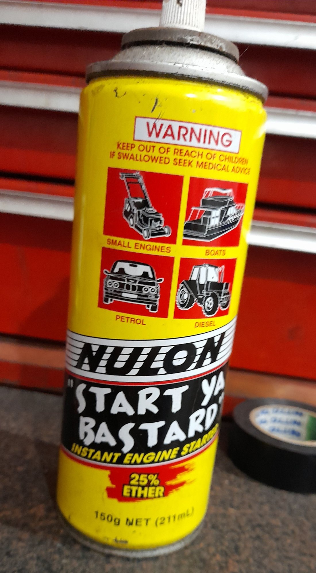

In Australia they sell this stuff.
Me, I think it's terrible stuff. But ya gotta love the name.
Anyway, with airfilter lid removed, you spray a bit of this right into the top of the carb and then turn the starter. If it fires and runs for a couple seconds you know that you have a fuel problem. If not. Most likely an ignition problem.

Originally Posted by 4-vettes
in australia they sell this stuff.
me, i think it's terrible stuff. But ya gotta love the name.
now that made me laugh. Thank you.
