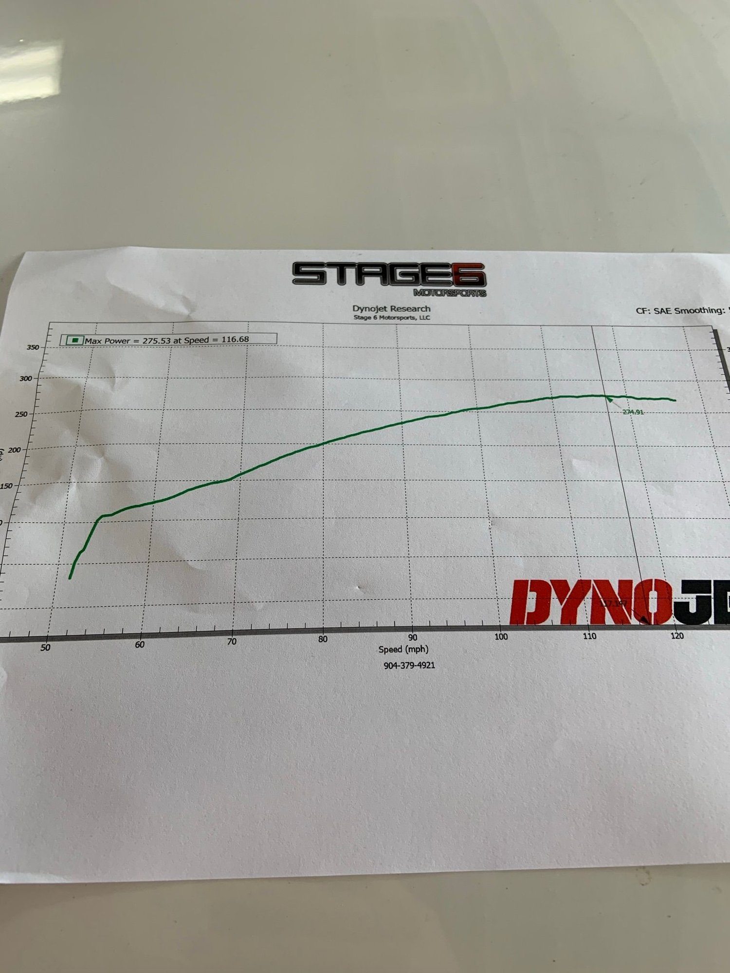

if y’all are curious, this is the dyno graph with the cam installed 4 degrees delayed.
28 degrees total timing
No NOS, this was tuning before spraying.
I never did a pull with 36 total timing, but I’d imagine it’d be an extra 10-15 or so hp.
I know the X axis is in speed not rpm, but for my trans and rear gear 120mph is just over 5k rpm
276rwhp, 326rwtq

110 MPH at the track is pretty strong.

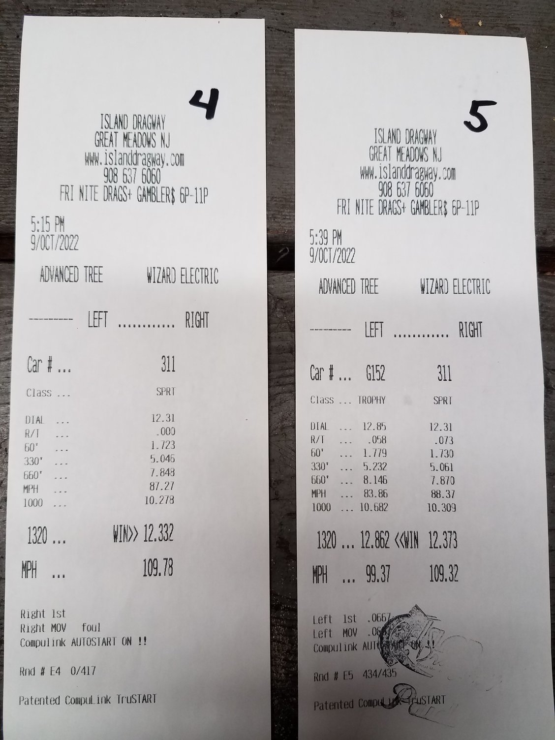

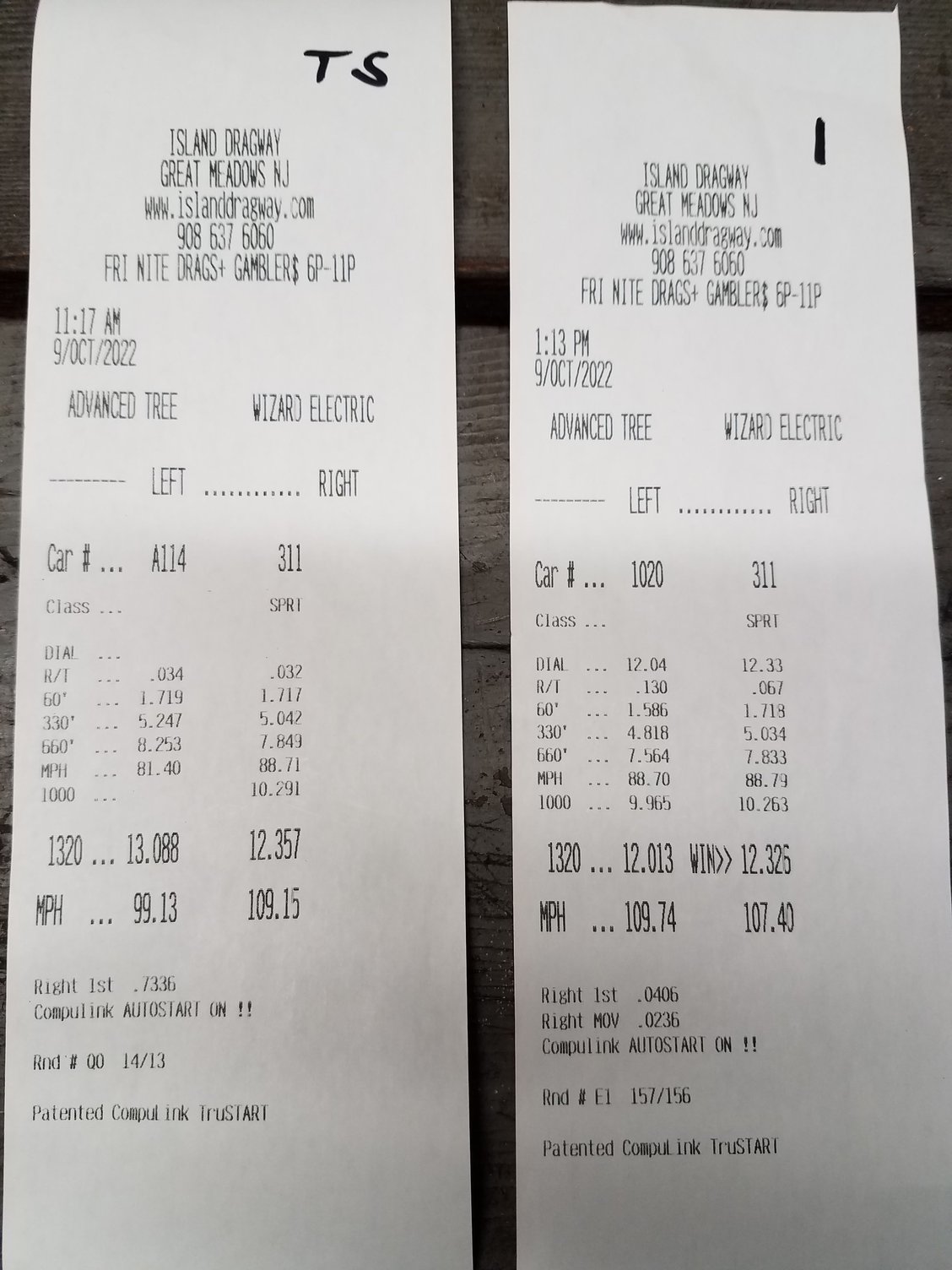

Like you said, those 3.08s are really hurting you. When I changed from 3.08 to 3.73 in my car, it took about 4 tenths off my 1/4 mile ET.
My car runs a little less 1/8 mile MPH than you but 2 tenths quicker ET due to better 60 ft times.
See the 1/8 mile (660 ft) data on time slips below. (Right lane).
Are you using drag radials?

Thanks for that, that’s a really good data point for future plans of the car. You can see it, 2 tenths faster from 60 ft on.
and yes I run Mickey Thompson drag radials, no slipping at launch.

gkull - check my reaction time on Round 4 bye run below. This is foot braking, holding at 1,500 rpm with 3,000 stall converter.

You were probably beast at the slap game in school eh?

That was so long ago I can't remember.
