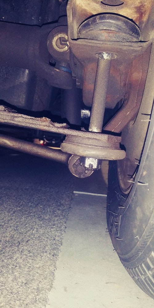

Just to confirm what I'm seeing here and what is in the AIM. I'm missing the metal cup on the bottom, correct? Leaf spring is 'resting' on the rubber bushing.
Old Jul 31, 2022 | 02:43 AM
4-vettes's Avatar
4-vettes
Posts: 13,177
Likes: 7,781
Cruise-In VIII Veteran
Yup, should be a cup like washer that is part of the spring.
been many, many years since I removed the factory steel spring. But even my VB&P Mono spring has cups that are a part of the spring.
When you buy a "Kit" That has the bolts, nuts, washers and rubber bushings. You don't get the ones on the spring. as they are part of the spring. Swagged on as it were.
Interesting problem. Perhaps someone else has better information for you.
