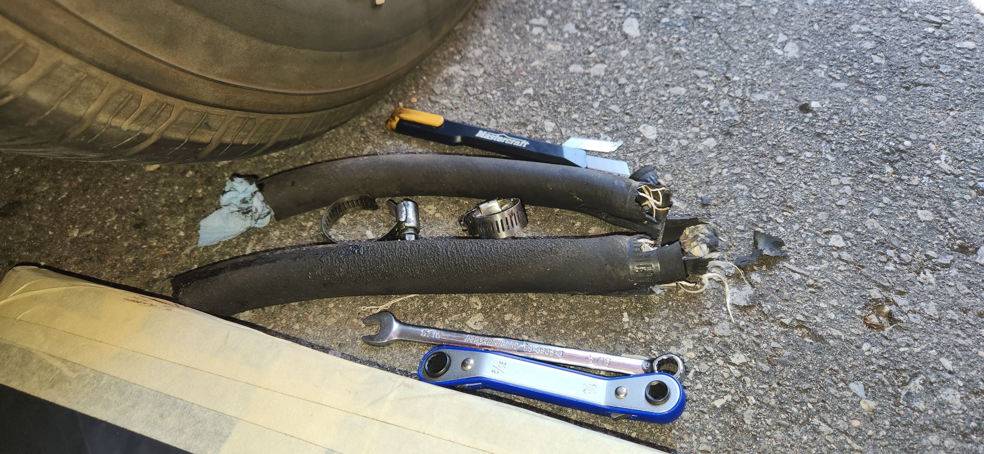

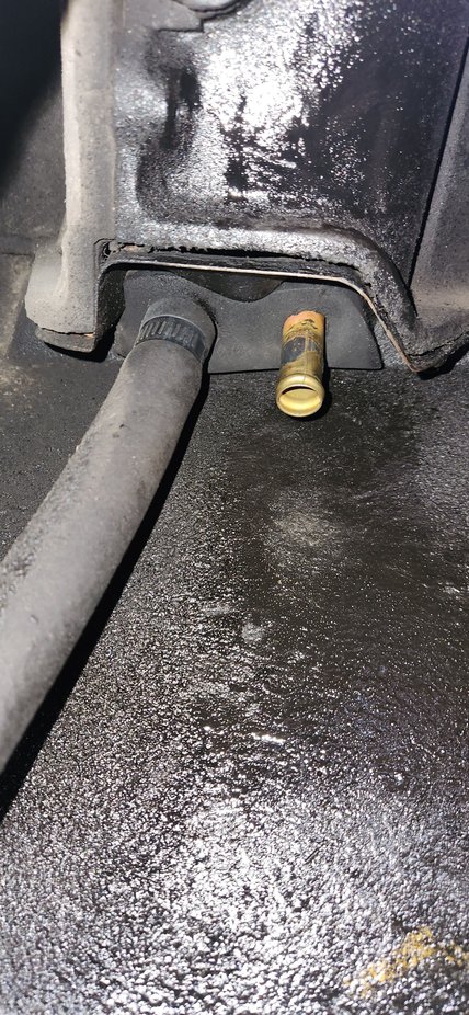

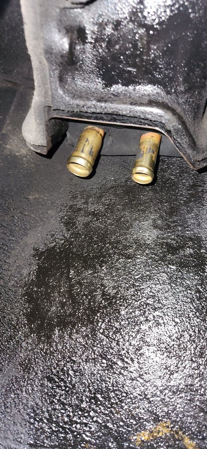

Howdy, rather than post something new vs. old...here's my addition. Pictures tend to put things into perspective. As the title indicates, from my 1981 Vette, 350SBC. My heater core line (from the water pump) gave up the ghost...hot coolant spray everywhere. A pin hole can cause quite the havoc in an engine bay. From what I've read and have confirmed through my own experience...the water pump fitting/hose is 3/4" and the intake is 5/8". I've decided, as most have done, to bypass the whole affair vs. going gung-ho and replacing heater core. Down-time means less time on the road....not a good thing. My heater core had also leaked into the passenger side (foot carpet area), since purchase. The decision was a no-brainer and a good excuse to tackle the task, eh? Once I cut half of the lines leading from the intake and water pump into the heater core....I purged the heater core from any residual coolant using an air compressor. Quit a bit spurted out from the core...basically a mini-radiator. Yes, a messy endeavor. Here's some pics along my journey; mostly the heater core side of the house. The pics (heater core fittings) are as you see them, ride is drivers side, left is passenger. The bigger fitting (left side) is 3/4", smaller fitting (right side) is 5/8". Nothing rocket science, you actually don't need to jack up the vehicle...you can reach into the area from underneath the vehicle, passenger side. Feeling around for the hose clamp, undoing it....cutting/scraping the melted and fuzzed rubber hose from the brass (copper?) fittings with a razor and your done. Cleaned it up with #0000 steel wool and anti-seize helps. The pics show the different sizes of the fittings visually, becomes apparent which goes where if you wish to swap out the core down the road and run the hose lines back to the engine. Completed the job with some rubber plugs from Dorman name brand; a pkg assortment from Canadian Tire; had the 3/4" and 5/8" and a bunch of others conveniently in one pkg. (note: the edging along the core housing, surrounding the fittings is uber-freaking sharp!!).

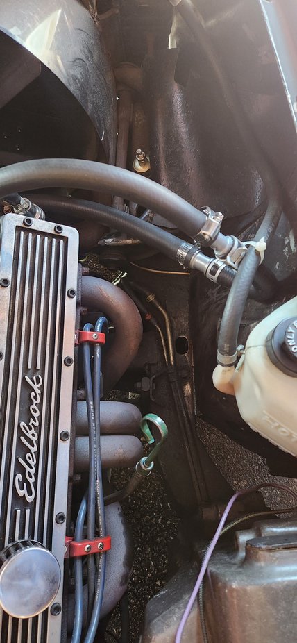

Just get one of these by Gates to connect the hoses together. That's what I did on my 1971 as it had an aluminum radiator and overflow tank that has the pressure cap on it instead of the radiator. I had to do it this way because if I didn't I'd have to eliminate the overflow and install a radiator with a cap on it.
May be different on cars with the cap on the rad. Mine has been on there for 15+ years without issues.

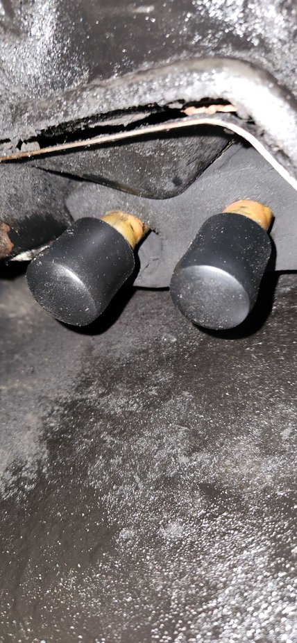

Mine has an elbow hose, but basically same with adaptor fittings. Will end up having silicone caps replace both at intake/pump fittings...clean it up a bit.

I looped my intake to water pump to get me out of a jam but the 1/2 pipe thread looks much better

Plastic has no place in your cooling system*. I tried one of those 5/8 to 3/4 adapters to make the loop. When I removed it in a year or so (to install plugs) it cracked open. Imagine if that had happened on the road. I'll stick to plugs.

So you installed a plug at the intake and the pump?

Absolutely. On an SBC, no bypass is needed. On a big block, YMMV. I think there is a separate bypass between the intake and the pump, but read up on that before you change anything.
If you want heater function in the winter, your best bet is a pair of valves and some insulation. Read @interpon's writeup on that. But even that solution will conduct heat from the engine compartment, simply by having the filled hoses present (insulation helps slow this down).
https://www.corvetteforum.com/forums...e-79-w-ac.html
Plugs are pictured below (the intake plug is being used as another temperature sensor).
