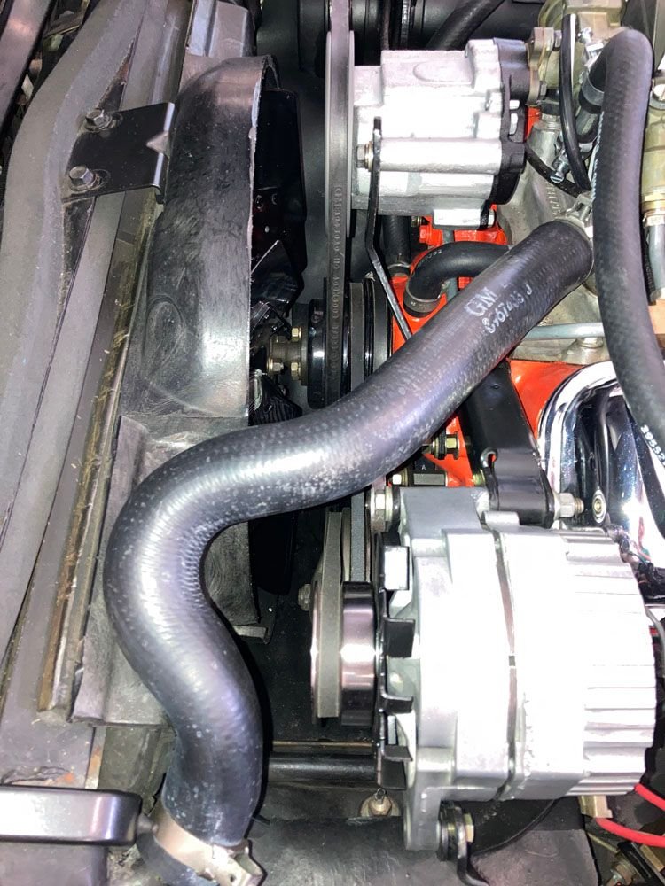

My '69 was built in June of '69 and has PS and AC and the alternator is a 1100882 61amp. This is an original factory unit.
Here is a picture of the layout.

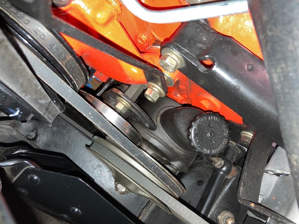

I'm curious about your setup as mine is almost the same, but I think mine may not be correct. First off do you have a close up pic of your power steering pump, Im just trying to figure out if my pump on my 435 69 is correct. Also the bolt that holds your alternator on, the long through bolt, is that the original tapered flanged nut? I have that too, but I wasn't sure that it is original. Thanks

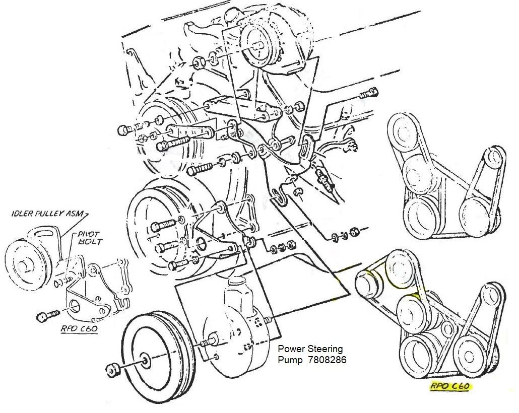

I took several pictures, but it is almost impossible to get a decent picture without everything removed. As far as I remember the alternator bolt is original, but I have had the car 49 years and have done several changes during that time.
Since you don't have A/C you probably will not have the tensioner pulley for the inner belt. You really only need it because of the A/C compressor. According to the AIM the PS pump number is 7808286 although I don't know where you could possibly see the number, you can hardly see the pump. You probably have the upper drawing of the belt configuration. Mine is the lower drawing.

Thanks for the pic, yes mine is not correct, but I have the correct one now as I bought a new pump housing the earlier style as mine had some later style, that may be original, but it never fit right, and yours looks correct as it angles away from the block. One thing I do notice on yours, is it looks like your missing one brace to support your alternator?? If you look at the drawing there is on more Z looking brace, which attaches to that main black upper support off the head

I see the brace that you are talking about, but I don't remember my car ever having that piece attached and I have had it a long time.
Now I am going to have to do some research on it to figure out if it was ever there.
