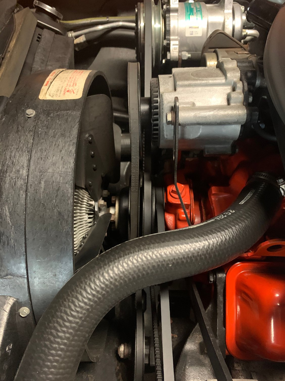

Can I just put a thick washer between the alternator pulley and fan to bump the pulley out alittle bit?

That sounds like a really bad idea. How about washers between the bracket and the head?
Like this.
Belt alignment.
Clearance to power steering pump, approx 1/2 inch.

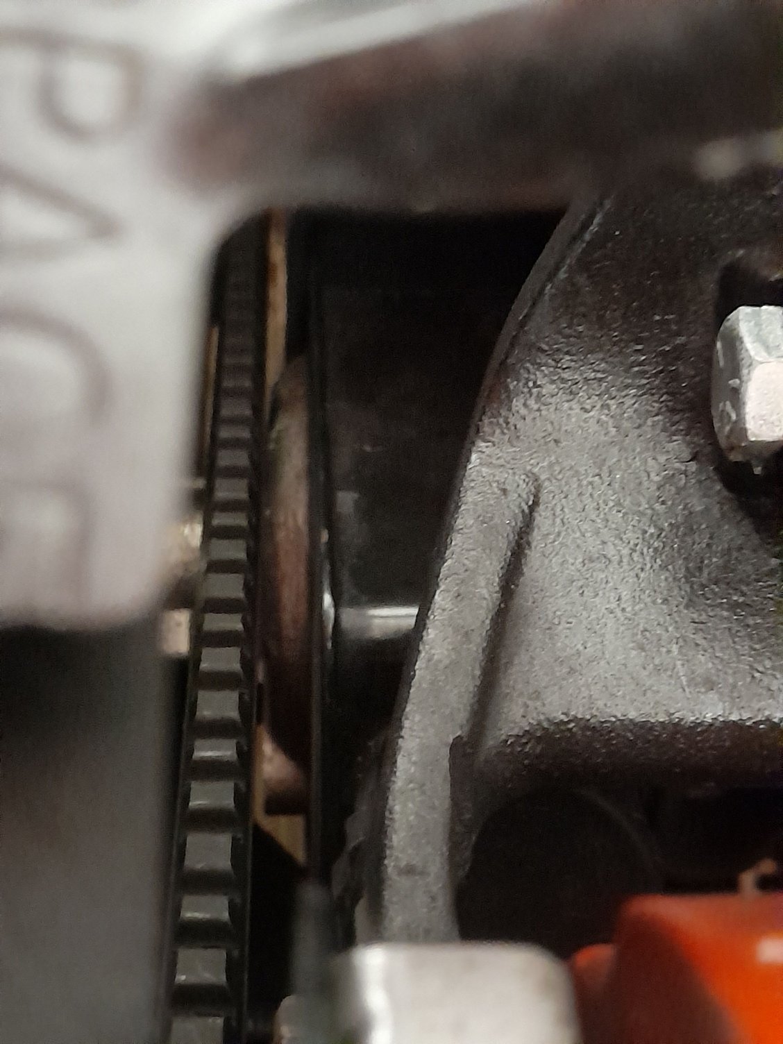

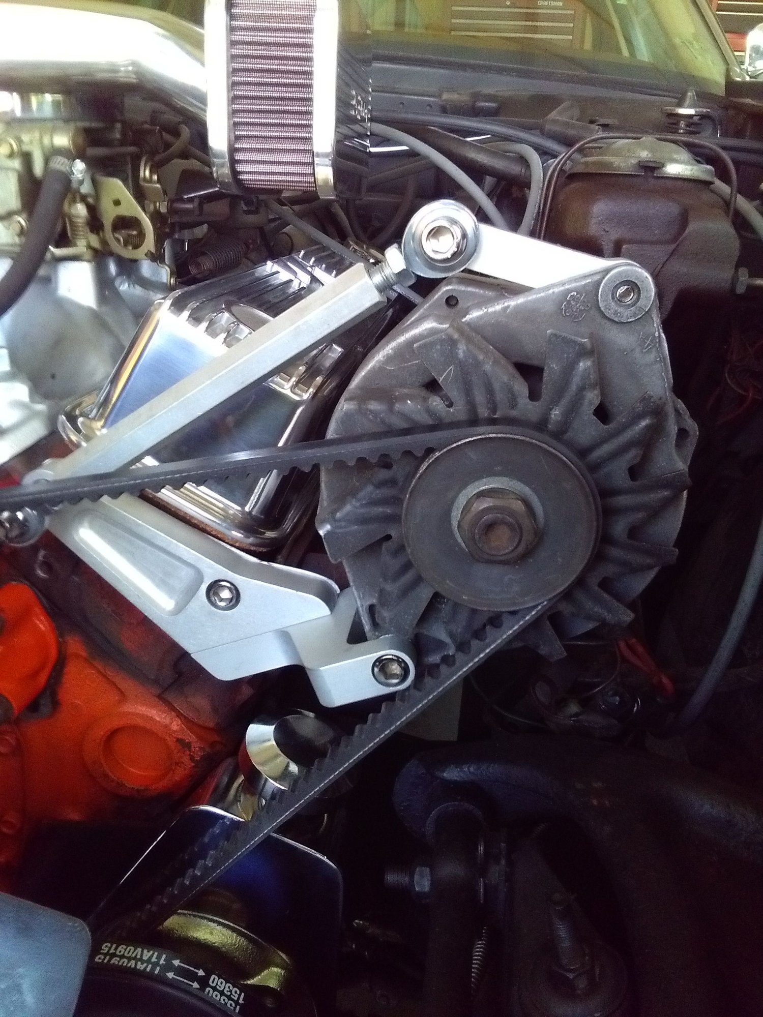

I ended up making a shim for the alternator. Belt only has a paper thin gap between the PS pump. trying a longer belt to tip it back now, but Autozone has to order v belts from the hub store everytime.

Well it's still touching. So maybe the big block pulley. I need almost 1/16" to get off the pump. How much farther will a BB pulley get me?

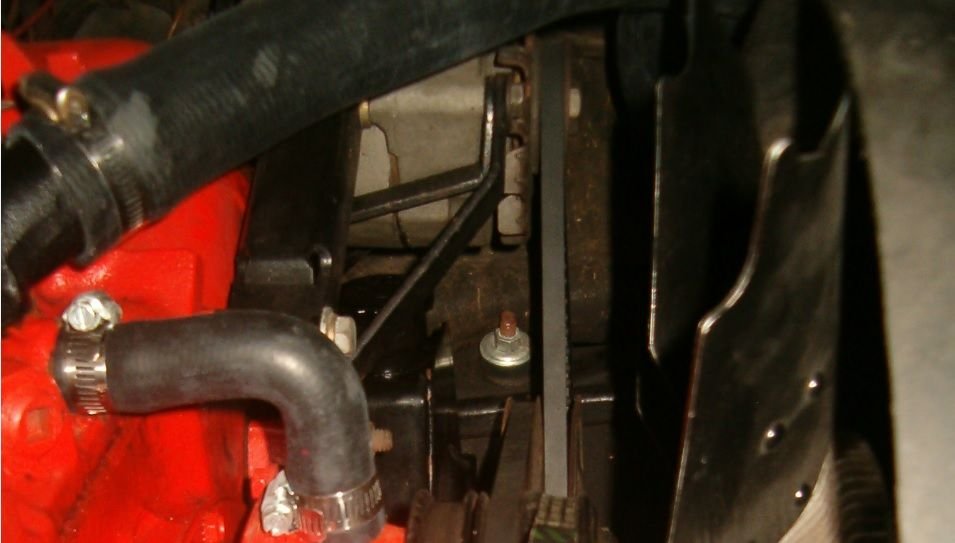

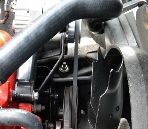

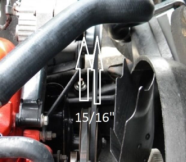

With the big block pulley, it measures 15/16" from the alternator fan to the center of the alternator belt.
Before photo with a pulley like yours:
Correct pulley on my BB alternator:

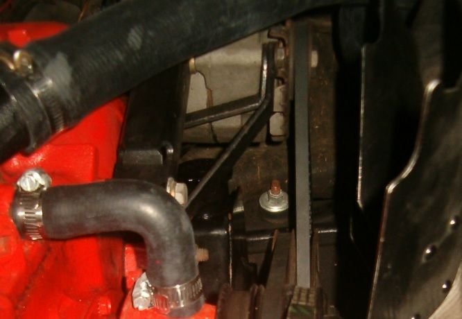

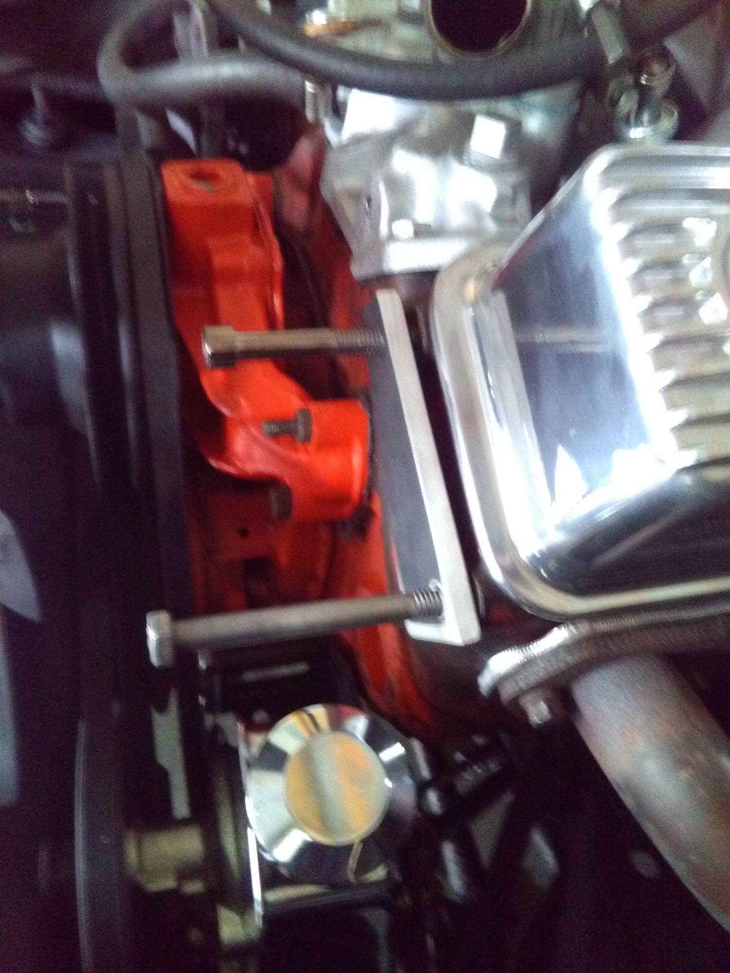

The belts are done! I had to make a THICK shim. The thin ones weren't doing anything. My Dad's a science teacher, he said "take the thickness of the shim, divide it by the number of pulleys touching the belt, and that's how much it will actually move. It worked
