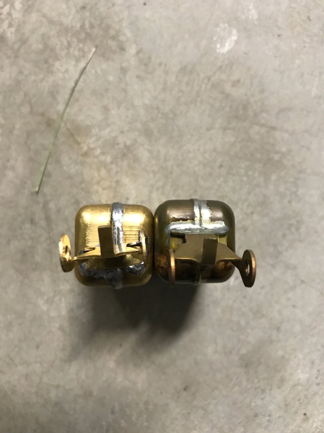

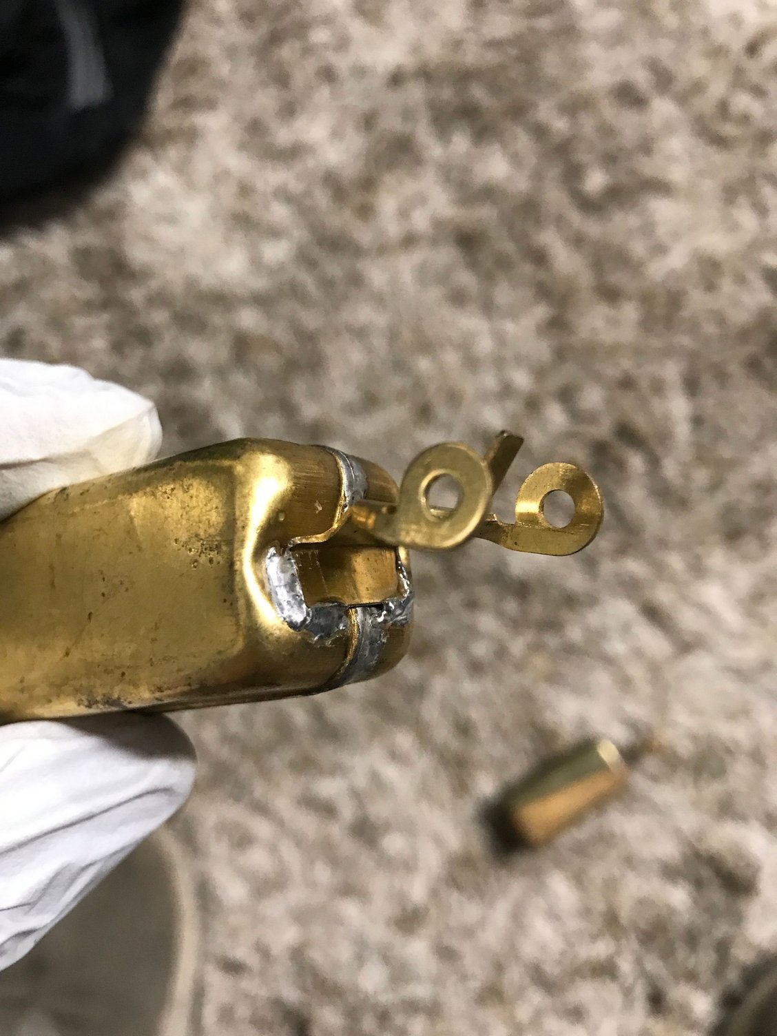

Bad news. I was right about the Chineseum. These floats are horrible, and I cant get them to fit. The solder is garbage. The brass material is very thin, causing it to kink when adjusting float level. The mount is not soldered at the correct spot. The mount is not the correct length, so it does not come in contact with the needle, allowing it to hang. Really bad stuff. Avoid BH motors on amazon for your carb parts.
I mean cmon…
Mount in wrong location
Thin walls kinking
Old Aug 11, 2022 | 02:07 AM

Wow...those are terrible! Can't imagine bending the float just by adjusting float.
I stand corrected on aftermarket....but IF you find decent one's they'd be fine. But I think you had Edelbrock one's ordered too?
