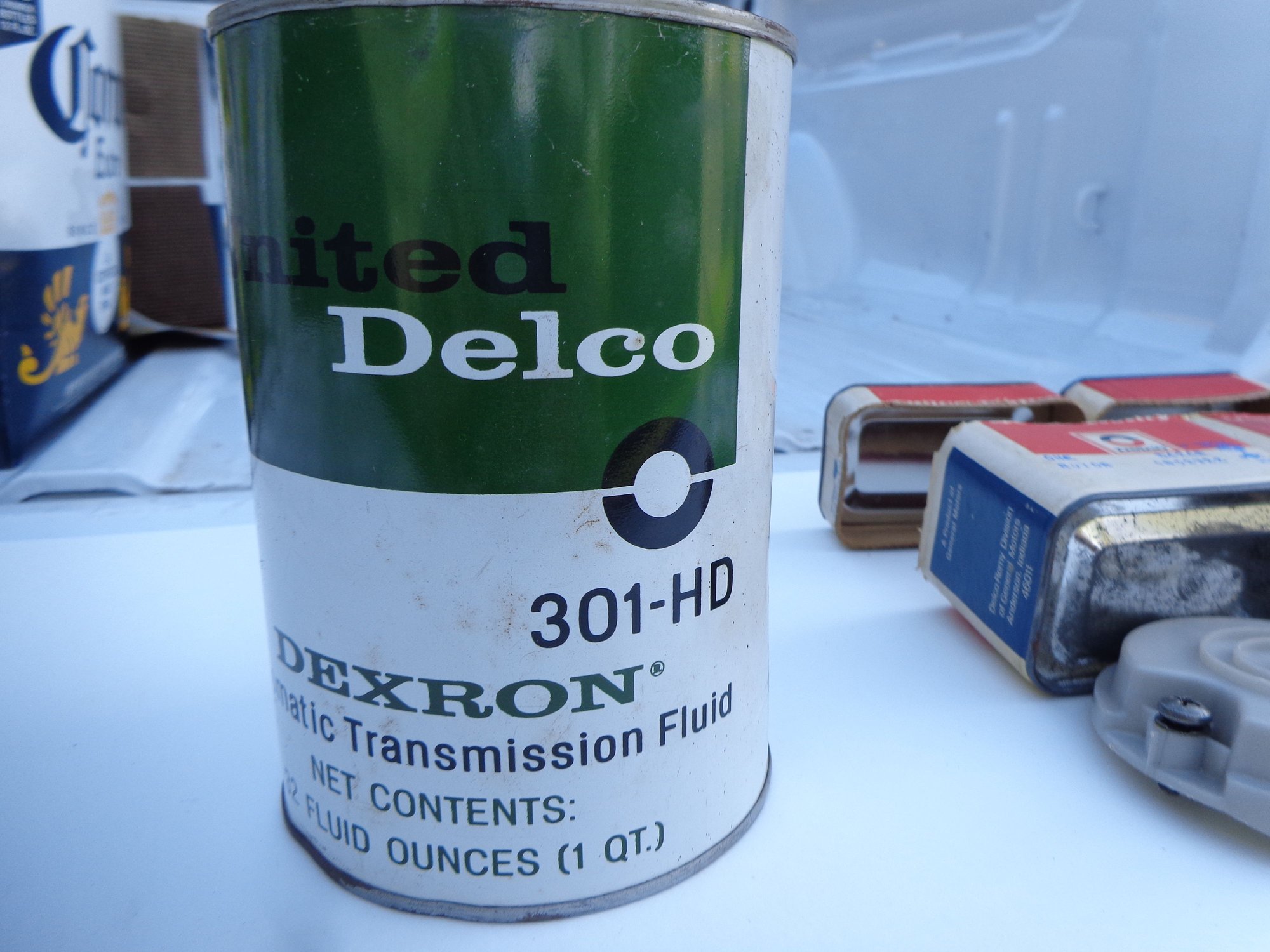

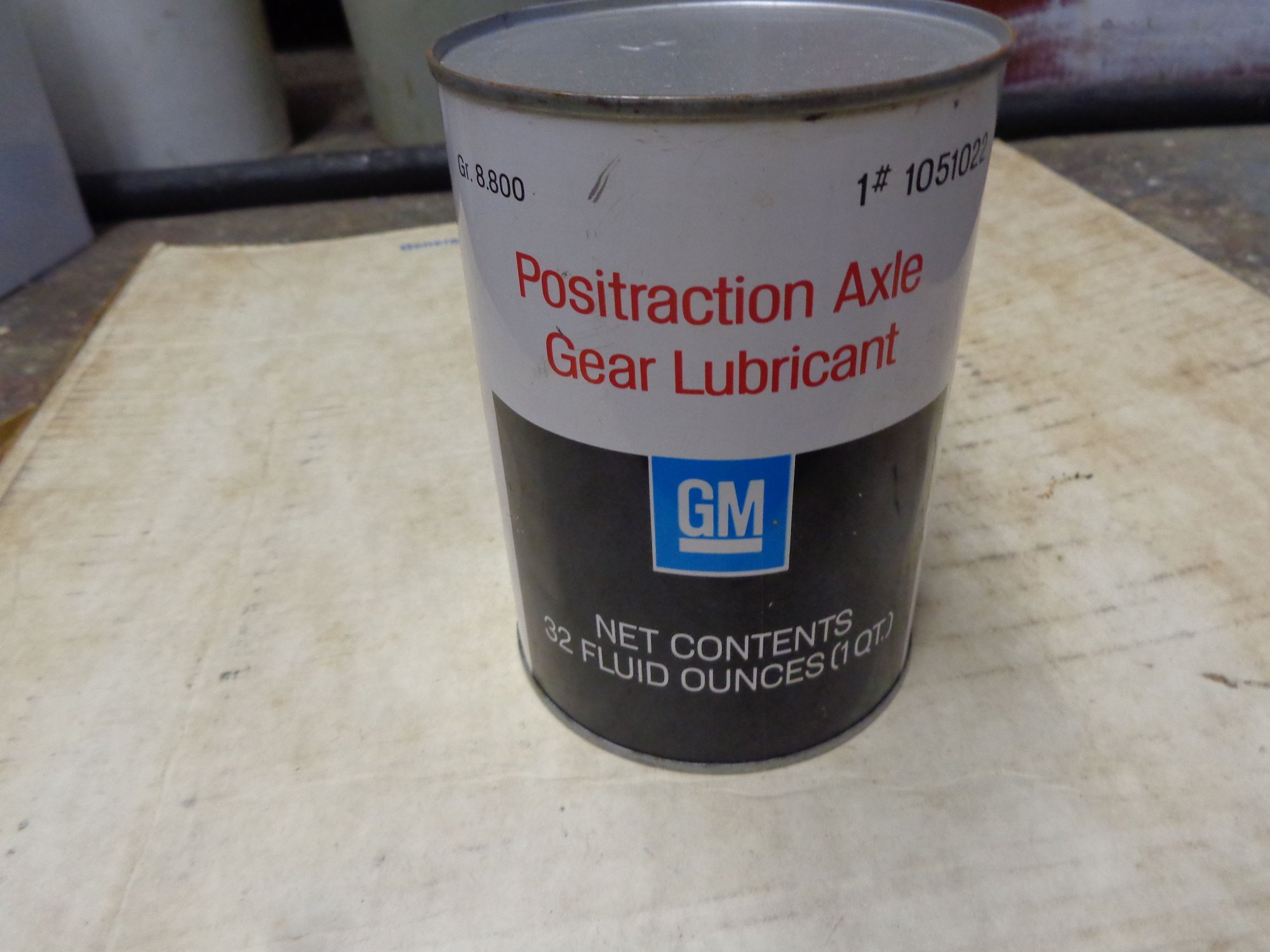

Old vintage oil

Originally Posted by ralphspears
Old vintage oil
Exactly. That's my problem. Not available in this part of the world.
Afraid that pure stuff isn't avail anywhere.
"DexMerc" is the only thing avail.
Brand would be your only choice to be made.
