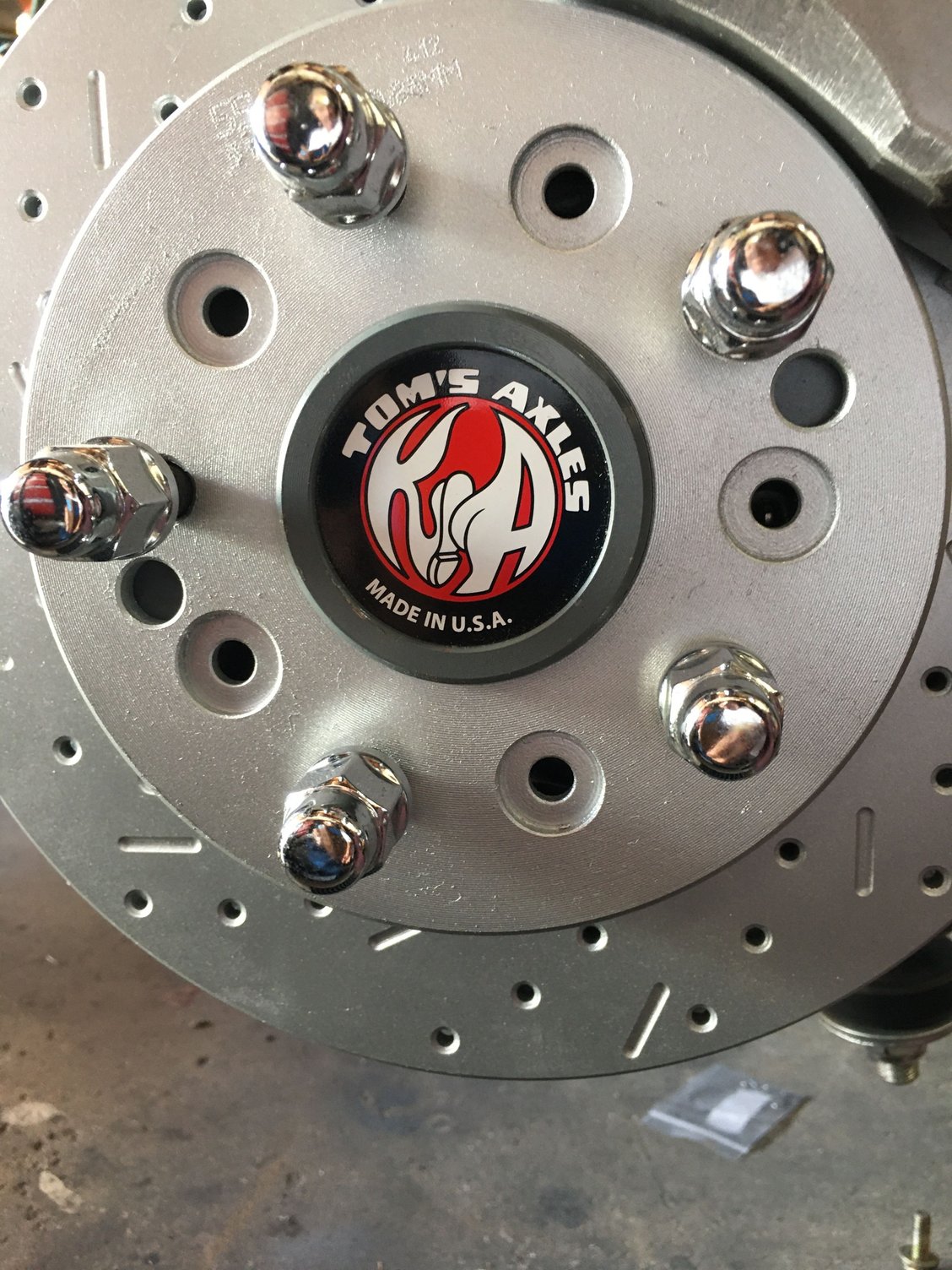

Originally Posted by GTR1999
Jim, you have put your IRS and outer axles through more abuse than most ever will. So, I have no doubt about these axles, never did actually. I have to match a few rotors to the 31's next.
That appears to be a 17? Looks like the rotor isn't indexed correctly on the axle, the adjustment holes are covered.

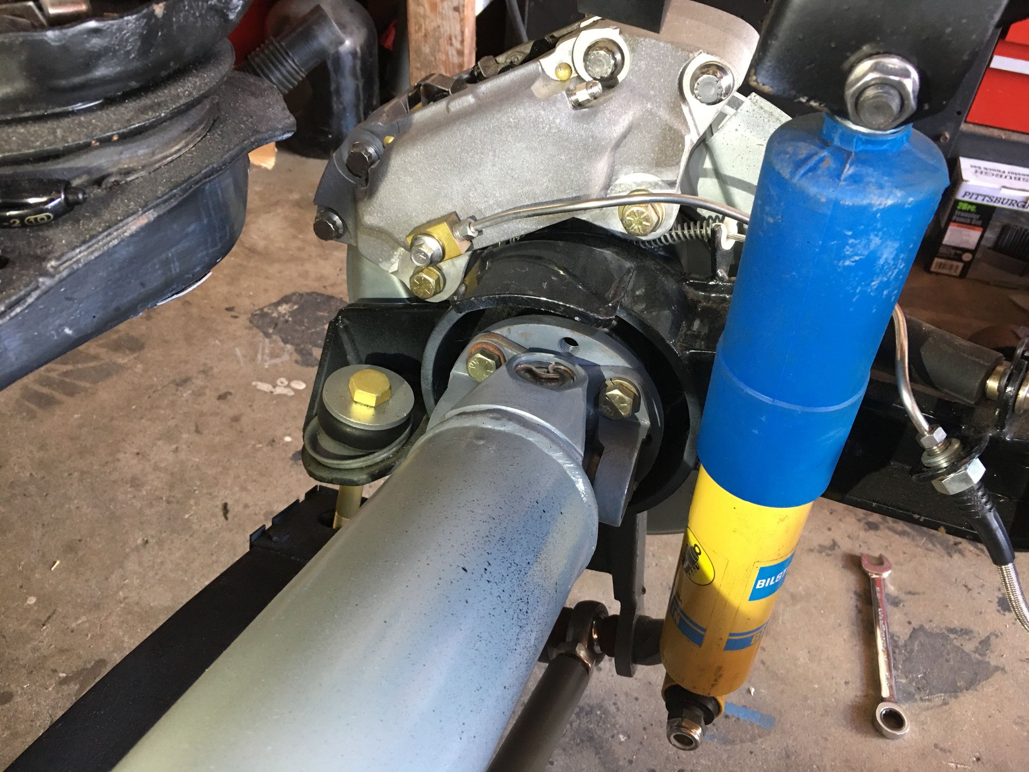

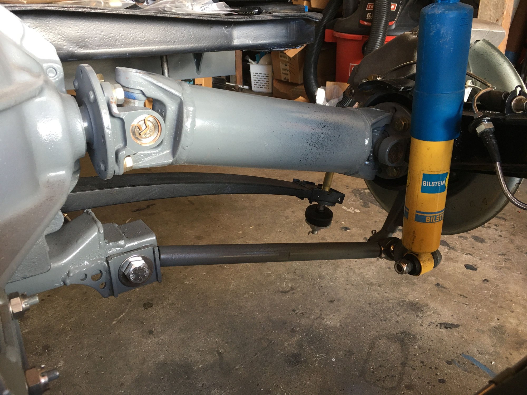

Thanks for the heads up about the adjustment holes. Looks like the caliper has to come off yet another time! Here's a couple of photos of the rear end. There's a lot of Tom's stuff here. The offset trailing arms, the axles, u-joints, everything inside the differential including a "tuned" posi. Notice Tom's dropped strut rod bracket under the diff. You don't see it...but there's a Tom's billet aluminum caliper attachment bracket in lieu of the factory cast iron!!!!. Best I remember, I asked for the 31 spline half axles also. I remember I asked for the 7/16 studs instead of the 1/2 inch studs...for rotor and wheel compatibility.
Notice the stainless steel brake lines to the caliper. Custom made by InLine Tube. I fabricated them in 3/16 inch double flared copper lines.....sent them to InLine, they laser scanned them.....and duplicated them in stainless steel with SS fittings.

About the question as to whether I have 17 or 31 spline half axles. It appears you can tell just by external observation, without disassembling parts. In my photos in post #10, look at the circular flanges on the differential side yokes and the trailing arm spindle flange. Notice the flanges are circular with 8 mounting holes and the flanges themselves have a machined finish. These are similar to the flanges shown in the OP with 31 splines. The factory pieces were castings with only 4 fastening holes. Also, I don't think Tom put his Kick *** logo on the factory OEM 17 spline half axles, the logos went on the real McCoy 31 spline axles custom made for Tom..
Yes, I agree that certainly looks like the 1350 inner flange, makes sense.
A lot of the outer axles were shipped without the decal for years, they are putting them on the inners again.
Tom also had a 17-spline inner with flange, that would look just like the 30-spline inner. I never used one and don't know if they even have them anymore.
Are you running solid joints, I can't see but they have the blue rings?
The parts look good. Some of those are long gone now. One thing, if you have the diff apart is to check the face hardness, Tom didn't harden the tips and the same issue GM had with the stock 70-79 axles is present. I hardened every Tom axle I ever installed.
Thanks for the comments. Yes. I made a mistake there with the U joints....they have the zerk fittings. I didn't know that much about differentials when I bought the components......and still don't know that much! Anyhow, I won't ever run with slicks and the differential is 3.73:1. My 68 differential is also a completely Tom's differential/rear end. but I had it rebuilt like stock. This was long ago when Tom was still assembling differentials in his shop and his employee (partner?) lKenny did all the Corvette work. Kenny had passed away before I bought stuff for the 70. My engine now being built for the 70. Keith Black aluminum block/Brodix al heads. Called crank, rods. I think we settled at 496 cubic inches.
